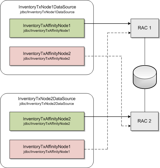

Enabling and Configuring Server Affinity
Server affinity is a performance feature that ensures all database operations performed on data on an Oracle RAC cluster are directed to the same Oracle RAC instance. When server affinity is enabled and configured, the target Oracle RAC instance is determined by data. For example, a business interaction ID; in this scenario, server affinity ensures all operations that operate on a business interaction ID are routed to the same Oracle RAC node, reducing global cache transfers.
Server affinity is also known as data affinity.
By default, UIM uses extended architecture (XA) affinity. Server affinity differs from XA affinity in that XA affinity ensures all database operations performed on an Oracle RAC cluster within the context of a transaction are directed to the same Oracle RAC instance. In XA affinity, the affinity context is established based on the global transaction id, where as in server affinity the affinity context is established based on the data.
In UIM, server affinity is based on EclipseLink partitioning. See the EclipseLink documentation for more information on EclipseLink partitioning:
http://wiki.eclipse.org/EclipseLink/Examples/JPA/Partitioning
To enable and configure server affinity:
  1. Update the following property value in the Domain_Home/UIM/config/affinity-config.properties file to true:
    uim.affinity.configuration.enabled=true
  2. In the WebLogic Server Administration Console, create JDBC Multi Data Sources pointing to each node in the Oracle RAC cluster. For example, if there are two nodes in the Oracle RAC cluster, define two Multi Data Sources by doing the following:
    1. Create two generic data sources pointing to both nodes in the Oracle RAC.
      For example:
      • InventoryTxAffinityNode1
        with JNDI name jdbc/InventoryTxAffinityNode1
      • InventoryTxAffinityNode2
        with JNDI name jdbc/InventoryTxAffinityNode2
    2. Create a Multi Data Source with JNDI name jdbc/InventoryTxNode1DataSource.
    3. Add InventoryTxAffinityNode1 to the Multi Data Source, and select the Algorithm Type of Failover.
      This defines InventoryTxAffinityNode1 as a data source pointing to Node1 while Node1 is up, and which fails over to Node2 if Node1 is down.
    4. Add InventoryTxAffinityNode2 to the Multi Data Source, and select the Algorithm Type of Failover.
      This defines InventoryTxAffinityNode2 as a data source pointing to Node2 while Node2 is up, and which fails over to Node1 if Node2 is down.
    5. Create a Multi Data Source with JNDI name jdbc/InventoryTxNode2DataSource.
    6. Add InventoryTxAffinityNode2 to the Multi Data Source, and select the Algorithm Type of Failover.
    7. Add InventoryTxAffinityNode1 to the Multi Data Source, and select the Algorithm Type of Failover.
    Figure 3-1 shows the server affinity example that step 2 describes. In the figure, the solid arrows indicate the primary path, and the dotted arrows indicate the secondary path.
    Figure 3-1 Service Affinity Example
    Description of Figure 3-1 follows
    Description of "Figure 3-1 Service Affinity Example"
  3. Repeat step 2 for each node that is available. Ensure that every node in the Oracle RAC has a Multi Data Source that is primary.
  4. In the Domain_Home/UIM/config/affinity-config.properties file, configure the data sources that you created by specifying the following (provide name and JNDI name):
