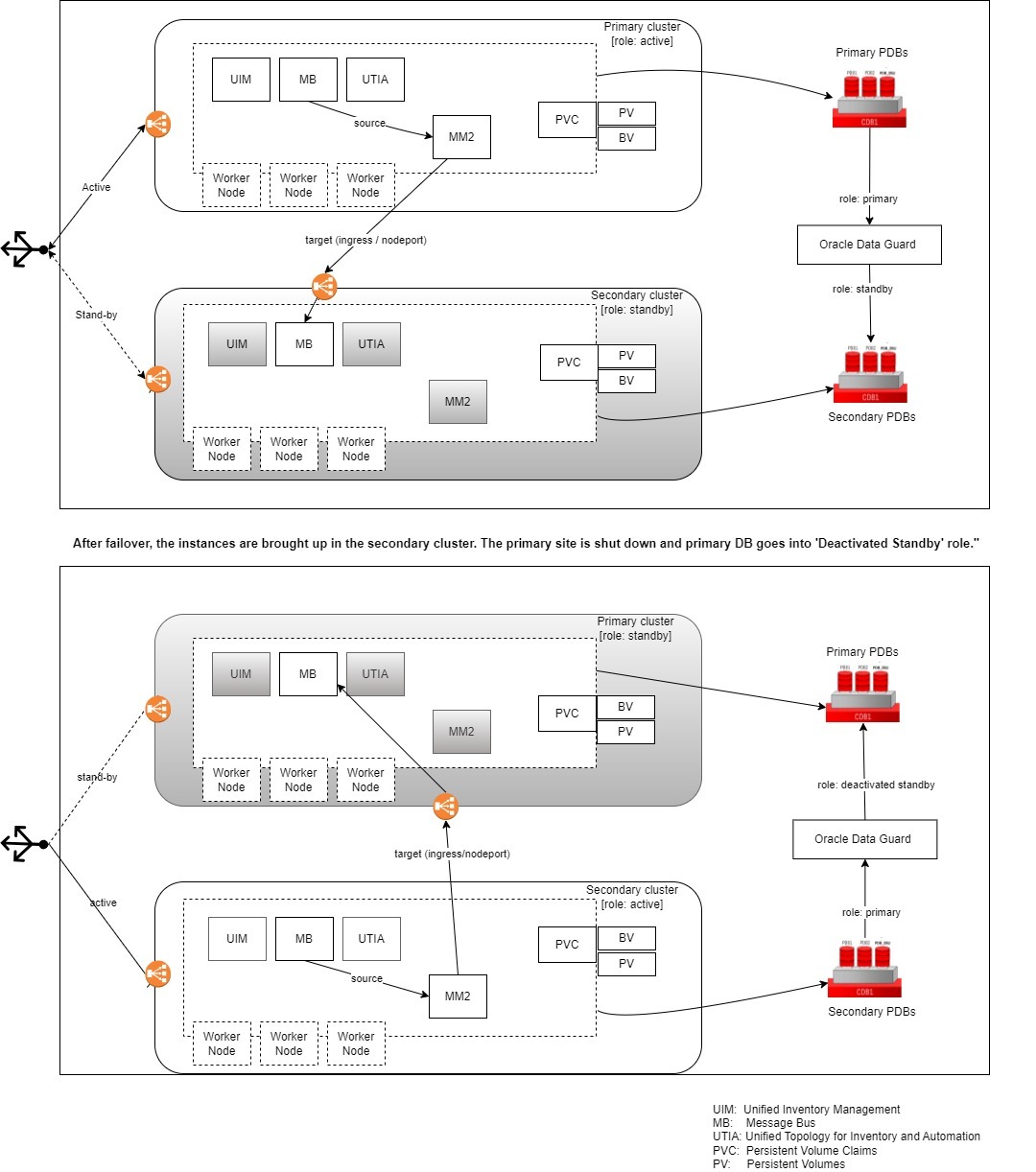

The disaster recovery when the data center completely goes down is maintained with another passive data center.
Figure 15-1 documents the disaster recovery plan for the data center. A parallel passive data center is maintained, where the runtime data is periodically replicated from the active data center to the passive data center. In the event of any catastrophic failures in the primary (or active) data center, the load must be switched to secondary (or passive) data center. Before switching the load to secondary data center, you should shutdown all the services in the primary data center and start all the services in the secondary data center.
Figure 15-1 Disaster Recovery Plan for Data Center

The purpose of a geographically redundant deployment is to provide resiliency in the event of a complete loss of service in the primary site, due to a natural disaster or other unrecoverable failure in the primary UIM site. This resiliency is achieved by creating one or more passive standby sites that can take the load when the primary site becomes unavailable. The role reversal from the standby site to the primary site can be accomplished in any of the following ways:
  • Switchover, in which the operator performs a controlled shutdown of the primary site before activating the standby site. This is primarily intended for planned service interruptions in the primary UIM site. Following a switchover, the former primary site becomes the standby site. The site roles of primary site and standby site can be restored by performing a second switchover operation, which is switchback.
  • Failover, in which the primary site becomes unavailable due to unanticipated reasons and cannot be recovered. The operator then transitions the standby site to the primary role. The primary site that is down cannot act as a standby site and will require reconstruction of the database as a standby database before restoring the site roles.
