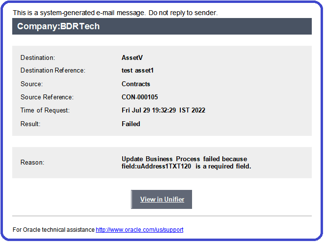

Reverse Auto-Populate Status and Email Messages
The Reverse Auto-populate (RAP) email messages will notify you if the RAP fails, during runtime, and include the following details for better traceability:
The Reverse Auto-population (RAP) option can take place between different elements, if the option is included for those elements.
For Source Business Process and Destination Business Process:
  • Destination Reference with BP Record number (Destination Reference: Where you have the field with a value that can change through RAP.)
  • Source with Source BP Name (Source Reference: Where you have the field with a value that you can change, and as a result, update the Destination through RAP.)
  • Source Reference with Source Record number
For Source Business Process and Destination P6 Activity Sheet:
  • Destination Reference with P6 Activity ID ( uuu_P6ActivityId)
For Source Business Process and Destination Asset:
  • Destination Reference with Asset Name ( uuu_asset_name)
For Source Business Process and Destination Planning:
  • Destination Reference with Planning Item ( uuu_planning_item), if feasible
For Source Business Process and Destination Shell:
  • Destination Reference with Shell
The following is a sample of an RAP email message that displays the changes done when a DE is reverse auto-populated.
