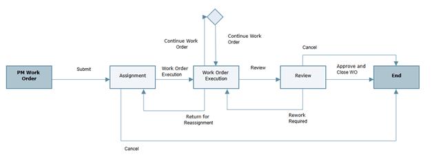

This is an image of the business process workflow.
