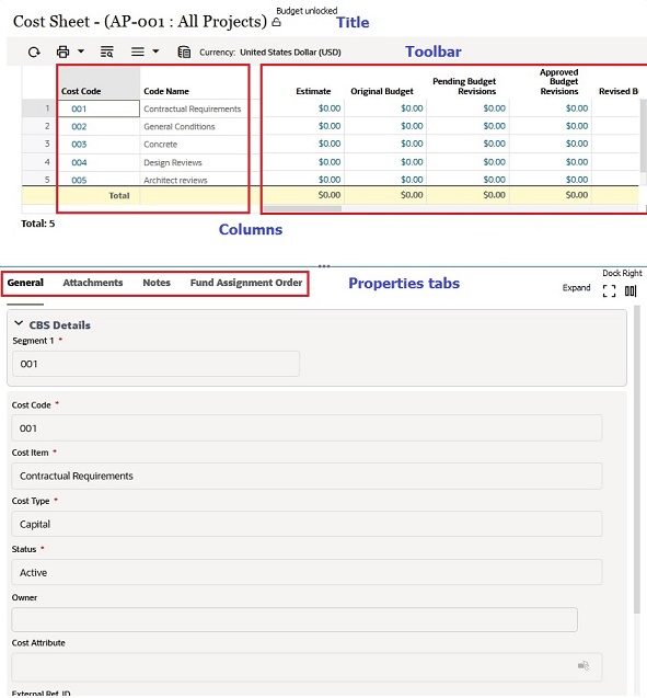

As shown in the image below, the cost sheet window has the following parts:
  • Title
  • Toolbar
  • Columns
  • Properties tabs
This image displays the various parts of the cost sheet window.
  • Title
    Displaying the title of the cost sheet and an icon (open padlock or closed padlock) indicating whether the budget for the project/shell is unlocked or locked.
  • Toolbar
    Enabling to conduct various operations within or with the cost sheet. For more information, see Project or Shell Cost Sheet Toolbar Options.
  • Columns
    There are two sets of columns:
    • Cost Code and Code Name columns
    • Other columns
    For more information, see Project or Shell Cost Sheet Columns.
  • Properties tabs
    The properties tabs provide additional information about each cost code, as well as the associated budget, included in the project/shell cost sheet. With the exception of the Code Name column, each column in the cost sheet has corresponding properties that are shown in a series of tabs, displayed at the lower section of the project/shell cost sheet window. In case you cannot see these properties tabs, select and drag the split screen icon ("") to adjust the size of the lower pane.
    For details about the columns and properties tabs, see Project or Shell Cost Sheet Columns.
