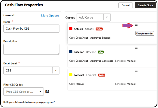

To change the order of the Cash Flow curves, on the cash flow worksheet graph:
  1. Go to the Cash Flow log, and select the cash flow.
  2. Open the gear menu ("") for the selected cash flow and select Properties to open the Cash Flow Properties window.
  3. On the right pane, hover over Drag to reorder ("") for the curve that you want to move, right-click the icon and hold.
  4. Move the curve to where you want it to be displayed on the cash flow worksheet graph and release the hold.
Cash Flow Properties Drag to reorder
Changing the curves order in the Cash Flow Properties window will also change the curve order in the All Curves tab of the cash flow worksheet.
