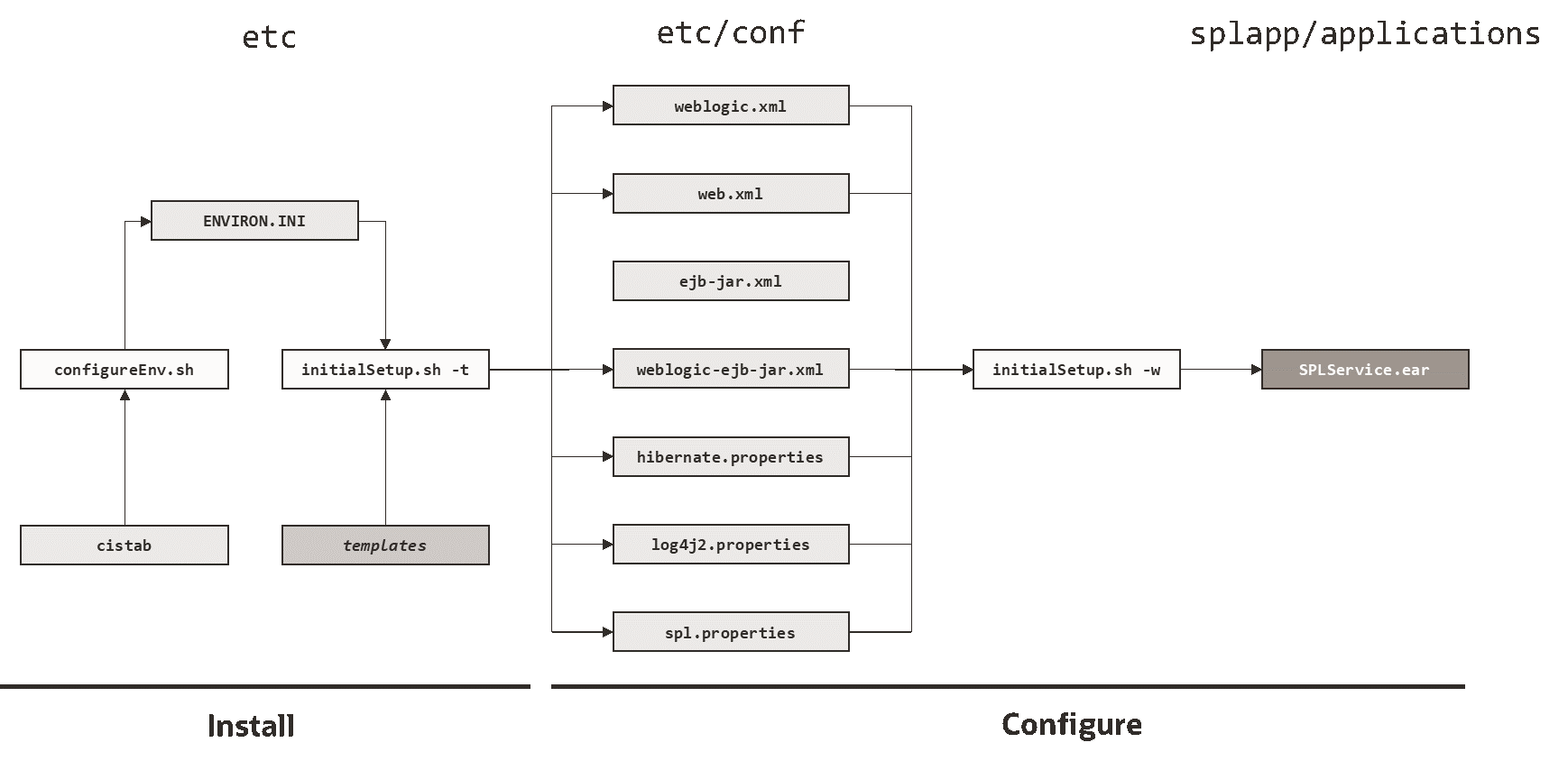

Business Application Server Configuration Process
To configure the business application server during the installation process and post-installation then the following process should be used:Figure that shows the structure of the Business Application Server Configuration Process.
• The configureEnv – Set up Environment Settings utility is used during installation time and can be used post implementation to set parameters in the ENVIRON.INI. If any parameters are derived or set from the ENVIRON.INI (see the Source column in the relevant section) then the ENVIRON.INI utility should be used to maintain them.
Note: The ENVIRON.INI utility should be used to make ANY changes to the ENVIRON.INI. Manual changes to this configuration file are not recommended.
• After the ENVIRON.INI has been set or altered, the settings must be reflected in the relevant configuration files used by the business application server by running the initialSetup (see initialSetup – Maintain Configuration Settings for details):
• log4j2.properties
• spl.properties
• hibernate.properties
• web.xml
• weblogic.xml
• ejb-jar.xml
• weblogic-ejb-jar.xml

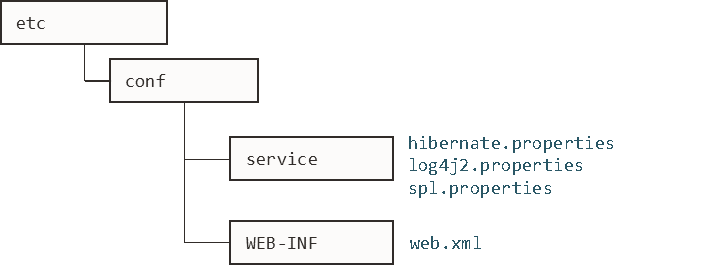

• The utility uses the templates from the templates directory to create substituted copies of these files in a standard location:
Configuration File
Destination
Service Bean
Template: web.xml.template
$SPLEBASE/etc/conf/WEB-INF
Template: spl.properties.service.template
$SPLEBASE/etc/conf/service
$SPLEBASE/splapp/businessapp/properties
Template: log4j2.properties.service.template
Template: hibernate.properties.web.template
Template: ejb-jar.xml.template
$SPLEBASE/splapp/businessapp/config/META-INF
Template: weblogic-ejb-jar.xml.template
The locations of the configuration files can be summarized in the following figure:Figure that shows the structure of the Business Application Server Configuration files.
• At this point you may perform manual changes to the above files to parameters not implemented in the ENVIRON.INI.
Note: Any manual changes are overwritten after running the initialSetup utility unless the change is reflected in the appropriate template (see initialSetup – Maintain Configuration Settings and Implementing Custom Templates for more information). Backups should be made of any changes and then manually reapplied to reinstate all manual changes.
• To reflect configuration changes into the product Business EJB Applications the initialSetup utility, with the –w option, must be executed (see initialSetup – Maintain Configuration Settings). This will build the necessary spl-servicebean-<version>.jar (where <version> is the version of the product used) and the SPLService.ear EAR file (or name set by SPLSERVICEAPP - Name of Business Application Server Application) to be deployed into the Oracle Weblogic Domain. This step is optional if configuration overrides are in use (refer the discussion of allowing the externalization of configuration settings for alternative methods).
• Depending on the architecture used, the initialSetup will generate one or more EAR files.
At this point the product business applications are ready for deployment into the Oracle Weblogic Domain.

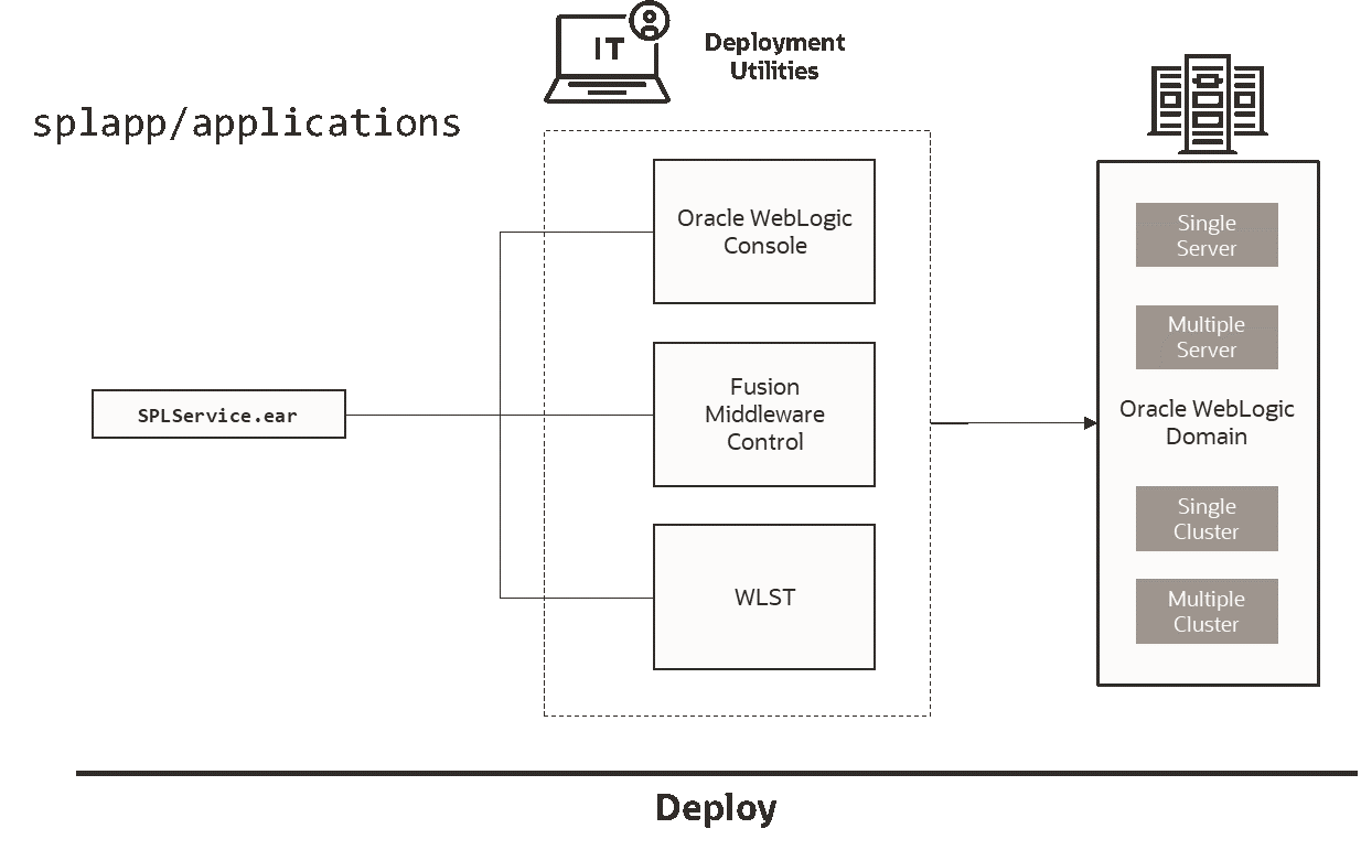

Business Application Server Deployment Process
After the configuration of the business application server is complete (as outlined in Business Application Server Configuration Process), the final step to implement Oracle Utilities Customer to Meter technically is to deploy the product within the JEE Web application server.
There are three methods of deploying the product within the JEE web application server:
• Use the deployment utilities provided on the console of the JEE web application server. The WAR/EAR files that are available under $SPLEBASE/splapp/applications can be manually deployed using the console. Refer to the Installation Guide for specific platform instructions, and to the Administration Guide for the JEE web application server.
• Use the deployment utilities provided on the command line of the JEE Web application server. The WAR/EAR files that are available under $SPLEBASE/splapp/applications can be manually deployed using the JEE Web application server vendor supplied deployment command line utilities. Refer to the Installation Guide for specific platform instructions and the administration guide for the JEE Web application server.
• Several specific utilities for JEE Web Application are provided with the product to deploy the EJB Application to the JEE Web application server. These call the same utilities provided in the previous option but are provided with the product.
This section will outline the latter option.
Several specific utilities from Oracle WebLogic are provided with the product to deploy the Web Application to the domain.Figure that shows the structure of the Business Application Server Deployment process.
• Use the WebLogic console, Fusion Middleware Control or WLST to deploy/redeploy the EAR files.
