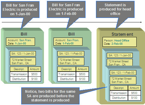

The following diagram illustrates how the above logic could result in multiple bills for a single service agreement being linked to the same statement.
