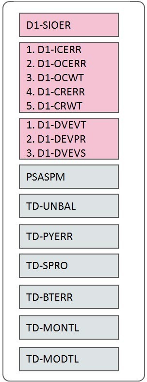

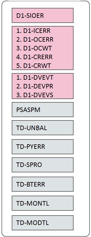

The following diagram illustrates the dependencies between the ongoing or hourly batch processes.
Throughout the course of the day, you will likely run jobs to bring measurement and event data in from the various metering orvhead-end systems and other external systems. To accompany this, you should consider running Ongoing Master Data Sync Processing, Command Processing, and Initial Measurement Processing.
The mnemonics in the boxes refer to the individual batch processes described above. When a box contains multiple processes, these processes must be run sequentially.
No dependencies exist. As you can see, there are no dependencies between the boxes (meaning they may be run in parallel).
