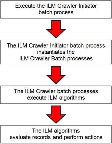

Diagram that shows the different stages of the batch processes, from the execution of the initiator to the actions performed by the ILM algorithms.
The ILM Crawler batch process selects records whose retention period has elapsed and invokes the MO's ILM eligibility algorithm to determine if the record is ready to be archived or not. The ILM eligibility algorithm is responsible for setting the record's ILM archive switch to 'Y' and updating the ILM date, if necessary.
