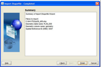

  5. Navigate to Tools and then to Import Shapefile. Click Next.
  6. Click on the shapefile.
  7. Browse to the C:\Spatial directory, select the .shp file, and click Open.
  8. Click Next.
  9. Ensure the Create Predefined Theme box is unchecked, and click Next.
  10. Review the summary information and click Finish. A sample screenshot is shown below.
    Import Shapefile window displays a summary of the import files.

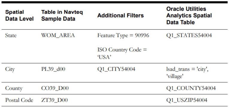

Once the spatial data tables from a third party vendor have been imported into the DWADM schema, the next step is to import the spatial data needed by Oracle Utilities Analytics Warehouse (OUAW) into certain specific tables. This step to import a certain subset of the data into a standardized set of OUAW tables is for decoupling. This decoupling helps the Oracle Analytics Server map reports and other Oracle Analytics Server map configuration to remain oblivious to the variations in the spatial data schema coming from various vendors. This way you do not need to handle the spatial metadata catalog or to modify any of the map reports being delivered out-of-the-box.
Oracle Utilities Analytics Warehouse needs the administrative boundary type of spatial data at four levels: State, City, County and Postal Code. All map reports in OUAW are using one of these levels. Since the spatial data model varies from vendor to vendor, further details provided in this section are based on a sample spatial data from a specific vendor. The following sections describe how to import the data based on a sample spatial data dump provided by HERE Technologies (formerly NAVTEQ).This sample data set contains administrative boundary data for the OHIO city in the US. The sample data set from the Oracle partner can be downloaded from Oracle Spatial Partners Data.
However, the steps can be used with a little variation to set up the spatial data for OUAW for any city from any country. The extent of the changes to be done must be based on the vendor used to purchase the spatial data. Read through the documentation of the spatial data model provided by the vendor to understand the type of data provided and and where to locate it.
The following table provides a simple mapping based on the HERE maps sample data.
A table describing a simple mapping based on the HERE maps sample data.

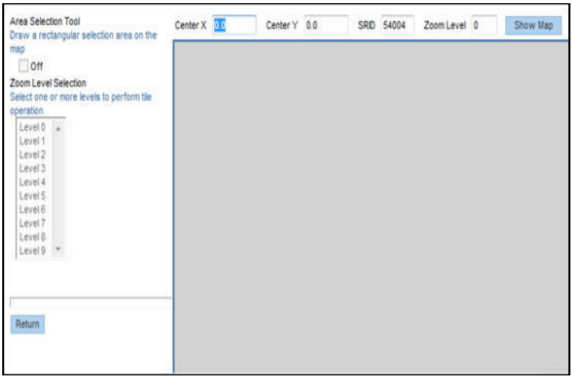

  3. Select the required online map tile and click on View Map/Manage Tiles. The Prefetching wizard opens.
    Wizard screen showing the Area Selection Tool and the Zoom Level Selection options on the left-hand pane, the coordinates bar on the top of the window, and a main area in the middle for the rendering of the map.
  4. Enter the X and Y coordinates of the center of the map, the SRID, and the zoom level. Click on Show Map.
    To prefetch map images, enter the latitude and longitude values. You need to know these values of the center of the location in interest. The SRID is a unique value used to identify the coordinate system used in a GIS application.

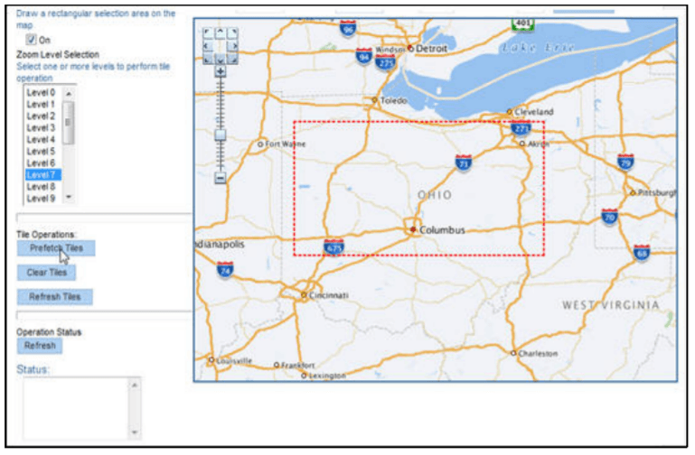

    Example: The following are the X and Y axis for Ohio city.
    Detail of the coordinates bar that appears on the top of the wizard window.
  5. When you see the map, turn on Area Selection and select the area on the map for which you want to prefetch the tiles.
  6. Select one or more zoom-levels for which you want to prefetch the tiles.

  5. Under Tile Operations, click on Prefetch Tiles. Here is a snapshot of the area selection and the tile operation.
    Example of a map displaying in the wizard.
This process takes some time, depending upon the hardware configuration of the system and the amount of data to be prefetched. To check the current status of the operation, click on Refresh under Operation Status. The status will change to Finished when the operation is done.
