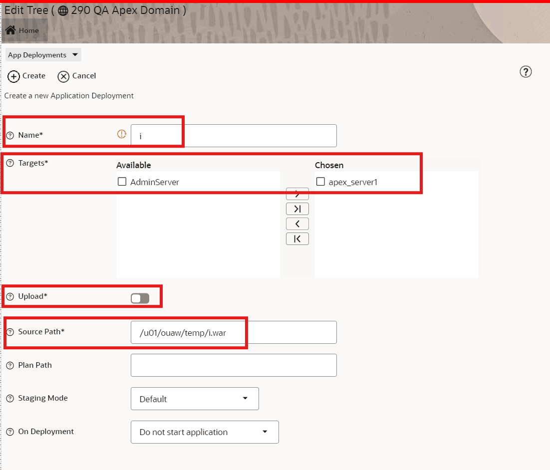

  4. Navigate to the ORDS directory. You will find the ords.war.
    Example: cd </u01/ouaw/ords>
  5. To create i.war, complete these steps.
    1. Create a directory which is the source for your web archive. In that directory, create a WEB-INF directory with the following web.xml and weblogic.xml.
      mkdir -p /u01/ouaw/temp/WEB-INF
    2. Create web.xml and weblogic.xml inside WEB-INF folder.
      cd /u01/ouaw/temp/WEB-INF
      web.xml
      <?xml version="1.0" encoding="UTF-8"?>
      <!DOCTYPE web-app PUBLIC
      "-//Sun Microsystems, Inc.//DTD Web Application 2.3//EN"
      "http://java.sun.com/j2ee/dtds/web-app_2_3.dtd">
      <web-app>
      <!-- This Web-App leverages the alternate doc-root functionality in WebLogic to serve static content
      For WebLogic refer to the weblogic.xml file in this folder
      </web-app>
      weblogic.xml
      <weblogic-web-app xmlns="http://www.bea.com/ns/weblogic/weblogic-web-app">
      <!-- This element specifies the context path the static resources are served from -->
      <context-root>/i</context-root>
      <virtual-directory-mapping>
          <!-- This element specifies the location on disk where the static resources are located -->
          <local-path>/scratch/apex/apex_21.2_en/images</local-path>
          <url-pattern>/*</url-pattern>
      </virtual-directory-mapping>
      </weblogic-web-app>
      <local-path> is the path of apex image folder.
    3. To create i.war with the web.xml and weblogic.xml files, execute the following command:
      export JAVA_HOME=</u01/ouaw/java17>
      export PATH=$JAVA_HOME/bin:$PATH
      jar cMf i.war WEB-INF/web.xml WEB-INF/weblogic.xml
    For more information, refer to Deploying Oracle REST Data Services.

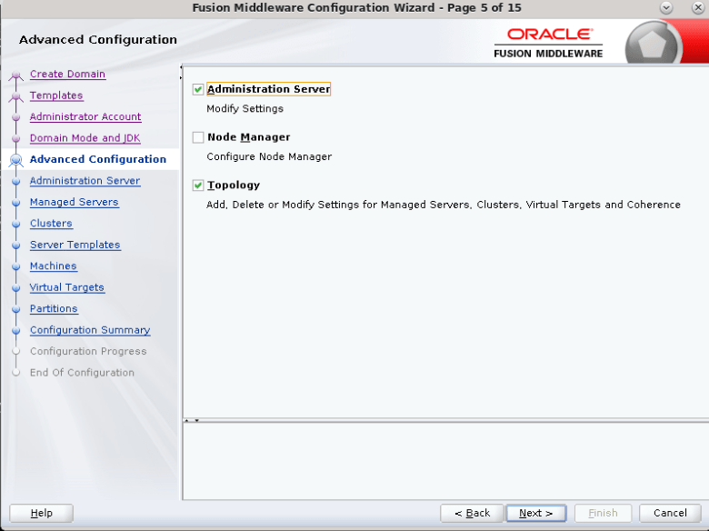

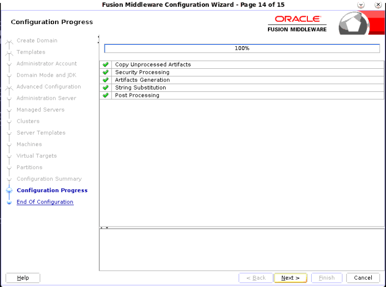

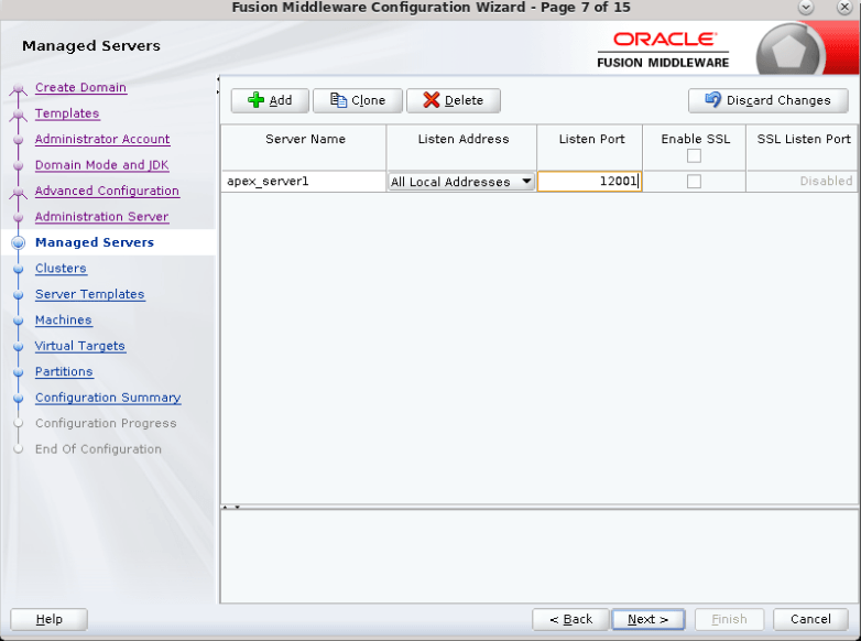

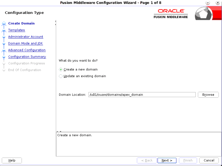

  3. Execute the following command to launch the Oracle Fusion Middleware Configuration Wizard for <apex_domain> configuration:
    ./config.sh
  4. On the Create Domain screen, select Create a new domain, and click Next.
    Create Domain screen gives the user an option for creating a new domain, and another one for updating an existing one. Below the options list, there's a field to define the domain location.
    Field Name and Description Value
    Domain Location: Enter the location where the apex_domain can be created. Example: </u01/ouaw/domains/apex_domain>
  5. On the Templates page, below the Available Templates list, select Basic WebLogic Server Domain and click Next.
    Templates screen showing the list of available templates.There's a text field for filtering results.

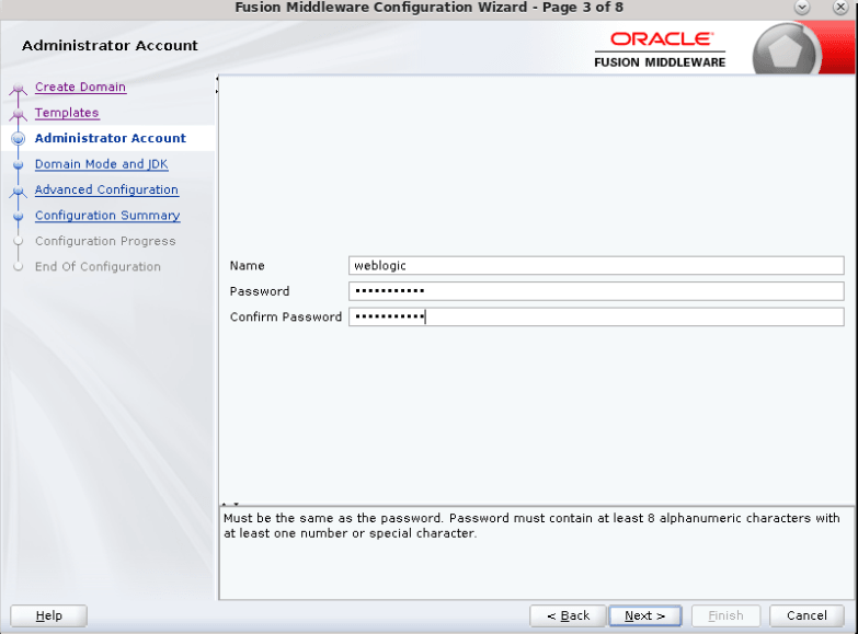

  6. On the Administrator Account page, enter the following values and click Next.
    Administrator Account screen, where the user is to enter his user name, and set a password.
    Name: Enter the user name. weblogic
    Password: Enter the WebLogic user password. <weblogic user password>
    Confirm Password: Enter the same WebLogic user password as above. <weblogic user password>

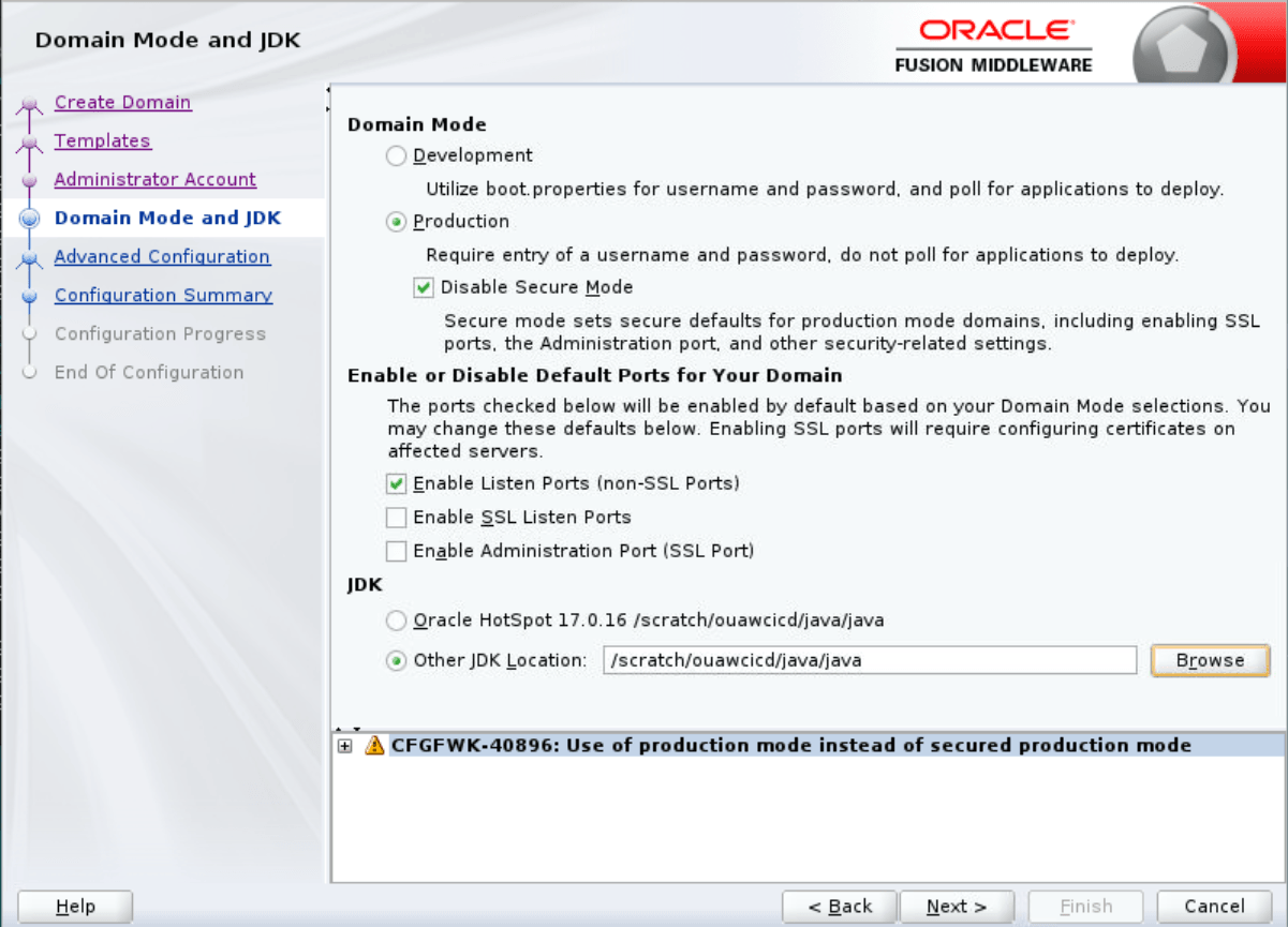

  7. On the Domain Mode and JDK page, select the options as per your requirement, and click Next. The image below shows the option to configure NON SSL Domain.
    Select Production option under Domain Mode, and Other JDK Location under JDK.
    Domain Mode: Select the appropriate domain mode. Production mode
    Disable Secure Mode: Check as per your requirement
    Enable or Disable Default Ports for Your Domain: Check as per your requirement
    JDK: Select the JDK location using a browser. Example: <JAVA HOME>
  8. On the Advanced Configuration page, select Administration Server and Topology.
    Advanced Configuration screen shows three options with their respective checkboxes.

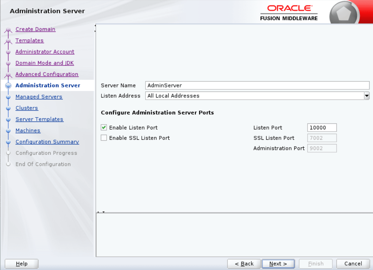

  9. On the Administration Server page, enter the values as in the table below, and click Next.
    Administration Server screen shows the three fields to be populated by the user in accordance with the table.x
    Server Name: Enter the Admin server name. AdminServer
    Listen Address: Enter the listen address. All local addresses
    Enable Listen Port: For NON-SSL Select the checkbox as per your requirement
    Enable SSL Listen Port: For SSL Select the checkbox as per your requirement
    Listen Port: Enter the listen port number.
    Example: <12000>
    NON-SSL Port
    SSL Listen Port: Enter the SSL listen port number. For SSL Domain
  10. On the Managed Servers page, enter the following values to add a managed server. Click Next.
    Managed Servers screen displays a five column table containing the name, the listen address, and the listen port; the fourth column has a checkbox for enabling SSL, and the fifth column shows the SSL Listen Port status.
    Server Name: Enter the managed server name. Example: <apex_server1>
    Listen Address: Enter the listen address. All local addresses.
    Listen Port: Enter the listen port number. Example: <12001>

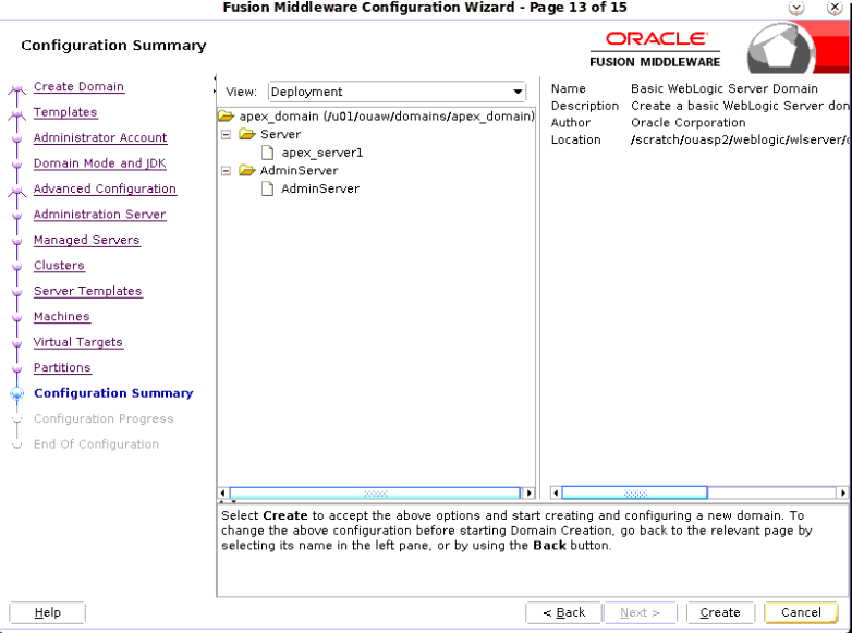

  11. Click Next on the Clusters, Server Templates, Machines, Virtual Targets and Partitions pages respectively. There is nothing to add or change to these pages.
  12. On the Configuration Summary page, click Create .
    Configuration Summary screen displays details on the configuration, such as the folder structures.
  13. On the Configuration Progress page, wait until the progress bar is 100% complete and then click Next.
    This screen shows the configuration's progress percentage.

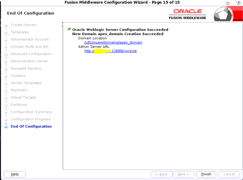

  14. On the End Of Configuration page, you will find the domain path and the administration server URL that will be used in the following steps. Click Finish.
    This screen shows the configuration status, the domain location, and the administration server URL.

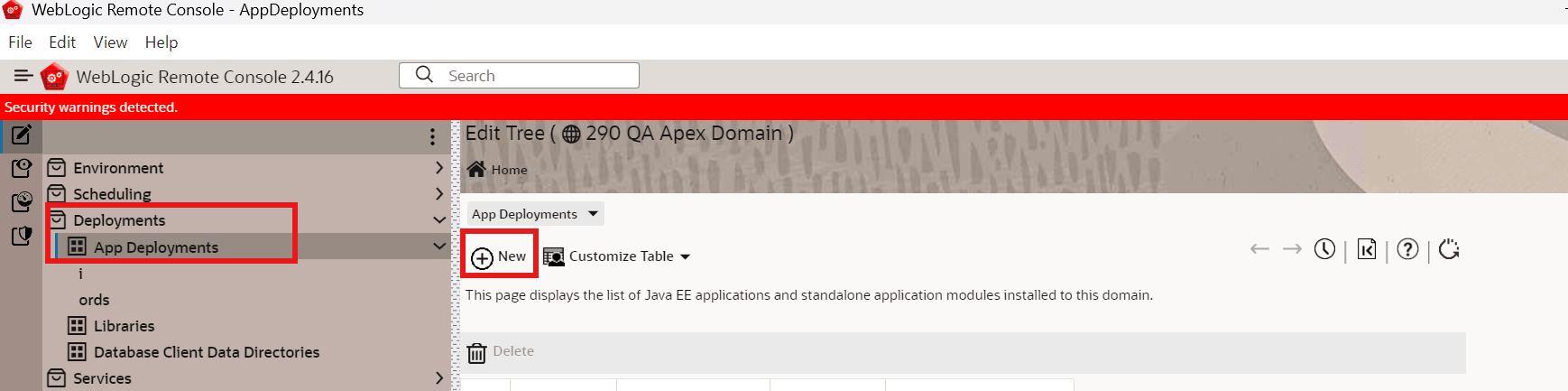

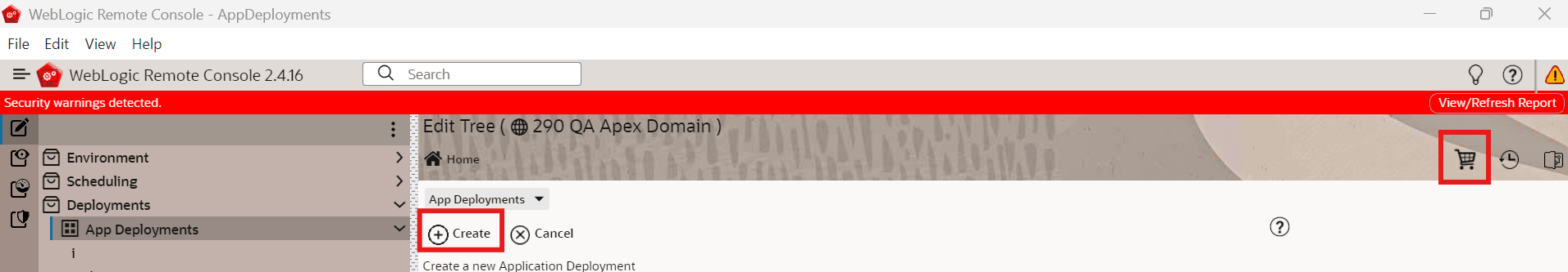

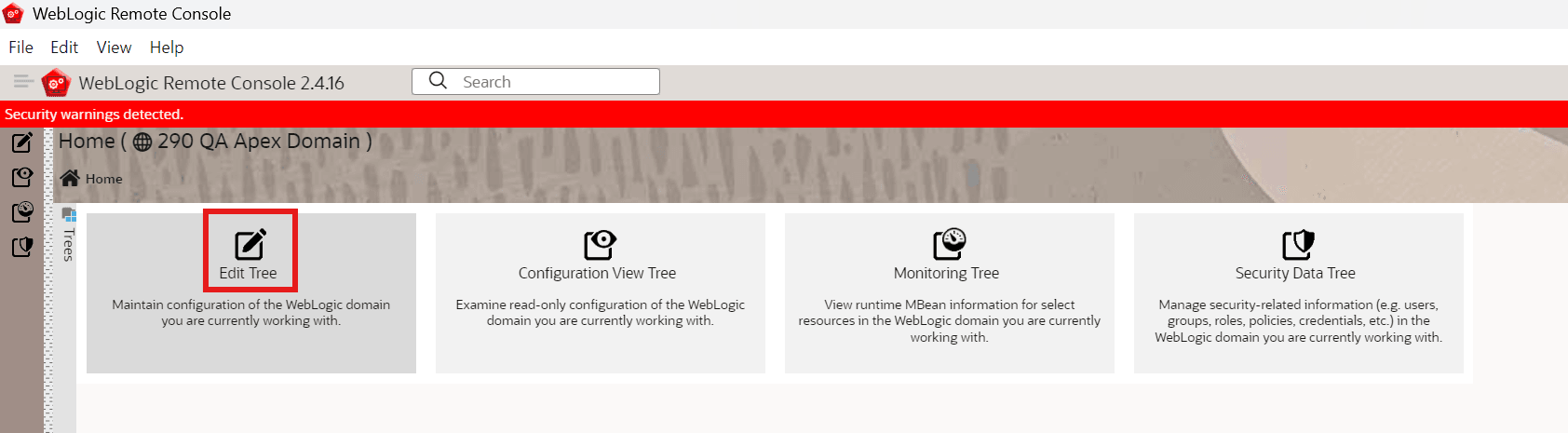

  2. Navigate to Edit Tree > Deployments > App Deployments > New.
    This allows you to maintain the configuration of the WebLogic domain you are currently working with.
    This allows you to create a Java EE application or standalone application module that will be installed in the domain you are currently working with.
  3. Enter the appropriate values for Name (Example: i), Targets (Example: Apex Managed Server apex_server1), and Source Path (Example: full path of the i.war file location).
    This populates the general information of the application deployment.
  4. Click Create and Save then the Commit Changes (img/ouaw-weblogic-remote-console-commit.png) button.
    This creates and saves your new application deployment.

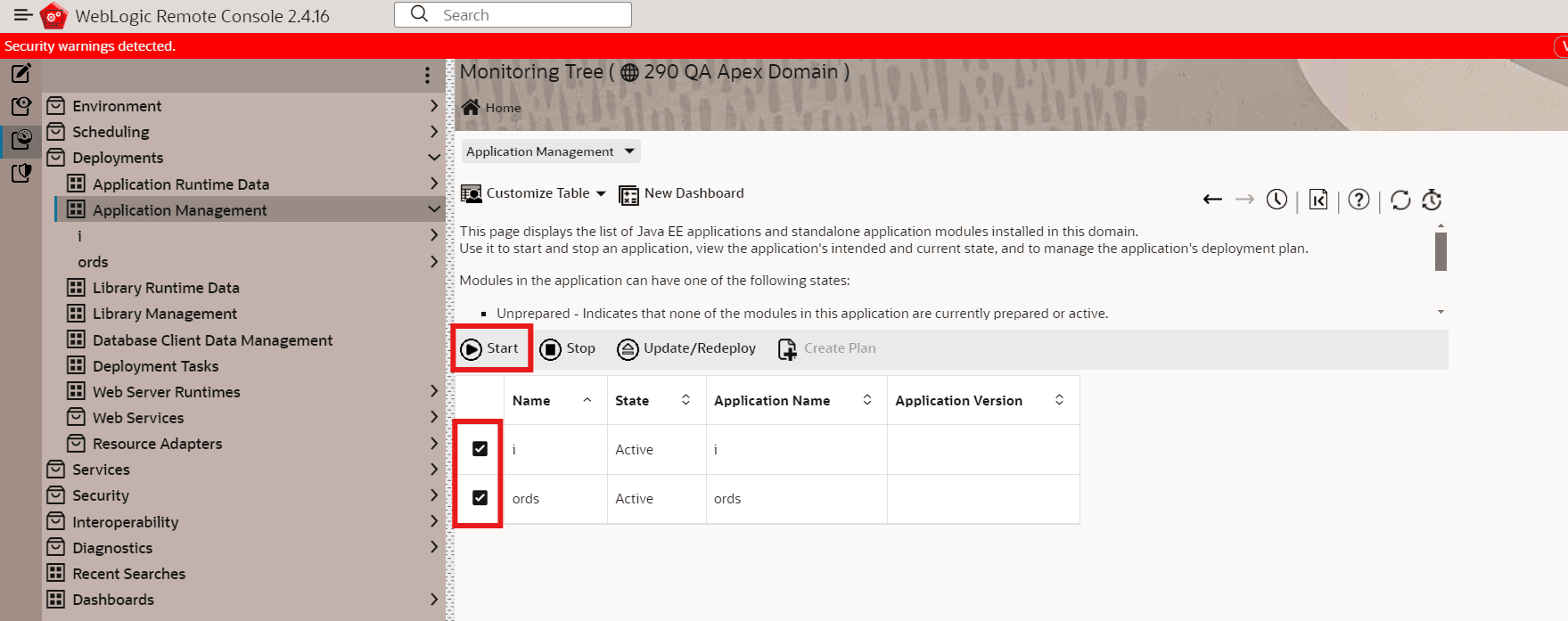

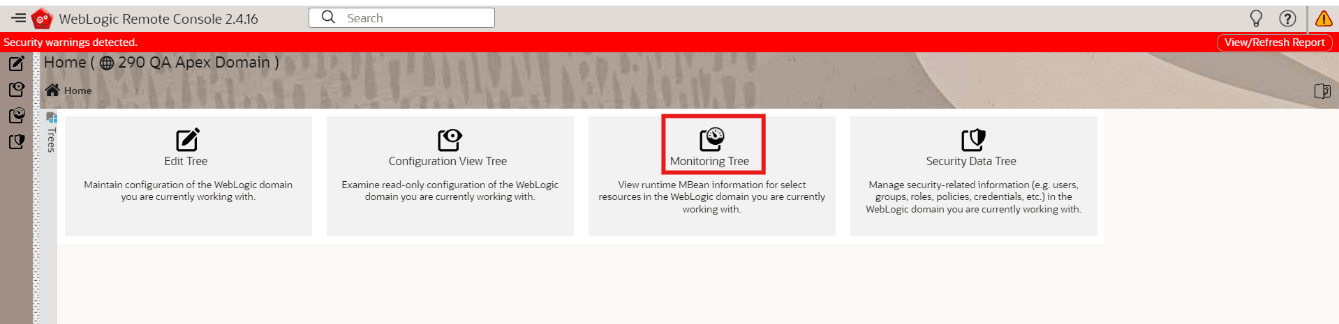

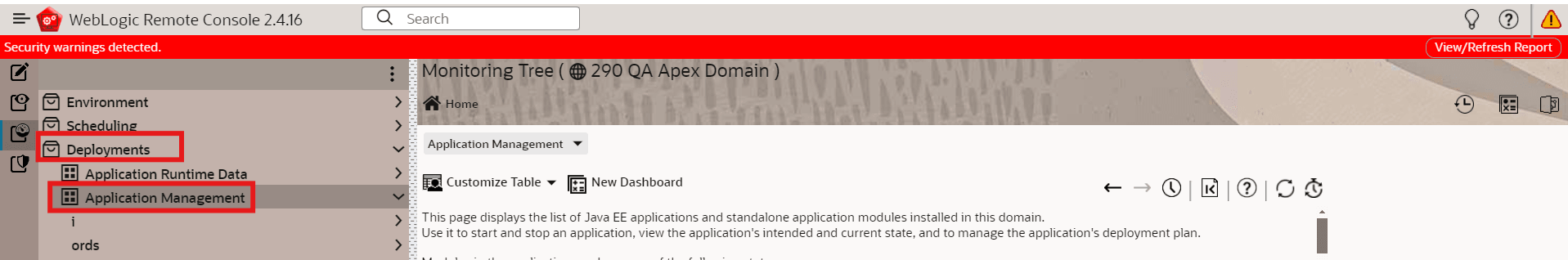

  6. Navigate to Monitoring Tree > Deployments > Application Management.
    This enables you to view runtime MBean information for select resources in the WebLogic domain you are currently working with.
  7. Select the i and ords checkboxes then click Start > Servicing All Requests.
    This allows you to select and monitor the app deployment in the WebLogic domain you are currently working with.

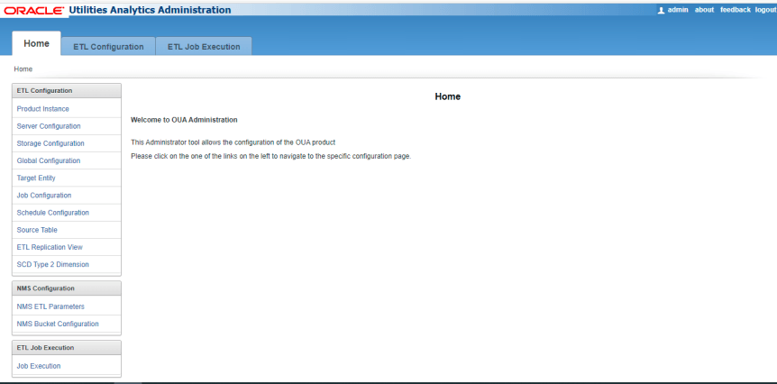

Access the AdminTool

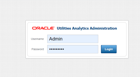

  1. Access the AdminTool from the following URL: http://<hostname>:<apex_server1_port>/ords/f?p=104
  2. Provide the following credentials to access the Admin Tool.
    Username: Admin
    Password: Admin_123
    Oracle Analytics Administration login screen.
    After logging in to the application for the first time, you will be asked to change your password.
  3. After logging in, you can get the following Admin Tool access to ETL Configuration and ETL Job Execution.
    Oracle Utilities Analytics Administration Home tab. Find the mentioned sections in the left-hand pane.
