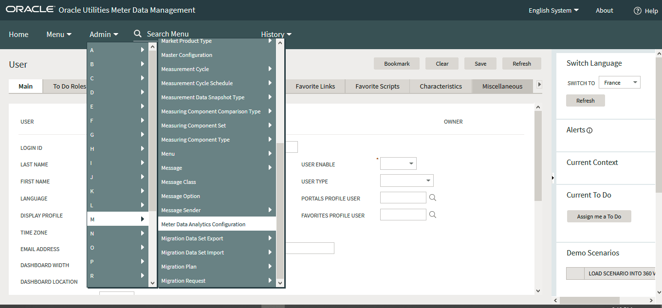

The Meter Data Analytics Configuration portal is a display-only portal that gives an overview of the configurations set up for Oracle Utilities Extractors and Schema, providing links and guidelines for further configurations required to successfully run the data extraction process on MDM.
To access the Meter Data Analytics Configuration portal, log in to the source application and select Meter Data Analytics Configuration from the Admin menu.
Admin tab expanded shows an alphabetical menu. Here the letter M is selected, and then the option Meter Data Analytics Configuration.
Use the Meter Data Analytics Configuration portal to set up the following:

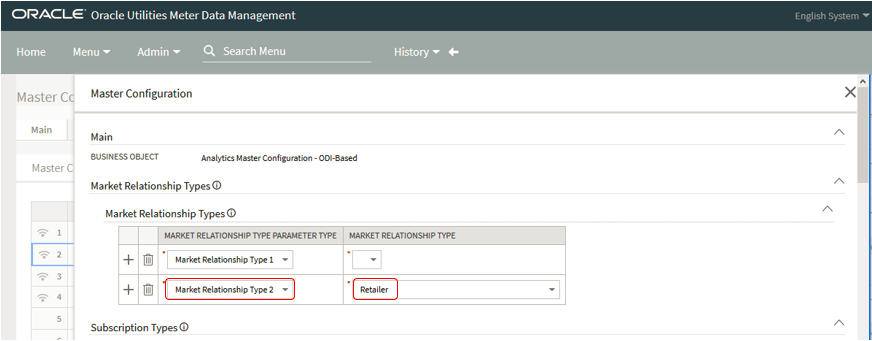

Market Relationship Types Parameter
A service point may have several service providers (for example, distributor, retailer, and so on) where each is defined with a specific market relationship type on either the service point directly or on the service point's market indirectly. All fact tables for meter data management populate SPR1_KEY and SPR2_KEY column based on two configured market relationship types.
To set the value for this parameter:

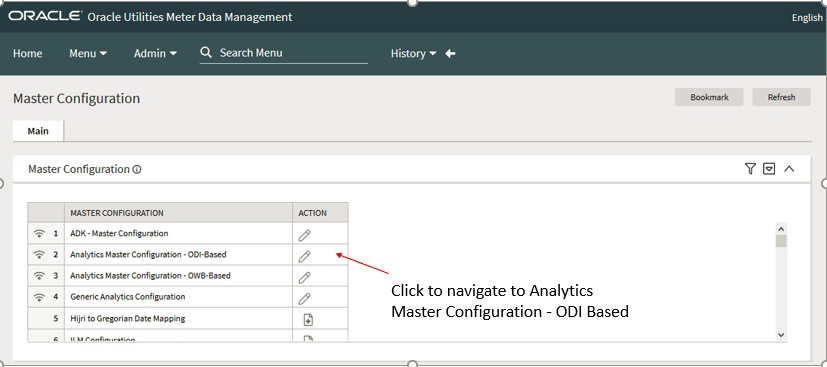

  1. Navigate to the Master Configuration page from the Analytics-Oriented Master configuration portal.
  2. Navigate to the Oracle Data Integrator-Based master configuration option in the table and click the Edit button under the Action column. This will open the Oracle Data Integrator-Based master configuration page where the values for the parameters can be set.
    Master Configuration page showing a table with the names of the master configurations, and the actions available for them. Click the pencil icon to navigate to Analytics Master Configuration ODI based.
    Master configuration window showing the Market Relationship Types section, where you can add or delete items.

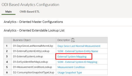

Analytics-Oriented Extendable Lookup Configuration
Every Extendable Lookup BO created for Business Intelligence is listed in this section, which serves as a guide for the setting up of the lookup values. The extendable lookup values can be set for the following BOs.
  • Measurement Condition
  • Days Since Last Normal Measurement
  • Usage Snapshot Type
  • Days Since Last Usage Transaction
  • Unreported Usage Analysis Snapshot Type
  • External System Mapping
  • External System Entity Name
  • External System ID Mapping
To set the values for every BO:
  1. Click the corresponding link under the Description section to navigate to the Extendable Lookup Maintenance portal.
  2. Click the Edit button for the bucket for which the modification is to be made. This will take you to the page for the individual bucket.
  3. Modify the values appropriately and click Save.

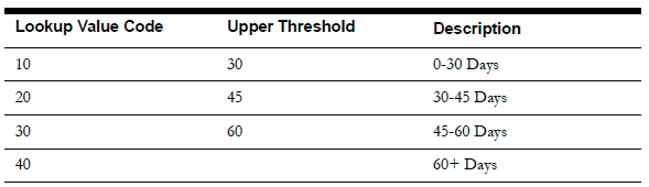

This extendable lookup is used to define the age ranges for days since the last normal measurement was received. Each active instance in this extendable lookup is a bucket definition, where you describe what it is and what is the bucket's upper threshold. If a bucket is meant to have no upper limit (for example, 90+ days), it should be defined with an empty threshold (there should ideally only be one). The lookup value codes should be defined in such a way that when all the instances for the lookup BO are read in ascending order of the lookup value code, their corresponding upper thresholds are also in ascending order. This is important because the extract logic retrieves all the buckets in ascending order of lookup code, will compare the actual number of days on the ordered threshold, and will also apply whichever matches first (less than the upper threshold or the empty threshold). What this means is that the catch-all bucket (empty threshold) should ideally be defined so that it will be the last bucket retrieved. Otherwise, any other bucket definition after the empty threshold will be of no use.
For example, the desired bucket definition is as follows: 0-30 Days, 30-45 Days, 45-60 Days and 60+ Days. This means that the following extendable lookups should be created:
Image of a three columns table that contains the lookup value codes, upper thresholds, and range of days.
The SP Snapshot fact has a measure for the number of days since the service point's last normal measurement, and this configuration is used to find the age bucket that corresponds with that number of days since the normal measurement.
These configured values are extracted into the Days Since Last Normal Measurement dimension (CD_DAYS_LAST_MSRMT).

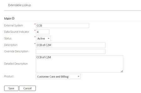

External System Mapping Lookup Value
This extendable lookup provides a mapping of a configured Oracle Utilities Application Framework-based external system and its data source indicator to the configured MDM source in OUAW. The data source indicator is used to uniquely identify the source of the system data.
To set up the external system mapping lookup values for MDM product, perform these steps.
  1. Navigate to Meter Data Analytics Configuration > Analytics-Oriented Extendable Lookup List.
  2. Click External System Mapping in the Description column.
    Analytics - Oriented Extendable Lookup List. Lists the business object and description
  3. Add an external system value and populate the details. This image illustrates the addition of an external system value for CCB.
    Add External System Value.

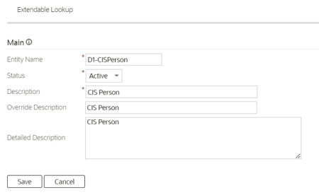

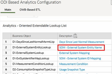

External System Entity Name Lookup Value
This extendable lookup defines the names of the entities that can be received from external systems.
To set up the external system entity name lookup values for an MDM product, perform these steps:
  2. Click SOM - External System Entity Name in the Description column.
  3. Add an external system entity name and populate the details. This image illustrates the addition of an external system entity for CCB.
    Add external system entity.

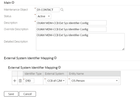

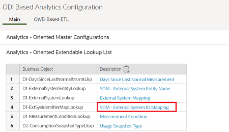

External System ID Mapping Lookup Value
This extendable lookup provides a mapping between the external identifiers captured in Oracle Utilities Meter Data Management and the external system where that identifier is from. Since it is possible that different sets of records for a particular entity may be synchronized from multiple external systems, it is necessary to specify the identifier type to use for each external system. The key information that is captured in this mapping is the maintenance object (which identifies the MO that stores the identifier collection), the identifier type, the external system, and the entity name (which identifies the type of entity that uses this identifier as its external primary key). For example, the Service Point MO can contain identifiers for the Oracle Utilities Customer Care and Billing Service Point ID and Oracle Utilities Customer Care and Billing Premise ID, as well as the Oracle Utilities Operational Device Management Service Point ID.
To set up the external system ID mapping lookup values for an MDM product, perform these steps:
  2. Click SOM - External System ID Mapping in the Description column.
  3. Add an external system ID mapping and populate the details. This image illustrates the addition of an external system ID for CCB.
    This page displays the Main and External System Identifier Mapping sections.
    Add External System Entity.

  2. Set up the Days Since Last Usage Transaction. This will be used to reference the dimension containing the specific age bucket that corresponds to the number of days since the most recent sent usage transaction of the service point. See the Unreported Usage Analysis Snapshot Type dimension for the setup instructions.
  3. Set up the Unreported Usage Analysis Snapshot Type. See the Unreported Usage Analysis Snapshot Type dimension for the setup instructions.
  4. Configure the Service Point Type's unreported usage analysis snapshot configuration. The Service Point Type holds the following information that controls the extract:
    1. Unreported Usage Analysis Snapshot Type
    2. UOM/TOU/SQI: These are used to define the source measuring component's value identifier that will be used to calculate the unbilled consumption in the various age buckets. If there are multiple measuring components linked to the service point with such a combination of UOM/TOU/SQI, all will be mapped. If the service point has no measuring components with this combination, it will be skipped.
    3. Subscription Type: This is the type of subscription that the analysis will be performed on for this type of snapshot; if the service point is not linked to such a subscription, the fact will be linked to the None US, so that the analysis of consumption with no US can be performed.
    4. The Days Since UT buckets and their corresponding descriptions: These are used to categorize the unbilled consumption into different age buckets. For example, if Bucket 1 is defined as 30; Bucket 2 is 45; and Bucket 3 is 60, then any unbilled consumption that is less than or equal to 30 days old will fall into bucket 1, any unbilled consumption that is older than 30 days but less than or equal to 45 days old will fall into bucket 2, and any unbilled consumption that is older than 45 days but is less than or equal to 60 days old will fall into bucket 3.
A separate snapshot can be taken for different subscription types so that a given service point can have multiple snapshots for a given month or week. If the Service Point Type does not have at least one entry in the Unreported Usage Snapshot Configuration list, it means that the service points of this type do not have their snapshot taken.
