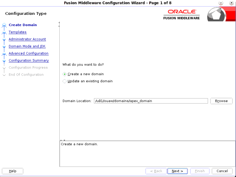

On the Create Domain screen, select Create a new domain, and click Next.
Field Name and Description
Value
Domain Location: Enter the location where the apex_domain can be created.
Example: </u01/ouaw/domains/apex_domain>

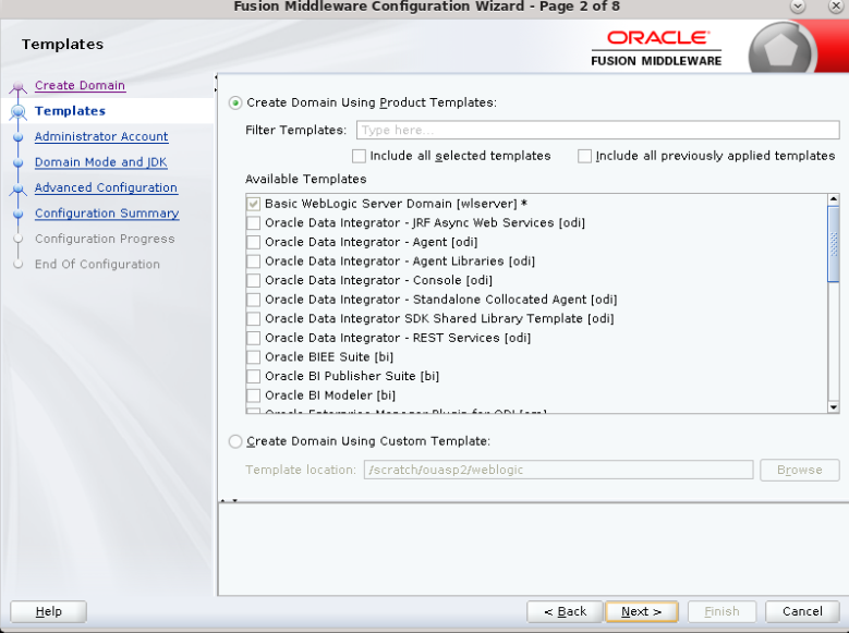

On the Templates page, below the Available Templates list, select Basic WebLogic Server Domain and click Next.

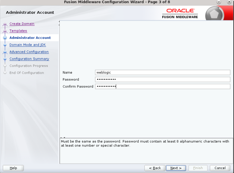

On the Administrator Account page, enter the following values and click Next.
Value
Name: Enter the user name.
weblogic
Password: Enter the WebLogic user password.
<weblogic user password>
Confirm Password: Enter the same WebLogic user password as above.

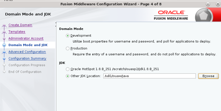

On the Domain Mode and JDK page, select the options as shown below, and click Next.
Value
Domain Mode: Select the appropriate domain mode.
Production mode
JDK: Select the JDK location using a browser.
Example: <JAVA HOME

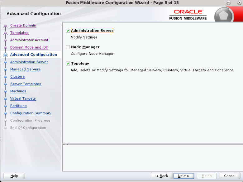

On the Advanced Configuration page, select Administration Server and Topology.

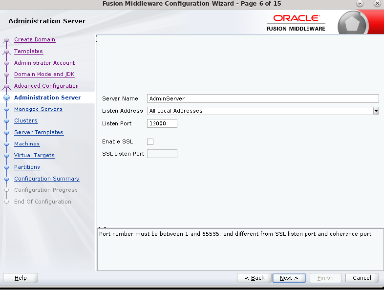

On the Administration Server page, enter the values as in the table below, and click Next.
Value
Server Name: Enter the Admin server name.
AdminServer
Listen Address: Enter the listen address.
All local addresses
Listen Port: Enter the listen port number.
Example: <12000>

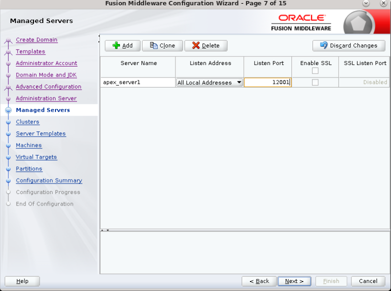

On the Managed Servers page, enter the following values to add a managed server. Click Next.
Value
Server Name: Enter the managed server name.
Example: <apex_server1>
All local addresses.
Example: <12001>

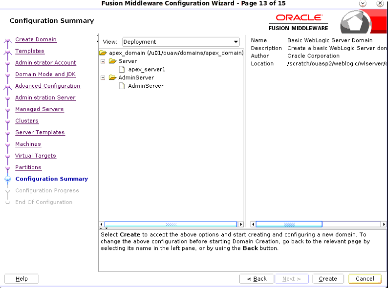

On the Configuration Summary page, click Create .

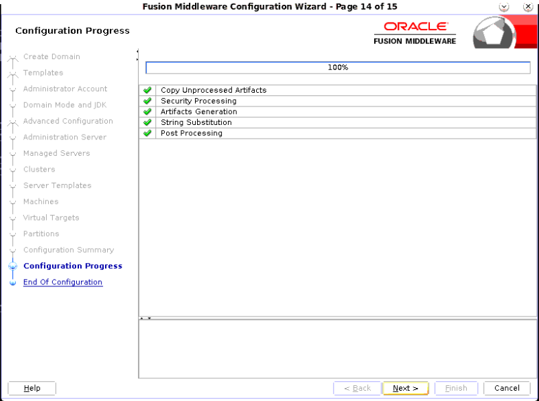

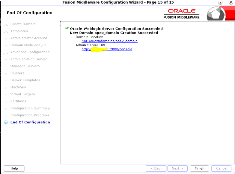

On the Configuration Progress page, wait until the progress bar is 100% complete and then click Next.
On the End Of Configuration page, you will find the domain path and the administration server URL that will be used in the following steps. Click Finish.

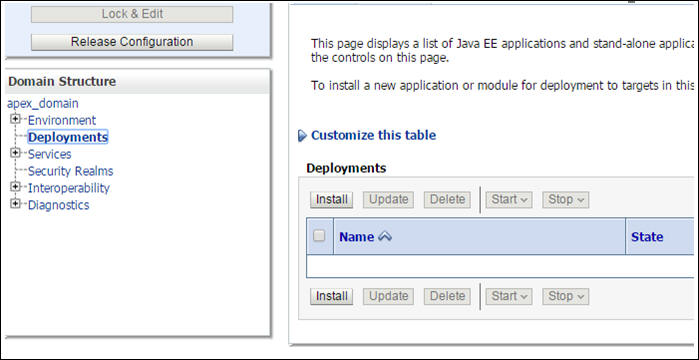

Log in to the <apex domain> WebLogic administration console and click the Lock & Edit button located in the Change Center.
On the Domain Structure panel, select Deployments and then click Install.
Enter the appropriate path and then select the ords.war file. Click Next.
Example: </u01/ouaw/ords> -

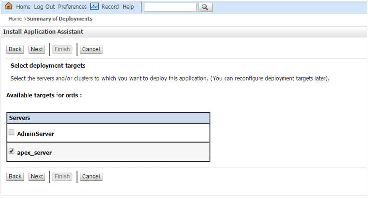

Select the deployment target as <apex_server1>.

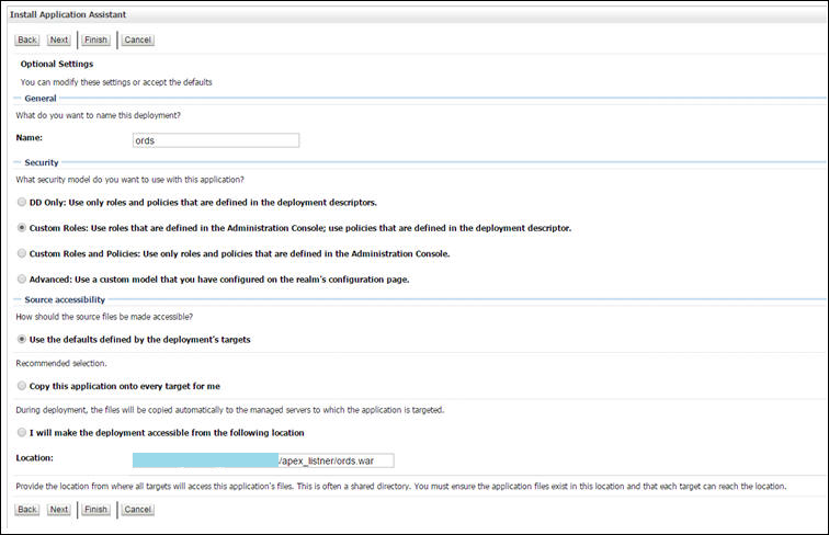

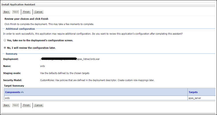

Enter the following information on the application assistant:
Value
Name: Enter the deployment name.
ords
Security: Select the security model to be used.
Select the Custom Roles option.
Source accessibility: Select the source accessibility option.
Select the Use the defaults defined by the deployment's targets option.
The location of ords.war file and target will appear on the Summary section. Click Finish.
After saving the ords.war deployment, click on the Activate Changes button located in the Change Center.

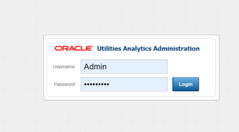

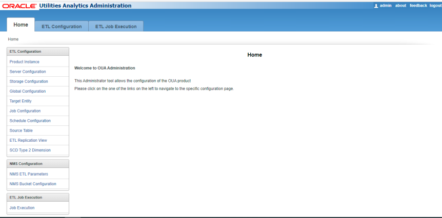

Access the AdminTool
Access the AdminTool from the following URL: http://<hostname>:<apex_server1_port>/ords/f?p=104
Provide the following credentials to access the Admin Tool. Note: After logging in to the application for the first time, you will be asked to change your password.
Username: Admin
Password: Admin_123
After logging in, you can get the following Admin Tool access to ETL Configuration and ETL Job Execution.
Change Default Password of the Admin User
