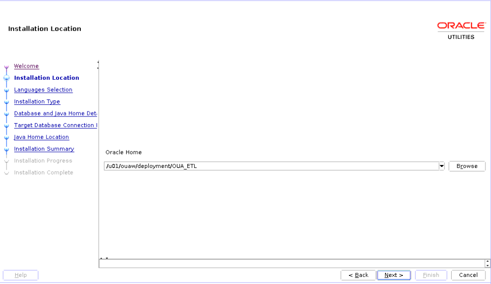

  6. On the Installation Location page, define the installation location in the Oracle Home field and click Next.
    Note: The specified Oracle home directory must be an empty directory.
    Installation Location screen displays a dropdown menu for the user to browse for the Oracle Home
    Field Name and Description
    Value
    Oracle Home: The directory where the Oracle Utilities Analytics Warehouse ETL is going to be installed.
    Note: This directory location is called the ETL Home. Keep track of it as it will be used during some deployment steps.
    Example: <ETL Home>
    </u01/ouaw/deployment/OUA_ETL>

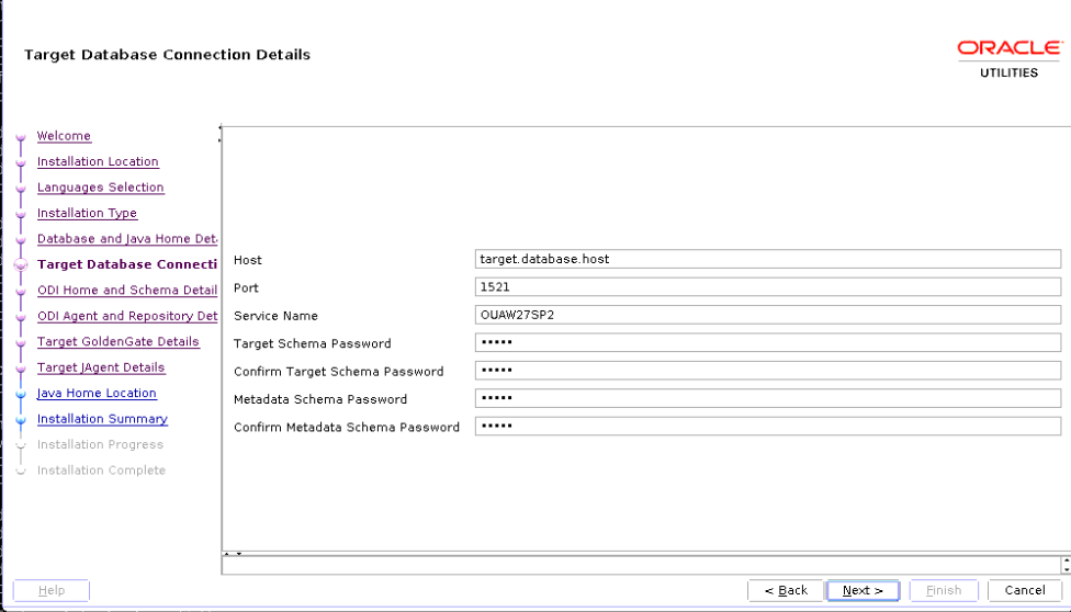

  1. On the Target Database Connection Details page, enter the following and click Next.
    Target Database Connection Details screen shows seven text fields to be populated by the user.
    Value
    Host: The target database  server where database resides.
    Target Database server host name.
    <dbserver.hostname>
    Port: The target database server port number.
    Target Database port.
    Example: <1521>
    Service Name: The target database service name.
    <Database service name>
    Target Schema Password: Password for the target schema (DWADM).
    <DWADM user password>
    Confirm Target Schema Password: Confirm password for the target schema (DWADM).
    Target Schema Password: Password for the metadata schema (MDADM).
    <MDADM user password>
    Confirm Target Schema Password: Confirm password for the metadata (MDADM) schema.

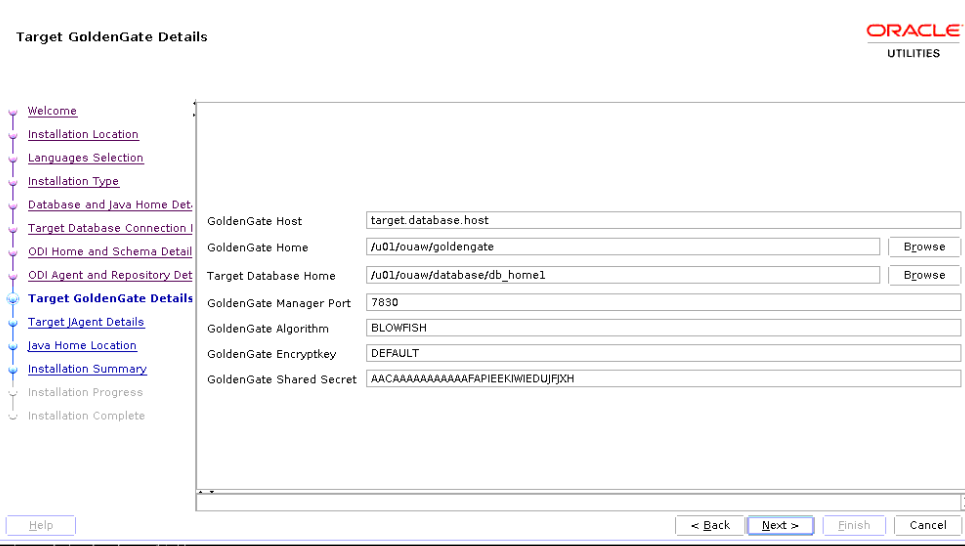

  1. On the Target GoldenGate Details page, enter the details as in the table below, and click Next.
    Target GoldenGate Details page displays seven text fields to be populated by the user.
    Value
    GoldenGate Host: Enter the Target database hostname where GoldenGate is installed.
    Target database server host name
    Example: <dbserver.hostname>
    GoldenGate Home: Enter the GoldenGate installed location.
    Example: <GoldenGate Home.>
    Target Database Home: Enter the target database installed location.
    Example: <ORACLE HOME>
    GoldenGate Manager Port: The Oracle GoldenGate Manager port which is running on the database server host.
    <The default value is 7830>
    GoldenGate Algorithm: The algorithm configured in Oracle GoldenGate on the target database server
    The default value is "BLOWFISH".
    GoldenGate Encryptkey: The Encrypt Key configured in Oracle GoldenGate on the target database server.
    The default value is “DEFAULT”
    GoldenGate Shared Secret: Shared secret key configured in Oracle GoldenGate on the target database server.
    Go to the Oracle GoldenGate prompt and run the command:
    encrypt password <password of MDADM user>, encryptkey DEFAULT
    Provide the result of the above command as the value.

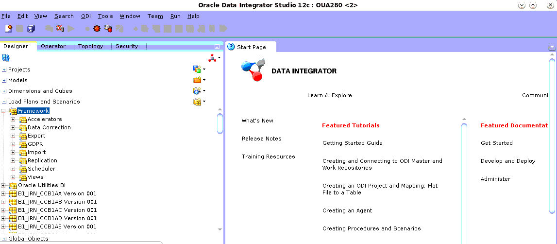

Perform Initial Setup for Star Schema
Follow the steps below to execute the B1_INITIAL_SETUP_PKG from the ODI console.
  1. Change the directory to <FMW HOME>/odi/studio/bin.
  2. Set the JAVA HOME.
    Copy
    export JAVA_HOME=<JAVA_HOME>
    export PATH=$JAVA_HOME/bin:$PATH

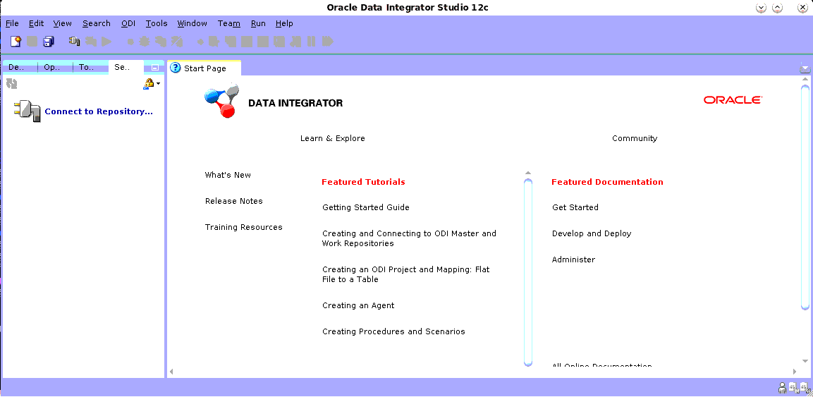

  3. Run the ODI executable file ./odi. This opens Oracle Data Integrator Studio.
    Note: Oracle Data Integrator (ODI) Studio 12.2.1.4 is not supported in AIX and Solaris operating systems. Install ODI in either Linux or Windows machines to connect to the target database.

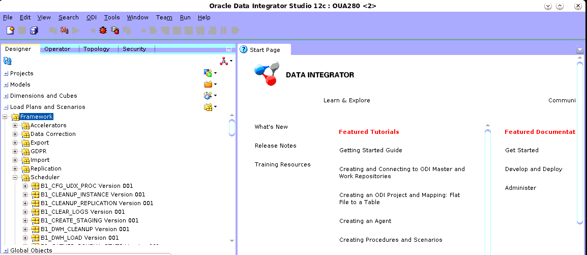

  4. Log in to Oracle Data Integrator Studio and navigate to Designer > Load Plans and Scenarios > Framework > scheduler.
    Data Integrator Start Page appears in the right-hand and main section of the ODI studio.
  5. Navigate to the Load Plans and Scenario folder in the Designer tab.
    Data Integrator Start Page appears in the right-hand and main section of the ODI studio. In the left-hand panel, the Scheduler option under the Framework option is expanded.
  6. Expand the Framework folder.

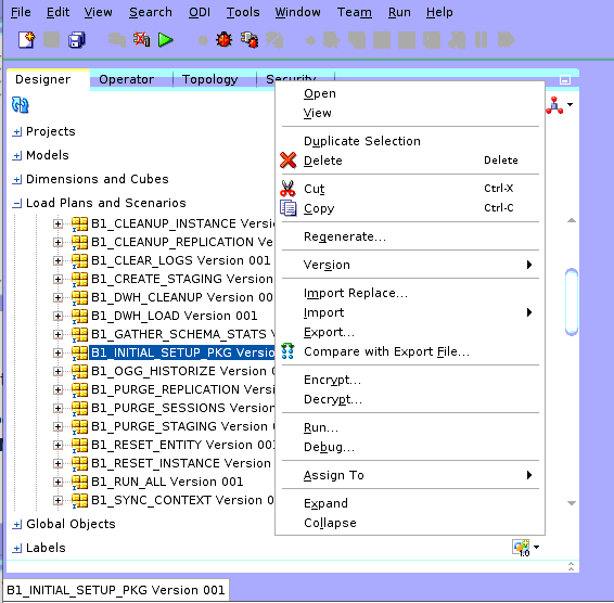

  7. Right-click on B1_INITIAL_SETUP_PKG Version 001 and click Run. A popup windows opens.
    Right-click menu of options is shown here, and one of the load options is selected. The Load Plans and Scenarios option under the Designer tab of the ODI console appears expanded.

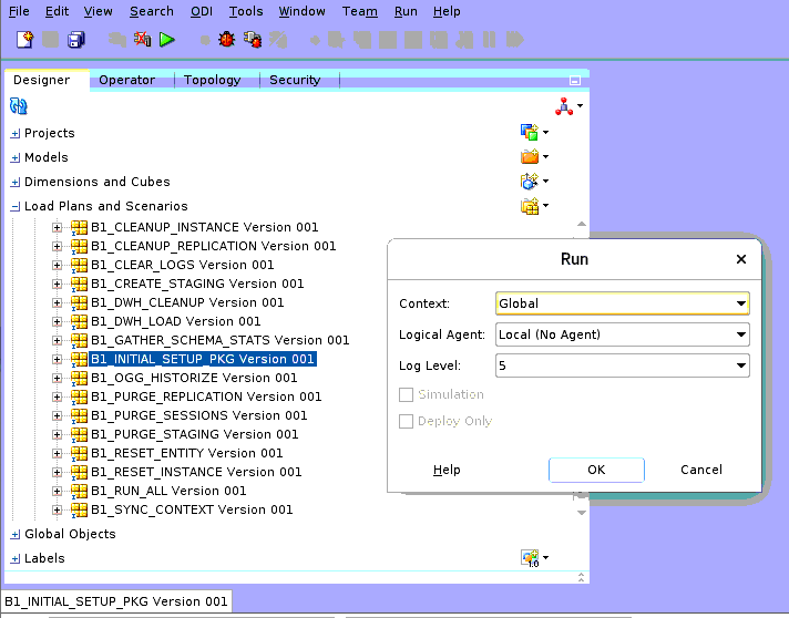

  8. In the Context field, select GLOBAL. In the Logical Agent field, select Local (No Agent). Click OK.
    Load Plans and Scenarios option expanded under the Designer tab in the ODI Console. Here, the Run dialog is displayed, since one of the load options is selected.
