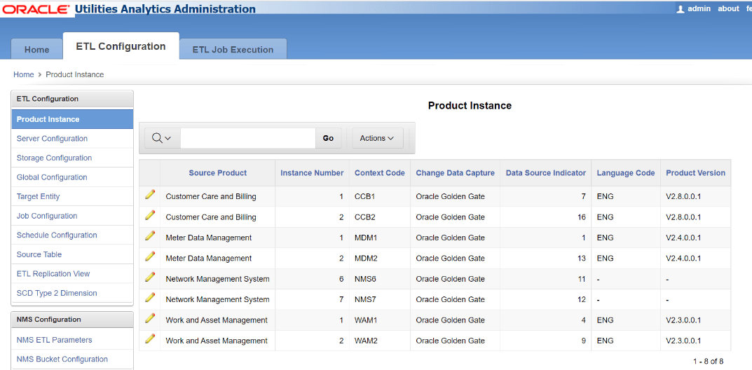

Product Instance Configuration
You may have multiple instances of the same source application to integrate with OUAW.The Product Instance page, accessible through the ETL Configuration tab, displays information about the product instances configured with OUAW.
| Attribute | Purpose |
| Product Code | A reference to the product code that identifies the product for this instance. |
| Instance Number | A unique number starting with 1 to uniquely identify the instance. |
| Context Code | A unique code comprised of the product code and instance number that is used to identify the connections in Oracle Data Integrator. Due to limitations imposed by Oracle GoldenGate (used for replication), the context code cannot be more than five characters in length. |
| Change Data Capture | A flag identifying the methodology to be used for replicating source tables. The default is GoldenGate. |
| Drill Back URL | A URL to be used to allow you to drill back to the source system from the analytics. |
| Time Zone Code | The time zone of the source product instance. This allows the interfaces to be built so that dependencies on job execution for multiple time zones are handled correctly. |
| Currency Code | The currency used in the source product instance. Multiple currencies are not supported. |
| Language Code | The primary language supported by the data warehouse. This is used to filter language specific data in the data warehouse. |
| Data Source Indicator | A unique value representing the instance. For Oracle Utilities Application Framework products, this is the environment ID of the source instance. |
| Source Instance Version | The current version number of the source product instance. This can be used to validate whether the version is supported by the data warehouse or provide suggestions if upgrades or patches need to be applied to enable support for the source product. |
To add a new product instance, use the script delivered as a part of the installation package. For more details, see 'Configuring the Source' under the 'Upgrading Oracle Utilities Analytics Based ELT Component' section in Chapter 5: Upgrading Oracle Utilities Analytics.

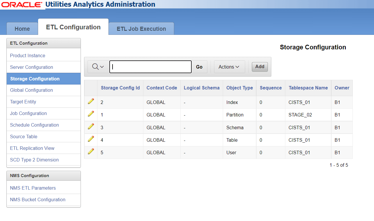

Storage Configuration
Base product-owned records are delivered out-of-the-box for the star schemas tables that come with OUAW, and they cannot be deleted. If you want to add any entity to the ELT, you can create a new record, which can be later edited or deleted.
| Context Code | Identifies the context for which this is applicable. A value of "GLOBAL" is allowable across all the contexts unless overridden by an entry for the specific context. |
| Logical Schema | The logical schema for which the configuration is applicable. An empty value indicates that this is applicable to all logical schemas. |
| Object Type | The type of object for which the configuration is applicable. This can be Table, Index, or Partition. |
| Sequence | The default is 0. This is applicable only to partitions. This can be used to map multiple tablespaces in round-robin scheduling while creating the new partitions within the same table. |
| Tablespace Name | The name of the tablespace to be associated with the object. |

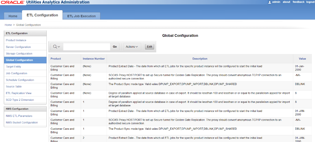

Global Settings Configuration
The Global Configuration page, accessible through the ETL Configuration tab, is used for setting up the global parameters needed for OUAW, allowing you to enter or edit values for the configuration settings. As a part of the OUAW installation process, the global configuration records are generated for both the configured source application and the target OUAW application. The configuration values must be entered in the specified data format. Entering values in any other format causes errors during ELT processing.
| Product | A reference to the product code that identifies the product for this instance. This could be one of the configured source products or the base Oracle Utilities Analytics Warehouse product itself. |
| Instance Number | The unique number of the configured source product instance. For the base Oracle Utilities Analytics Warehouse product configuration settings, this value is set to null. |
| Description | This column describes the purpose of the specific global configuration setting. |
| Value | The configuration value that you can update based on their setup. |
| Data Type | The data type of the configuration value that a user is expected to enter. |
| Data Format | The specific format of the data that a user is expected to enter the configuration value in. |

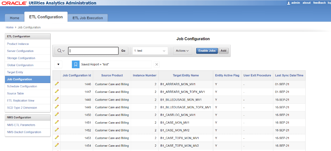

Job Configuration
| Source Product | A reference to the product code, which identifies the product for this instance. |
| Instance Number | To be populated for instance specific deviations. Ideally most data should be reusable across instances of the same product. |
| Target Entity | A reference to the entity. |
| Entity Active Flag | Indicates whether the ELT job should be picked up for execution by the Oracle Data Integrator Scheduler. |
| Slice Date/Time | That starting timestamp for the next execution. |
| Initialize Flag | Controls the initialization of the entity for slicing. |
| Execution Sequence | Sequence of execution within the same group. |
| Last Sync Timestamp | Stores the timestamp of the most recent successful slice. |
| Override Slice Duration Type/Override Slice Duration |
The override slice duration fields act as the overriding value for the ones in the target entity:
| User Exit Procedure | The procedure name, which can be used to load the user-defined columns in the entity. |

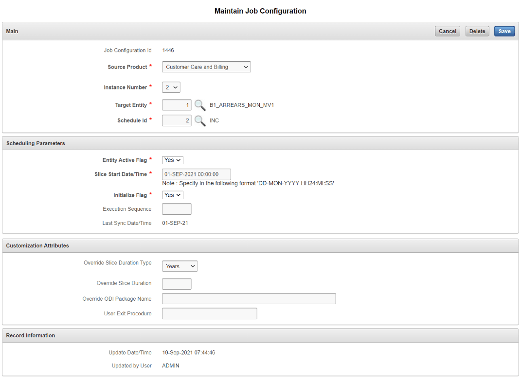

Maintain Job Configuration
To specify configuration for a job, open the Maintain Job Configuration page by clicking the Add (+) or the Edit buttons for a selected job record row on the Job Configuration page.

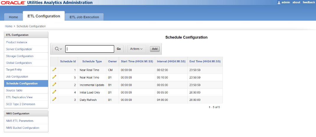

Schedule Configuration
The Schedule Configuration page, accessible through the ETL Configuration tab, is used to configure a job’s scheduled start and interval. Multiple schedule types can be created with different schedule periods and jobs can be assigned to them; the various job schedules may be distributed so multiple jobs do not run simultaneously. The schedule period has to be created first and then it has to be updated in the Job Configuration page. See Job Configuration for details.
| Schedule Type |
There are four schedule types:
| Schedule Start Time | The time in a day when the load can be started. |
| Schedule Interval | The time interval between the consecutive execution of jobs. |
| Schedule End Time | The time in a day after which the load cannot be started. |

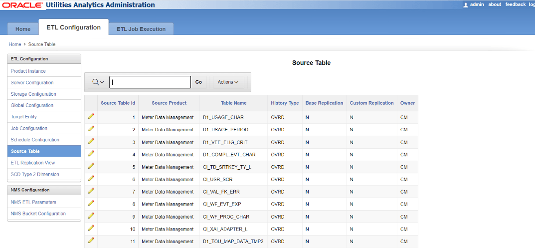

Source Table Configuration
The Source Table page, accessible through the ETL Configuration tab, displays the list of tables from the source applications that are available for replication in Oracle Utilities Analytics Warehouse (OUAW) and their mode of replication. For those tables that are not replicated in the base product, this page allows you to enable custom replication.
Click on the pencil icon on the first column to the left of the table.
Set the Custom Replication flag value to Y for the table in the Manage Replication Details section.
You may also change the History Type of the table to be replicated.
Changing the history type of a table already configured and replicated may result in error in the processing of ELT jobs and in data processing by GoldenGate.
| Source Product | A reference to the product code that identifies the product for this instance. |
| Table Name | The name of the source table. There is also a corresponding entry in the objects table. |
| History Type |
The following scenarios exist:
| Effective Date Column Name | The column name used for storing the effective dates in the source. |
| Characteristic Entity | Identifies the Char Entity flag in the source Oracle Utilities Application Framework application. |
| Base Replication | Controls whether the table is required to be replicated for target entity load. |
| Group Number | Defines the grouping of various tables for a source product. The group numbers are used to define the various GoldenGate models that are set up to extract data from the source system. |
| Custom Replication | Extension for customizations. The additional tables to be marked for replication. |
| Purge Enabled | Controls whether the replicated table should be purged or not. |
| Replication Retention Days | The number of days the data should be retained in the replication layer. |
| Owner Flag | Indicates whether the record is owned by the base product (B1) or you (CM). |

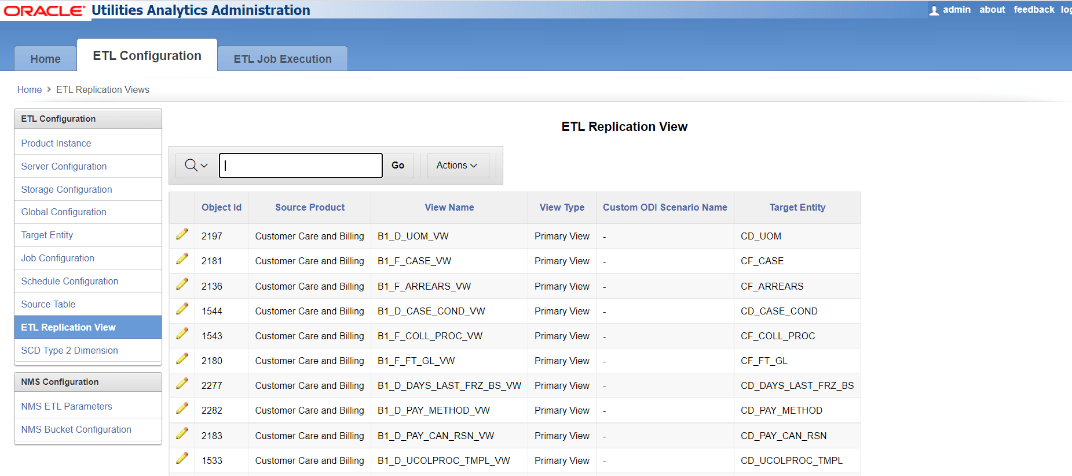

ETL Replication View

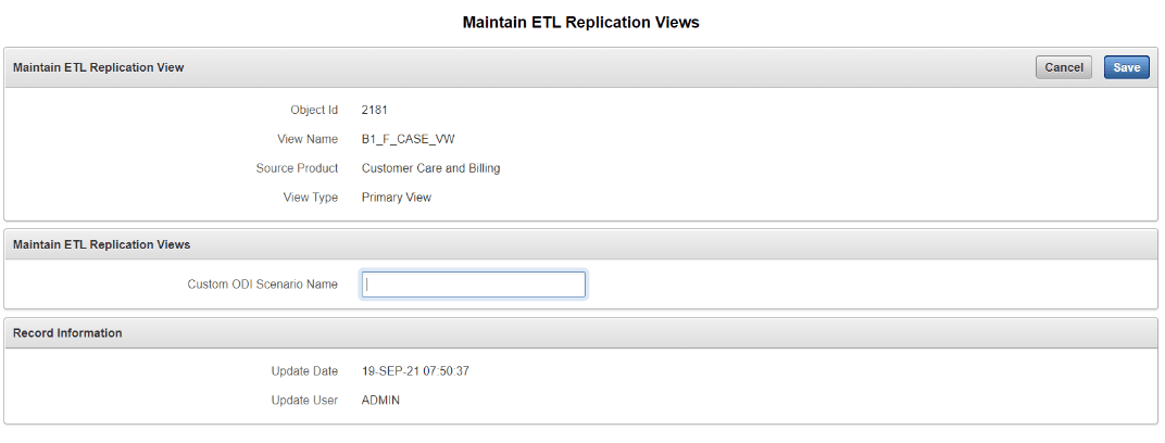

Every ETL job in the data warehouse depends on one or more Oracle Data Integrator interfaces to populate the target fact or dimension tables. The starting point is a view defined for the ETL job in the replication layer of the specific source product. This ETL replication view fetches the base values from the replication tables as a starting point for further transformations to be done by the Oracle Data Integrator interfaces.
In certain business scenarios, it might be necessary for you to override the definition of the provided ETL replication view. For example, in Oracle Utilities Network Management System, a particular type of data may be stored in different tables based on the network model. The base view definitions supplied for Oracle Utilities Network Management System ETL are designed based on the OPAL network model. When you use a different model, you might have to change the definition of some of these views in the replication layer for your network model.
To take a more specific example, the B1_D_ACCT_VW for the account dimension in the Oracle Utilities Network Management System star schema tries to fetch the account-related attributes from the CES_CUSTOMERS_HISTORY table. If your model stores the account attributes in a different table, then the view definition needs to be changed. The Maintain ETL Replication Views page in the Oracle Utilities Analytics Administration Tool allows you to do this by defining a custom Oracle Data Integrator interface to generate the view. The view name and the column names in the view should be exactly as it was delivered. However, the view definition can be changed in accordance with your requirements.
A scenario should be generated for the custom Oracle Data Integrator interface and should be shown in the Oracle Utilities Analytics Administration tool page against the appropriate view name with a definition that needs to be overridden. When views are then generated through the Run View Generator script, the ETL framework creates the view-based Oracle Data Integrator scenario that you entered.

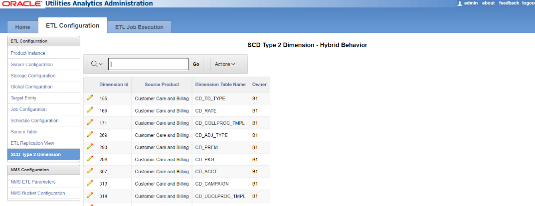

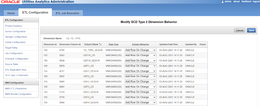

SCD Type 2 Dimension Column Properties of Type 2 Slowly Changing Dimension
- Natural Key
- SCD Start
- SCD End
- SCD Flag
Any change in any of the remaining columns is treated as a new history item for the same natural key. You can decide which of the columns should not be considered for creating a new history item. Using Oracle Data Integrator, this is done by changing the corresponding property of the column in the model of the target dimension. However, this change requires regeneration of the dimension load scenario. The customization that you do will get overridden by any future upgrades provided by Oracle. You can control the columns where a change causes a history to be created.
You can change the properties by accessing the administration tool.
- Navigate to the /bin directory.
Add Java 8 to the following path variable:
export PATH=/bin:$PATH
- Run ksh ./updateODIMetadata.sh.
After the SCD2 dimension behavior is customized, execute the script after every upgrade to retain the customized behavior.NMS Configuration
