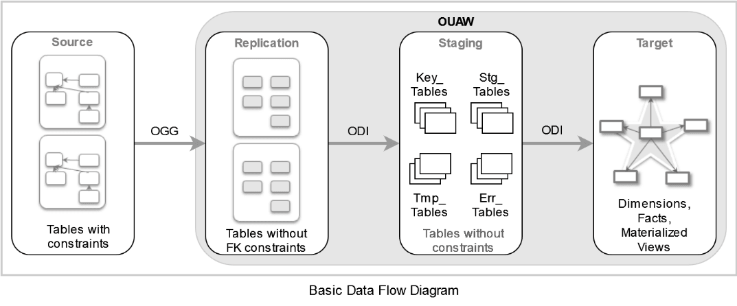

The following image is a high-level diagram of OUAW's data flow.
This data flow diagram illustrates four main entities. Tables with constraints are in Source and outside of OUAW; this connects through OGG to Analytics Warehouse, where are tables without FK constraints in Replication, tables without constraints in Staging, and the dimensions, facts, and materialized views in Target.

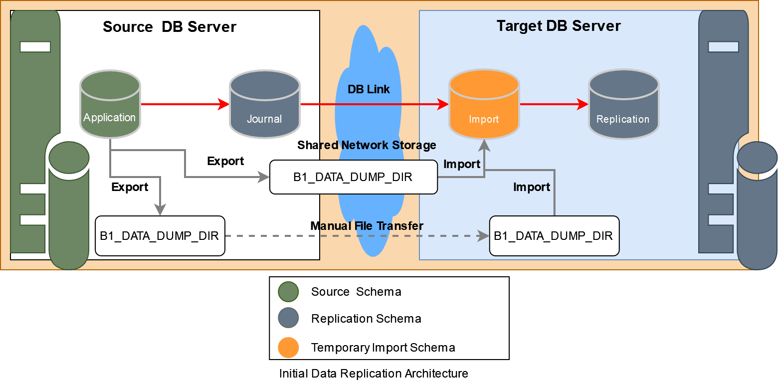

Initial Data Replication Approach
This section explains the methods used to load the initial data in OUAW through the Oracle Database feature DBMS_DATAPUMP to bring existing historical data from the source database to the replication schema. There are three different modes to synchronize the initial source data with the target:
  • Export and Import:In this mode, data is first exported from the source into the database directory (B1_DATA_DUMP_DIR) in source. Then the dump file needs to be transferred from the source into target manually. Once dump files are moved into the database directory (B1_DATA_DUMP_DIR) in target, then data is imported into the replication schema. Export and import logs are written into the source and target database directory, respectively.
  • Export and Import Using Shared Network Storage : This mode is similar to the previous one, but this mode requires shared network storage. Both source and target should be able to access the database directory (B1_DATA_DUMP_DIR) in this shared network storage. In this method file transfer is not required and this is the best mode to load a large volume of initial data into the target.
  • Database Link: In this mode data will be imported directly from the source into the target using the database link, which is created during the integration of the source with OUAW.
  • Tables in the replication schema contain a few additional columns called journal columns for ETL purposes. Transformation logic needs to be applied to populate these additional columns into the replication schema.
  • Data transformation at the time of extraction from source over network will impact performance. Therefore, raw source data is first imported into a temporary schema called import schema and then it is transformed and loaded into the target replication schema from the import schema. Import schema is dropped by the initial data synchronization job at the end of initial data load.
  • No data filtering is applied at the time of initial data synchronization. Therefore, initial synchronization job synchronizes complete data from the source for all tables configured to be replicated.
Diagram of the initial data replication architecture that goes from the source to the replication schema. In the source, Application and Journal are shown. Journal then connects to the temporary import schema, passing through DB Link. The process ends with Replication.

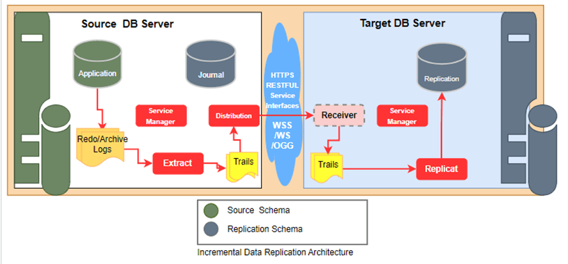

Incremental Data Replication Approach
OUAW uses Oracle GoldenGate Microservice Architecture to replicate change data into the target replication schema. The change data synchronization process is set by the Oracle Data Integrator process during the integration of the source system with OUAW. The GoldenGate primary extract process in the source is meant to capture change data from the redo or archive logs and write that data into trail files in the trail location. GoldenGate distribution process sends those trails over the network and into the target trail location. Finally, GoldenGate replicat process applies those transactions in trail files into the target replication schema. Oracle Utilities Analytics Warehouse uses integrated extract and integrated replicat process to synchronize change data from the source into the target database.
Diagram of the incremental data replication architecture that goes from the source to the replication schema in the target. The source server contains Application and Journal. Here occurs the extraction of logs and the pump process for the trail files. Pump connects to the collector through TCP IP, which then sends the trail files to the replicat process.
