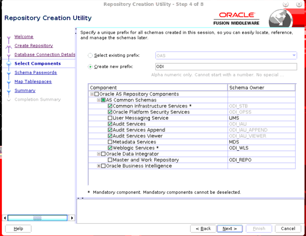

Configure repository
  1. Ensure JAVA_HOME is defined.
  2. Ensure ODI is installed.
  3. Run the Repository Creation Utility (RCU) for ODI schema. Example execution:
    <FMW Home>/oracle_common/bin
    ./rcu
  4. Create a Schema repository for ODI and provide the database connection details.
  5. On the Select Components section, create a new prefix (for example, 'ODI'), select the Oracle Data Integrator checkbox, and then deselect the Oracle Data Integrator checkbox.
    Select Components section in Repository Creation Utility page.Select your components as detailed in step 5.
  6. Click Next and proceed through the rest of the screens to create the repository.
    Keep track of the password given. It will be required while creating the Oracle Data Integrator domain.
