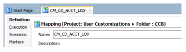

4. In the New Mapping window, enter the name of UDX in the Name field.
Example: CM_CD_ACCT_UDX
5. Unselect the Create Empty Dataset checkbox.
A new mapping “CM_CD_ACCT_UDX” is created.Shows that a new mapping “CM_CD_ACCT_UDX” is created.

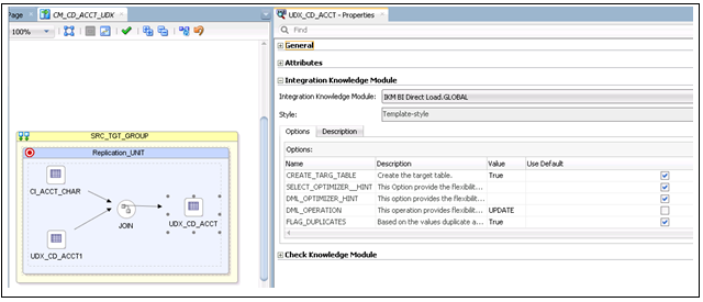

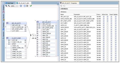

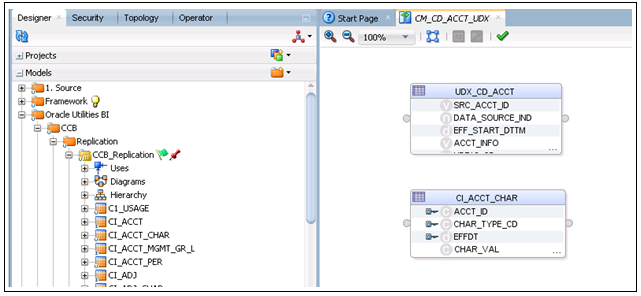

6. Click the Logical tab to view the table structure.
7. From the Models section, drag and drop the UDX and replication tables in the designer pane.

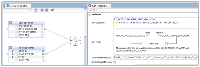

8. Join the UDX and replication table.
9. Drag and drop the UDX_CD_ACCT target data store.
Select UDX as the target table, and then select the appropriate key on the UDX table as defined in the CD_ACCT dimension. The logic to populate UDX should be taken care in the mapping accordingly.
10. On the Physical tab, select the optimization context.
11. Select the target table (UDX_CD_ACCT) and select IKM BI Direct Load from the Integration Knowledge Module drop-down list.
12. On the Options tab, set DML_OPERATION to UPDATE instead of MERGE.
13. Unselect the CREATE_TARG_TABLE option since the UDX table is already created.
The custom mapping is successfully created. A custom package can be created using this mapping.

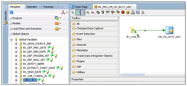

5. Click the Diagram tab at the bottom of the editor.
6. From the Global Objects section, drag and drop the ‘B1_JOB_ID’ variable into the editor.
7. Change ‘B1_JOB_ID’ to declare the variable.
8. Drag and drop the CM mapping (existing mapping) into the editor and connect them in sequence.
9. Click Save and close the package editor window.

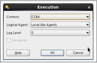

3. Right-click B1_RESET_ENTITY and select Execute.
4. On the Execution window, select CCB4 as the Context and then click OK.

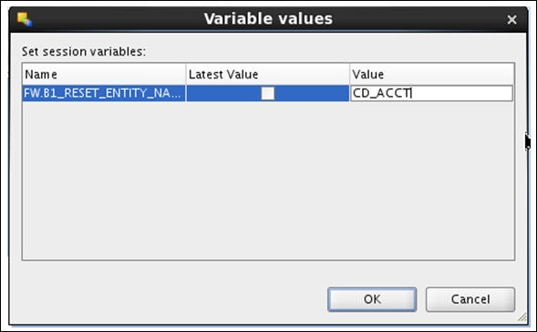

5. On the Variable values window, enter ‘CD_ACCT’ as the entity name. Click OK.

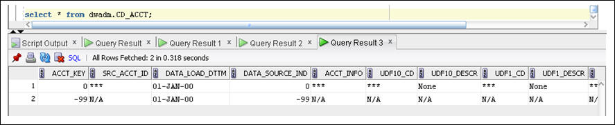

7. Connect to SQL Developer and query the dimension to verify that all rows except the default 0 and -99 records have been deleted.

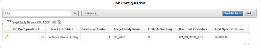

4. Click the edit icon to edit the details for the product instance for which the UDX has to be populated. There are different jobs for the same entity for different product instances.
5. On the Maintain Job Configuration page, enter the Custom Package Name (example: B1_PKG_CM_CD_ACCT_UDX) in the User Exit Procedure field.
6. Ensure Active Flag is set to 'Yes'.
7. Click Save to save the configuration changes.

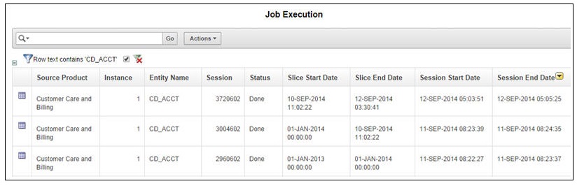

2. On the ETL Job Execution tab, enter “CD_ACCT” and click Go to filter the data.
To see the latest execution, sort by the session end date.
