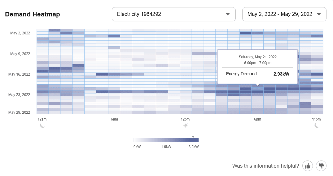

This section describes the user experience of the Demand Heatmap for business customers who have electric interval AMI data. The image below is an example of the Demand Heatmap.
Screenshot of color-coded heatmap showing dates and times of demand usage patterns for business customers.
Service Point Selector: A service point selector menu may display above the heatmap for businesses that have multiple service points of the same fuel type at a premise.
Date and Time Menu: The date and time menu allows business customers to select the bill period for which to view demand data. The menu is limited to displaying options for the last 12-13 months.
Depending on the customer's billing cycle, the menu shows different date ranges for different bill periods. For example, a customer on a monthly billing cycle would see menu options with month-long date ranges, while a customer on a bi-monthly billing cycle would see menu options with bi-monthly date ranges.
Demand Grid: The demand data is shown in a color-coded grid view. By default, a single color gradient is used so that the colors are more accessible to colorblind customers.
  • X-Y Axis: The y-axis represents the days and weeks of the selected time period. The x-axis represents the time of the day, broken down into 24 hours.
  • Panels: The panels in the grid represent different time intervals (such as one hour) depending on the resolution of the customer's data. Each panel in the grid is color-coded to indicate how much energy was in demand at that point in time.
  • Rows: The number of rows in the demand grid varies depending on the customer's billing cycle. For example, a customer with monthly billing would see a grid containing data for about four weeks, while a customer with bi-monthly or quarterly billing would see a grid containing data for additional weeks.
  • Highest Demand Interval: An icon is displayed in the panel when demand was at its peak. Demand refers to the rate at which a business consumes electricity, not the actual amount that is consumed. This means that the interval with the peak demand icon may not always be the same as the interval with the highest amount of energy use. See Demand Versus Energy Use for more information about the difference.
Note: Any data that is available will be displayed. If some reads are missing (for example, if a customer's meter malfunctioned or was unable to send data reads to the utility for some reason), the corresponding panels in the grid will appear empty.
Tooltips: A tooltip is displayed when a business customer interacts with a data point in the Demand Heatmap. The tooltip includes two elements.
  • Time Period: The time period for the selected data point or panel in the grid, including the month, day, year, and time interval.
  • Energy Demand: The energy demand for the selected time period, expressed in kilowatts (kWs).
Legend: Below the demand grid is a legend displayed in the form of a color-coded scale. The color on the left side indicates the low end of demand (usually 0 kWs), and then gradually changes as the scale moves to the right where the high end of demand is indicated.
The scale is dynamic and ends at whatever is the highest demand for the selected time period. For example, if the highest demand during the selected time period was 4 kWs, then the right side of the scale would indicate 4 kWs. This number may change when the customer selects a different time period.
When a customer interacts with the Demand Heatmap and selects (or hovers over) a panel in the grid, an upside-down triangle icon appears above the scale at the appropriate point that corresponds with the demand represented by the selected panel.
