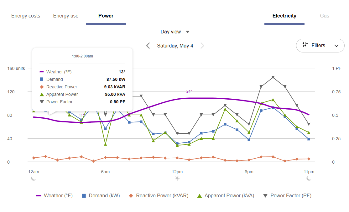

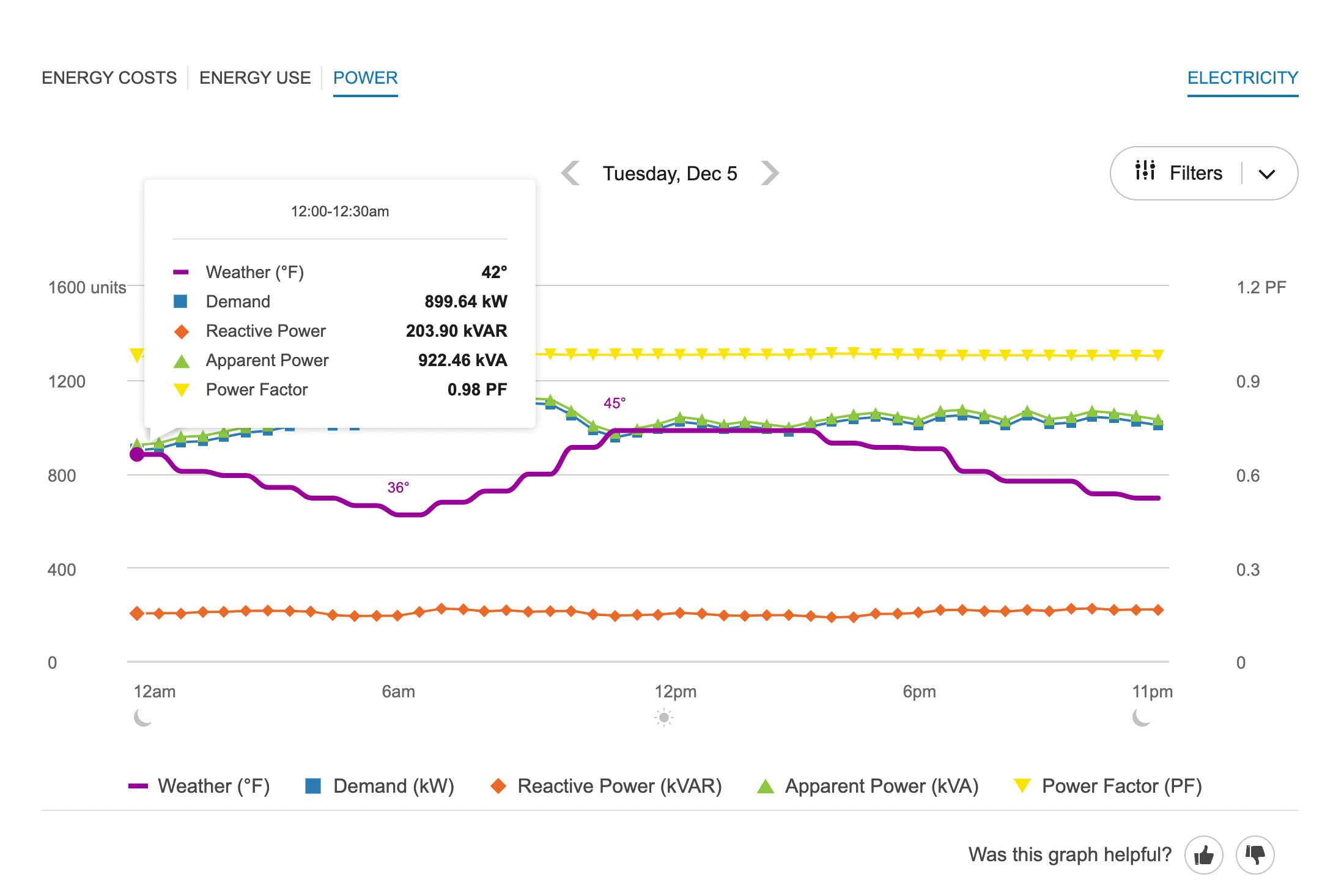

The Power view displays a business customer's demand for a given time period, with tooltips providing the exact values for each data point. The image below shows an example of the Power view for a single day. If the required data is available, the Power view can show data by bill period and by year.
An example of the Power view line graph showing data for weather, demand, reactive power, apparent power, and power factor.

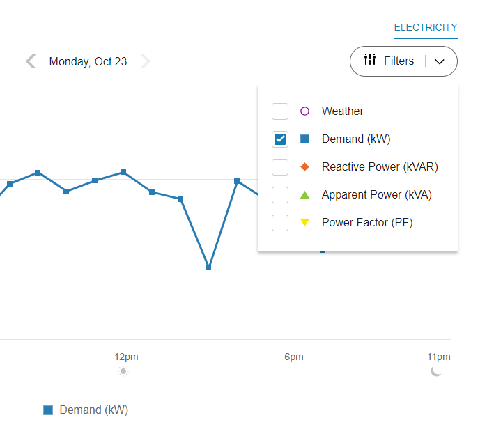

In the Day view only, several different types of power data are available in each interval: Apparent Power, Demand, Power Factor, Reactive Power, and Weather. This helps business customers better understand the energy being used at any given moment for different electrical units of measure.

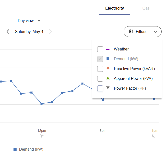

Additionally, business customers can use a Filters menu (only available in the Day view) to enable or disable the display of each data type. If customers select or deselect an item from the list, their selections will be preserved the next time they access the menu or sign in.
Example screenshot of a daily electricity chart showing a line for demand over time. A filters menu is open, allowing selection of different types of data (such as weather, demand, and power factor) for display.
On desktop displays, each data type has a different color-coded shape or icon so it is more easily distinguishable and accessible. On mobile displays, the icons are hidden and color-coded toggles are shown instead.

Tooltips are displayed when customers interact with a data point on the graph. At the day level of the Power view, the tooltip provides the specific units of measure for each type of power, such as kilowatts (kW) for demand data, kilovolt-amperes-reactive (kVAR) units for reactive power data, and so on.
