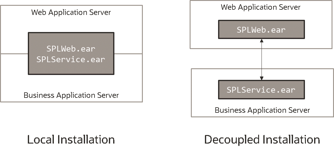

There are two modes of installation:Figure that shows the twio Installation Modes: Local and Decoupled.
• Local Installation (also applicable to expanded installations for Development environments) - The Web application server and Business Application are on the same instance of the JEE Web application server. This is the default behavior of the product for backward compatibility. If this is the mode installed then for configuration the process is a combination of the Web Application Server Configuration and Business Application Server Configuration configuration and deployment process.
Note: Local installations are recommended for all environments.
• Decoupled Installation – The business application server is on a separate instance of the JEE web application server. This may be the same machine or different machines. In this case the Web Application Server Configuration and Business Application Server Configurationare managed and configured separately. To perform a decoupled installation the following must be performed:

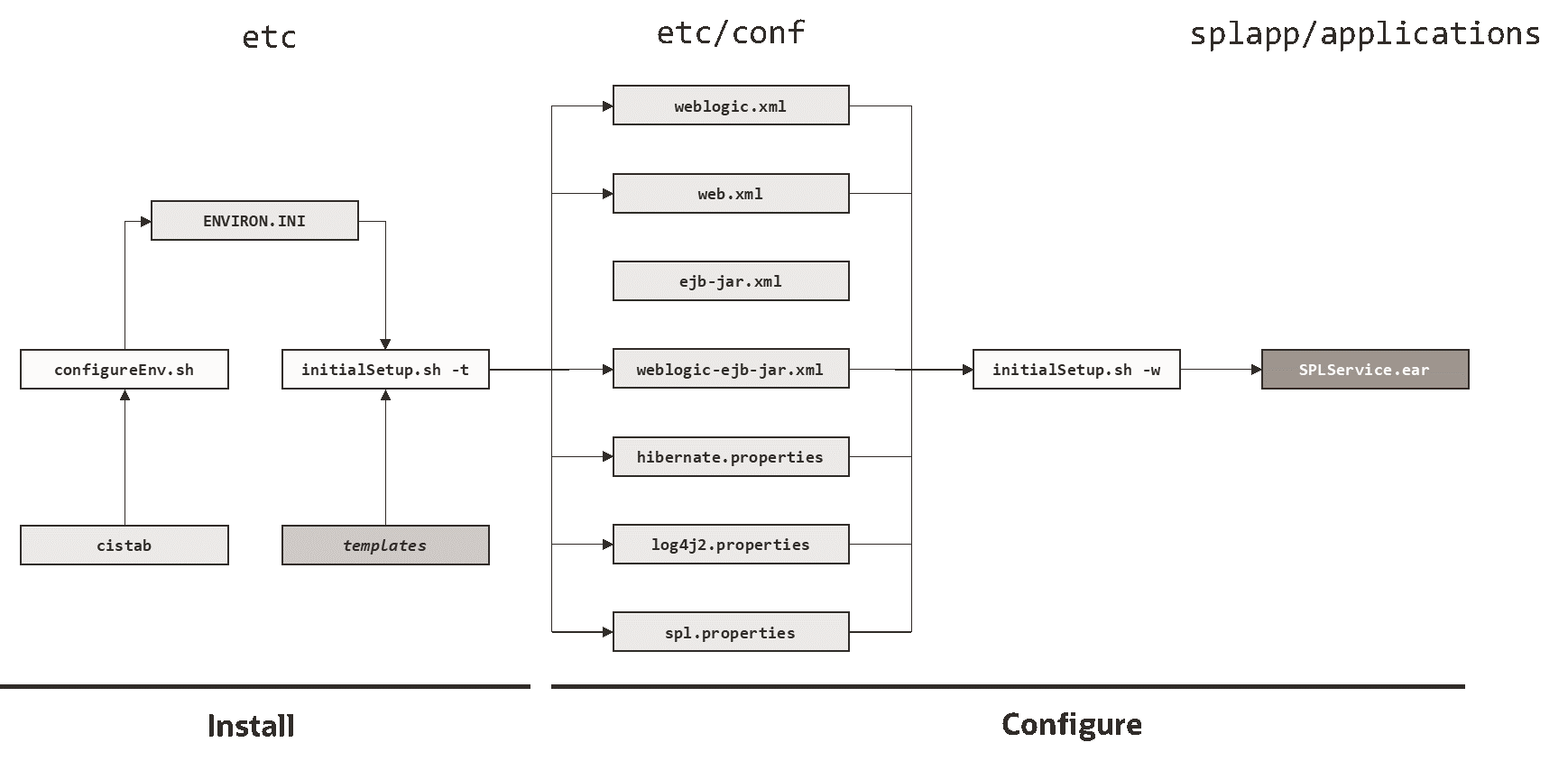

To configure the business application server during the installation process and post-installation then the following process should be used:Figure that shows the structure of the Business Application Server Configuration Process.
• The configureEnv – Set up Environment Settings utility is used during installation time and can be used post implementation to set parameters in the ENVIRON.INI. If any parameters are derived or set from the ENVIRON.INI (see the Source column in the relevant section) then the ENVIRON.INI utility should be used to maintain them.
Note: The ENVIRON.INI utility should be used to make ANY changes to the ENVIRON.INI. Manual changes to this configuration file are not recommended.
• After the ENVIRON.INI has been set or altered, the settings must be reflected in the relevant configuration files used by the business application server by running the initialSetup (see initialSetup – Maintain Configuration Settings for details):

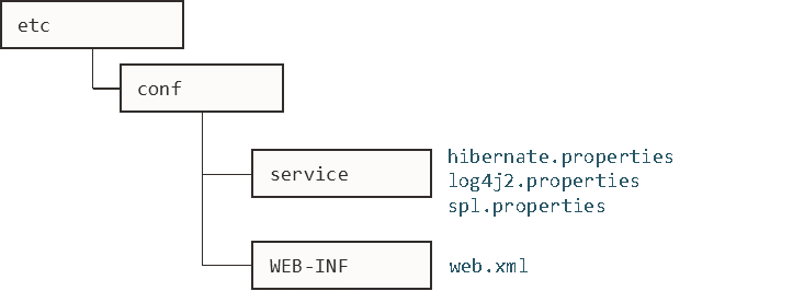

The locations of the configuration files can be summarized in the following figure:Figure that shows the structure of the Business Application Server Configuration files.

• To reflect configuration changes into the product Business EJB Applications the initialSetup utility, with the –w option, must be executed (see initialSetup – Maintain Configuration Settings). This will build the necessary spl-servicebean-<version>.jar (where <version> is the version of the product used) and the SPLService.ear EAR file (or name set by SPLSERVICEAPP - Name of Business Application Server Application) to be deployed into the Oracle Weblogic Domain. This step is optional if configuration overrides are in use (refer the discussion of allowing the externalization of configuration settings for alternative methods).

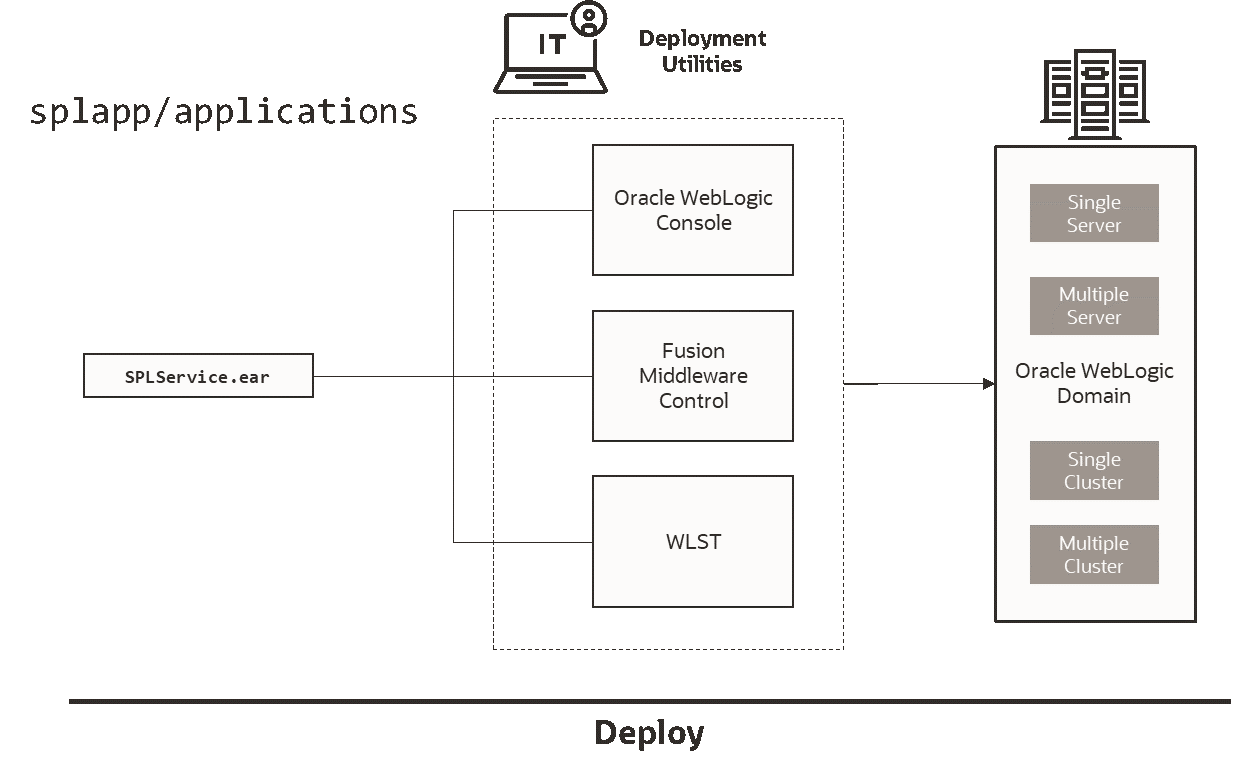

Several specific utilities from Oracle WebLogic are provided with the product to deploy the Web Application to the domain.Figure that shows the structure of the Business Application Server Deployment process.
• Use the WebLogic console, Fusion Middleware Control or WLST to deploy/redeploy the EAR files.
