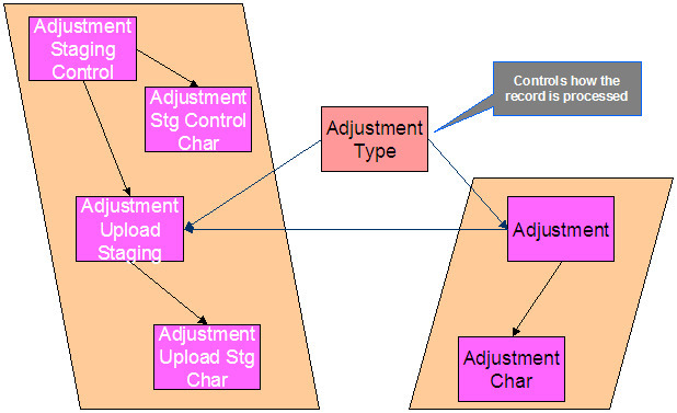

The background process (C1-ADUP2) creates adjustments for all adjustment upload staging records that are stamped with an SA ID.
The following diagram and section describe, at a high level, the processing done in the C1-ADUP2 background process.
