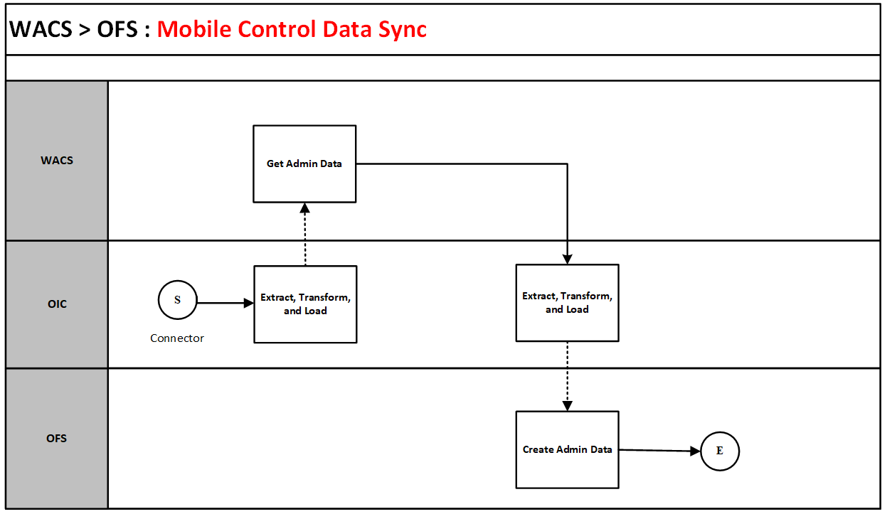

The integration scope supports the following business processes:
Mobile Control Data Sync (Oracle Utilities Work and Asset Cloud Service Initiated)
This integration process is used to sync the control data from Oracle Utilities Work and Asset Cloud Service to Oracle Field Service. It also creates the work skill related configurations needed in Oracle Field Service to match activities with resources and for crew tracking. It is run on initial installation or on a need only basis when new control data from Oracle Utilities Work and Asset Cloud Service or work skill related configurations needs to be created or updated in Oracle Field Service.
The following diagram shows a graphical representation of the Mobile Control Data Sync integration process. A graphical representation of Mobile Control Data Sync integration process.
Business Processing
This synchronous integration process includes the following activities:
1. Oracle Utilities WACS OFSC Admin Data Sync deployed on Oracle Integration Cloud is run to retrieve the control data from Oracle Utilities Work and Asset Cloud Service needed in the Oracle Field Service application. This includes codes and descriptions of selected admin entities, characteristic type valid values and extendable lookup values. It also includes craft, equipment and other direct changes, whose resource type is internal, needed to support timesheet and resource usage.
The integration is enhanced to allow skipping the sync for some properties based on the category. Control data from Oracle Utilities Work and Asset Cloud Service have three categories, controlDataEntities, resourceTypes and workClass. The properties controlDataEntities.default and resourceTypes.default in WAMOFSC_ConfigProps lookups can be used to control this sync based on flag values (default set to “yes”). WorkClass will be synced by default.
Note: Once a resource is created in Oracle Utilities Work and Asset Cloud Service, the resource code (craft code, equipment code and other resource code) cannot be changed. This sync integration process uses the resource codes to create the enumeration values for equipment, craft and other resource property in Oracle Field Service. Slash (/) also cannot be part of the resource code and special characters like '&', '>', and '<' cannot be part of craft code.
2. Run this integration sync process manually from Oracle Integration Cloud by scheduling the integration process to run on a scheduled date or selecting Submit Now from the menu of the activated sync integration process to initiate an instance of the integration. An optional language parameter can be entered to determine the description to retrieve from Oracle Utilities Work and Asset Cloud Service and to know in which language code the property name should be created in Oracle Field Service. The language parameter entered should be an ISO 2 letter language code; if the language parameter is not populated or blank, it is defaulted to English (en).
3. It populates the enumeration values for the following Oracle Field Service properties:
Craft
Crew Shift Types
Downtime Reason
Equipment Type
Labor Earning Type
Measurement Meter Reason
Measurement Gauge Reason
Other Resource Type
Overtime Type
Resource Unit of Measure
Pickup Work Class
Pickup Work Category
Pickup Work Type
Pickup Work Priority
Pickup Location Type
Stock Item Category
Material Unit of Measure
Activity Type To PSH
The enumeration values are obtained from the corresponding Oracle Utilities Work and Asset Cloud Service admin information.
OFS Property Label
Synced WACS Information
wam_craft
Craft
wam_crew_shift_type
Crew Shift Type
wam_downtime_reason
Downtime Reason
wam_equipment_type
Equipment
wam_labor_earning_type
Labor Earning Type
wam_measurement_gauge_reason
wam_measurement_meter_reason
wam_other_resource_type
Other Resource
wam_overtime_type
Overtime Type
wam_resource_uom
Unit of Measure-Resource
wam_work_class
Pickup Work Class
wam_work_category
wam_work_type
Pickup Work Type
wam_work_priority
wam_pickup_location_type
wam_material_stockitemCategory
Stock Item Category
wam_material_uom
wam_actType_psh
Note: If admin data is deleted in Oracle Utilities Work and Asset Cloud Service, the enumeration value will not be deleted in Oracle Field Service. The sync integration process cannot delete enumeration values added to a property in Oracle Field Service; the OFSC REST API that updates the enumeration values of a property does not allow it. The only way to delete an enumeration value(s) in a property is by deleting the property, recreating the property, and run the sync to get the latest values.
4. It creates a work skill and work skill property for each craft retrieved from Oracle Utilities Work and Asset Cloud Service.
The label format for Work Skill created in Oracle Field Service is:
W_ + WAM craftcode
Example: Label is W_Carpenter
The label format for Work Skill property created in Oracle Field Service is:
W_ + WAM craftcode + _Nd
Example: Work Skill Property Label is W_Carpenter_Nd
The name format for Work Skill property created in Oracle Field Service is:
WAM Craft Code Description + value of property workSkillProperty.nameSuffix.default from WAMOFSC_ConfigProps Lookup.
Example: WAM Craft Code description is Carpenter. workSkillProperty.nameSuffix.default value is needed. Work Skill Property Name is Carpenter Needed.
5. It also creates the work skill conditions based on the craft and the property value of workSkillCond.actvtySameSkillMaxWorker.default from WAMOFSC_ConfigProps Lookup.
In this example: For work skill = Carpenter and workSkillCond.actvtySameSkillMaxWorker.default = 3, there will be 3 work skill conditions created.
6. It also syncs the activity types from Oracle Utilities Work and Asset Cloud Service to Oracle Field Service. Activity types define the categories of the activity supported by Oracle Field Service (in this case, Oracle Utilities Work and Asset Cloud Service Integration to Oracle Field Service). If any Activity type already exists in Oracle Field Service, it is skipped from syncing to avoid overriding of Activity type settings in Oracle Field Service.
7. If a technical fault is encountered, when Oracle Utilities Work and Asset Cloud Service or Oracle Field Service is down, it will stop the process and send an optional email notification with error details to the users configured in the WAMOFSC_Email_ID lookup.
8. If any error occurs in the flow when creating or update the record(s) in Oracle Field Service, it will continue the process and send an email notification to the users configured in the WAMOFSC_Email_ID lookup of what record was not created/updated.
9. Email notification is optional. Configure the property name email.flag in the WAMOFSC_ConfigProps Lookup to true to receive email notification when errors are encountered.

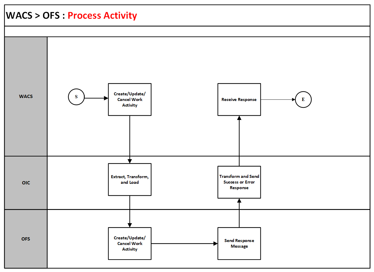

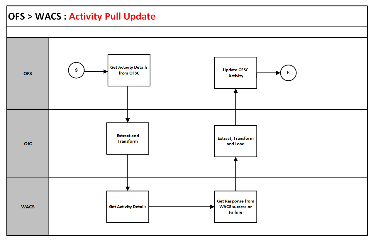

Process Activity (Oracle Utilities Work and Asset Cloud Service Initiated)
This integration process is used to accept request from Oracle Utilities Work and Asset Cloud Service to create, update, or cancel activities in Oracle Field Service. The activity details message also include the list of issued assets if any. The information is sent synchronously from Oracle Utilities Work and Asset Cloud Service, regardless of the activity type, and Oracle Field Service sends back a response.
The following diagram shows a graphical representation of the Process Activity integration process.A graphical representation of the Process Activity integration process.
Business Processing
The integration process includes the following activities:
1. Oracle Utilities Work and Asset Cloud Service sends the create/update/cancel activity request to the Oracle Utilities WACS OFSC Activity Process integration process deployed on Oracle Integration Cloud.
2. If Oracle Utilities Work and Asset Cloud Service sends create or update activity request, the Oracle Utilities WACS OFSC Activity Process transforms the request message from Oracle Utilities Work and Asset Cloud Service to the request message format in Oracle Field Service and invokes bulkUpdate API.
3. Oracle Field Service sends the success or failure response to the integration.
4. If the activity creation is successful in Oracle Field Service, the integration process does the following:
a. Transforms the attachments data from Oracle Utilities Work and Asset Cloud Service (if any) and invokes “Set File Property” OFSC REST API.
b. Transforms the labor data from Oracle Utilities Work and Asset Cloud Service (if any) and invokes “Update activity” OFSC REST API.
5. Transforms and sends the success/failure response from Oracle Field Service to Oracle Utilities Work and Asset Cloud Service.
6. If Oracle Utilities Work and Asset Cloud Service sends the cancel activity request, the Oracle Utilities WACS OFSC Activity Process transforms the request message from Oracle Utilities Work and Asset Cloud Service to the request message format in Oracle Field Service and invokes bulkUpdate API.
7. Oracle Field Service sends the success or failure response to the integration transformed and sent to Oracle Utilities Work and Asset Cloud Service.
8. Any errors are reported back to Oracle Utilities Work and Asset Cloud Service through the global fault handler.
9. An optional email notification with error details is sent to the users configured in the WAMOFSC_Email_ID lookup.
10. Email notification is optional. Configure the property name email.flag in the WAMOFSC_ConfigProps Lookup to true to receive email notification when errors are encountered.
Technical Details
The following table describes the integration processes and the respective Oracle Utilities Work and Asset Cloud Service and Oracle Field Service artifacts used in this integration process.
Artifacts
Value
OFSC BO/Operation
Activity / Bulk Update Activity
Activity / Set File Property
Activity / Update activity
OFSC API
bulkUpdate
WACS BO
W1-WOActivityActiveOutboundMsg
Integration Process Name
Integration Package Name
outl.ba.wacs.ofsc.01.22.1000.par

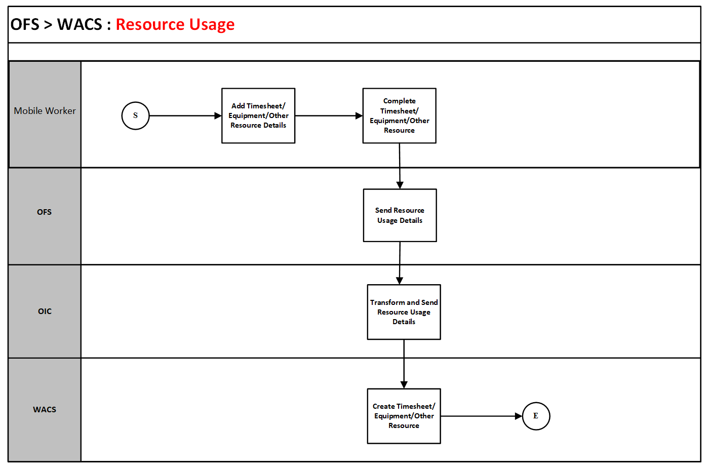

Resource Usage (Oracle Field Service Initiated)
This integration process is used to send the resource usage details from Oracle Field Service to Oracle Utilities Work and Asset Cloud Service. Oracle Field Service sends the details either before the completion or after the completion of the activity.
The following diagram shows a graphical representation of the Resource Usage integration process. A graphical representation of the Resource Usage integration process
Business Processing
1. Oracle Field Service sends the resource usage details that can include either the individual time sheet or crew time sheets by supervisor or equipment usage or other equipment usage to the Oracle Utilities OFSC WACS Resource Usage Details integration process deployed on Oracle Integration Cloud.
2. The Oracle Utilities OFSC WACS Resource Usage Details process transforms the message from Oracle Field Service to the message format in Oracle Utilities Work and Asset Cloud Service and invokes the W1-IntTMSDtl inbound web service if its individual time sheet or crew time usage submitted by supervisor or invokes the W1-IntODCDtl inbound web service if its equipment usage or other equipment usage information.
3. Any errors are captured through the global fault handler.
4. An optional email notification with error details are sent to the users configured in the WAMOFSC_Email_ID lookup.
5. Email notification is optional. Configure the property name email.flag in the WAMOFSC_ConfigProps Lookup to true to receive email notification when errors are generated.
Technical Details
Artifacts
Value
OFSC Entity
Custom Plugin : Resource Usage
WACS SOAP IWS
W1-IntTMSDtl
W1-IntODCDtl

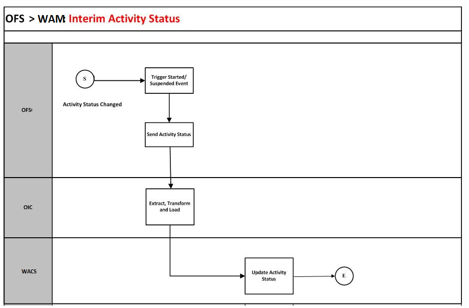

Interim Status Updates (Oracle Field Service Initiated)
This integration process is used to send the interim status details of the Work Activity from Oracle Field Service to Oracle Utilities Work and Asset Cloud Service. Oracle Field Service sends the details before the completion of the activity.
The following diagram shows a graphical representation of the Interim Status Updates integration process. A graphical representation of the Resource Usage integration process
Business Processing
1. Oracle Field Service sends the interim activity status to the Oracle Utilities OFSC WACS Activity Interim Status integration process deployed on Oracle Integration Cloud.
2. Any errors are caught in the global fault handler.
3. An optional email notification with error details are sent to the users configured in the WAMOFSC_Email_ID lookup.
Technical Details
Artifacts
Value
OFS Events
Activity Started
Activity Suspended
WACS SOAP IWS
W1-UpdateActivityStatus

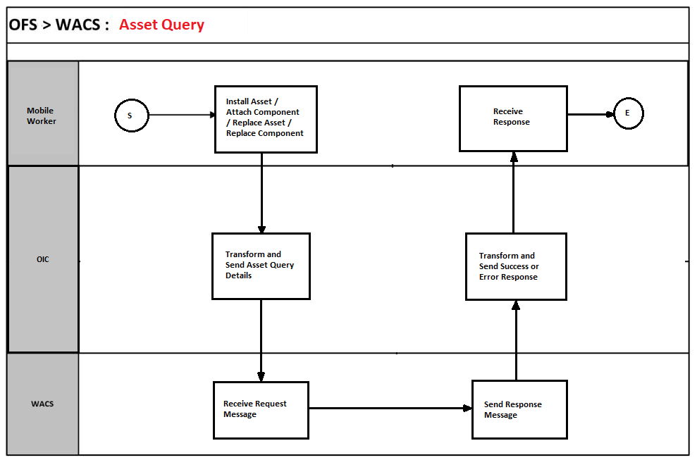

Asset Installs and Removals (Oracle Field Service Initiated)
This integration process is used to perform various operations from Oracle Field Service to Oracle Utilities Work and Asset Cloud Service. Oracle Field Service sends the details either before the completion or after the completion of the activity.
These operations can be performed on Assets and Components using the Asset Query Integration flow.
Install Asset
Attach Component
Replace Asset
Replace Component
The following diagram shows a graphical representation of the Asset Installs and Removals integration process. A graphical representation of the Resource Usage integration process
The following operations can be performed on Assets and Components from Oracle Field Service, independent of the Asset Query Integration process.
Asset Removal
Asset Out of Service
Component removal
Undo Install
Undo Remove
Undo Attach
Undo Replace
Back to Service

1. For Install Asset, Attach Component, and Replace operations, Oracle Field Service sends the Asset Query details which include Asset ID, Badge Number, and location ID to the Oracle Utilities OFSC WACS Asset Query integration process deployed on Oracle Integration Cloud.
2. The Oracle Utilities OFSC WACS Asset Query process transforms the message from Oracle Field Service to the message format in Oracle Utilities Work and Asset Cloud Service and invokes the W1GAstDtlBNo inbound web service.
3. Oracle Utilities Work and Asset Cloud Service responds with all the asset details if the call is successful, else it responds with an error message. If the response succeeds, the installed asset/attached component moves to the installed pool. When an asset or component is replaced, the replaced asset or component moves to the deinstalled pool.
4. Remove and Out of Service operations are directly performed in Oracle Field Service. After performing these operations, the asset moves to deinstalled pool.
5. Every operation on the Asset or Component can be undone using their corresponding Undo operations.
6. The data about the performed operations is sent from Oracle Field Service to Oracle Utilities Work and Asset Cloud Service after activity completion.
7. Any errors are captured through the global fault handler.
8. An optional email notification with error details are sent to the users configured in the WAMOFSC_Email_ID lookup.
9. Email notification is optional. Configure the property name email.flag in the WAMOFSC_ConfigProps Lookup to true to receive email notification when errors are generated.
Technical Details
Artifacts
Value
OFSC Entity
Custom Plugin: Asset Component Install Exchange Undo
WACS SOAP IWS
W1GAstDtlBNo

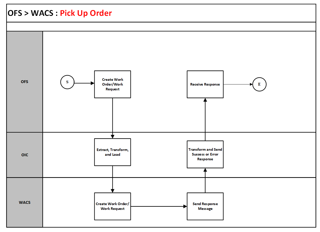

Pick Up Order (Oracle Field Service Initiated)
This integration process is used to perform various operations including creation of Work Order and Work Request from Oracle Field Service to Oracle Utilities Work and Asset Cloud Service. For querying assets invoke the Oracle Utilities OFSC WACS Asset Query integration flow providing badge number/location type as the search criteria from Oracle Utilities Work and Asset Cloud Service.
The following diagram shows a graphical representation of the Pick Up Order integration process. A graphical representation of the Resource Usage integration process
Business Processing
1. Oracle Field Service sends the work order create activity to Oracle Utilities OFSC WACS Work Order integration process deployed on Oracle Integration Cloud.
2. Oracle Field Service sends the work request create to Oracle Utilities OFSC WACS Work Request.
Technical Details
Artifacts
Value
OFSC Entity
Custom Plugin: pickUpWork
WACS SOAP IWS
W1-CreateMobileWorkOrder
W1-CreMoblWR
W1-AssetQuery
W1-GetAssetLocationDetails

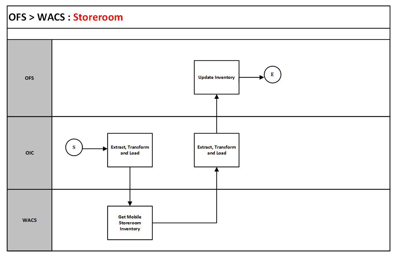

Truck Storeroom Inventory Snapshot Sync/Update (Oracle Field Service Initiated)
This integration process is used to sync inventory of each storeroom in Oracle Utilities Work and Asset Cloud Service into Oracle Field Service. The truck storeroom inventory can be sync in multiple ways:
Option 1: Storeroom Sync on Route Activation
On route activation of a crew or an individual, check if there are any trucks associated with that crew or an individual. Then, sync the initial storeroom inventory.
The following Oracle Integration Cloud integration processes are involved to achieve this functionality:
Oracle Utilities OFSC WACS Route Activation
The following diagram shows a graphical representation of the Oracle Utilities OFSC WACS Route Activation integration process. A graphical representation of the Resource Usage integration process
Business Processing
1. Oracle Field Service invokes Oracle Utilities OFSC WACS Route Activation process deployed on Oracle Integration Cloud when the “Route Activated” business event occurs (when a crew or an individual's route is activated in Oracle Field Service).
2. Integration process invokes “Resource Types” OFSC REST endpoint to get the resource type using REST Adapter.
3. If resource type is CR (Crew) or PR (Person), invoke OFSC “Resource” business object to get more details about the resource using Oracle Field Service adapter.
4. Invoke “Activity” OFSC business object to get all activities and check if this is a teamResourceId using the Oracle Field Service adapter. If the response is not empty, form a list of allresourceIds.
5. For each unique resourceId from the above list, invoke the “Resource” OFSC business object to get the resource information.
a. If resource type is 'TR' and resource source is 'WACSTR' invoke Oracle Utilities OFSC WACS Storeroom Sync integration process with input parameters resourceId, resourceType and lastSyncDateTime as empty.
6. Else, process the next resource.
7. Any errors are captured through global fault handler.
Technical Details
Artifacts
Value
OFSC BO/ Operation
Resource/Get Resource
Activity/Get Activities
OFSC REST URI
URI: /rest/ofscMetadata/v1/resourceTypes
Method: GET
Target OIC integration process name
The following diagram shows a graphical representation of the Oracle Utilities OFSC WACS Storeroom Sync integration process.
Business Processing
1. Oracle Utilities OFSC WACS Storeroom Sync integration process is invoked by another integration process and it takes these three input parameters: resourceId, resourceType and lastSyncDateTime.
2. If the resource type is 'TR' invoke W1-MobileStoreroomInventory WACS IWS to get the details of the resource using Oracle Utilities adapter.
3. If lastSyncDateTime is empty:
a. Transform the data from Oracle Utilities Work and Asset Cloud Service to Oracle Field Service format.
b. Invoke “bulkUpdateInventories” OFSC REST API to sync the truck storeroom inventory.
Note: If lastSyncDateTime is empty, initial sync.
4. If lastSyncDateTime is not empty:
a. Invoke “Resource” OFSC business object to get resource inventory of a particular resourceId using the Oracle Field Service adapter.
b. For each inventory entry from Oracle Utilities Work and Asset Cloud Service, check if the inventory exists in the list returned from Oracle Field Service in the above call.
a. If it exists in the list, then get the quantity retrieved from Oracle Field Service for this inventory and add or remove the quantity from Oracle Utilities Work and Asset Cloud Service and create a new entry for the new request to be made to Oracle Field Service bulkUpdateInventories.
b. If it does not exist in the list, add it to bulkUpdateInventories.
c. Invoke bulkUpdateInventories OFSC REST API with the new bulkUpdateInventory.
d. Invoke Resource OFSC BO for the resource merging existing inventory details with latest from Oracle Utilities Work and Asset Cloud Service.
5. Any errors are captured through global fault handler.
6. An optional email notification with error details are sent to the users configured in the WAMOFSC_Email_ID lookup.
7. Email notification is optional. Configure the property name email.flag in the WAMOFSC_ConfigProps Lookup to true to receive email notification when errors are encountered.
Technical Details
Artifacts
Value
OFSC BO/ Operation
Resource / Update Resource
OFSC REST URI
URI: /rest/ofscCore/v1/resources/custom-actions/bulkUpdateInventories
Method: POST
WACS SOAP IWS
Option 2: Scheduled Storeroom Sync
Batch scheduled from Oracle Integration Cloud to run at a specific time of day/week/month to run snapshot sync of all trucks synced between Oracle Utilities Work and Asset Cloud Service and Oracle Field Service.
Oracle Utilities WACS OFSC Schedule Storeroom Sync
The following diagram shows a graphical representation of the Oracle Utilities WACS OFSC Schedule Storeroom Sync integration process.
Business Processing
1. Oracle Utilities WACS OFSC Schedule Storeroom Sync is a batch process deployed on Oracle Integration Cloud and scheduled to run on a regular basis or as needed basis or turned off.
2. Integration process invokes Oracle Field Service to get the list of resources that are descendants of the respective Oracle Field Service bucket configured in the system.
3. For each descendant check if the resource type of “TR” and “wam_resource_source”: “WACSTR”
4. If the resourcetype is truck, invoke Oracle Utilities OFSC WACS Storeroom Sync OIC integration process with the resourceId, resourceType and lastUpdatedDateTime as empty as input parameters.
Technical Details
Artifacts
Value
OFSC REST URI
URI: /rest/ofscCore/v1/resources/OHMeter/descendants
Method: GET
For information about the Oracle Utilities OFSC WACS Storeroom Sync integration process, refer to the Oracle Utilities OFSC WACS Storeroom Sync section.
Activity Pull Update (Oracle Field Service Initiated)
This integration process can be initiated by the crew from Oracle Field Service to pull the latest activity details including issued assets for which a material request was issued on the activity in Oracle Utilities Work and Asset Cloud Service.
The following diagram shows a graphical representation of the Activity Pull Update integration process. A graphical representation of the Resource Usage integration process
Business Processing
1. Oracle Utilities OFSC WACS Activity Pull Update is an event based process deployed on Oracle Integration Cloud.
2. Oracle Field Service fetches the work activity details using “Get activity” OFSC BO. Transforms the request message from Oracle Field Service Cloud to request message for Oracle Utilities Work and Asset Cloud Service and invokes W1- WOActivityDetails inbound web service.
3. Transform the response from Oracle Utilities Work and Asset Cloud Service to request message for Oracle Field Service and invoke “Bulk Update Activity” OFSC BO.
4. Any errors are captured through the global fault handler.
5. An optional email notification with error details are sent to the users configured in the WAMOFSC_Email_ID lookup.
6. Email notification is optional. Configure the property name email.flag in the WAMOFSC_ConfigProps Lookup to true to receive email notification when errors are generated.
Technical Details
Artifacts
Value
OFS BO/Operation
Activity/Get Activity
Activity/Bulk Update Activity
WACS SOAP IWS
W1-WOActivityDetails
