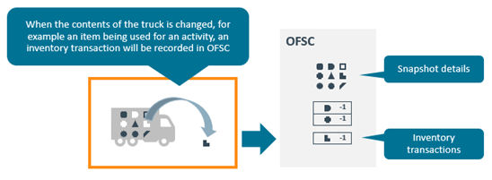

A crew can install assets and use material from their trucks for the activities they are working on. These truck inventory transitions are recorded in Oracle Field Service.
The content of the truck is the combination of the last mobile storeroom snapshot and the inventory transactions that have occurred since the last snapshot.

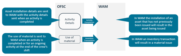

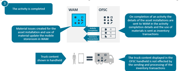

On activity completion and at the end of crew shift the use of assets and materials is sent to Oracle Utilities Work and Asset Management and the inventory of the mobile storeroom linked to the truck is updated.

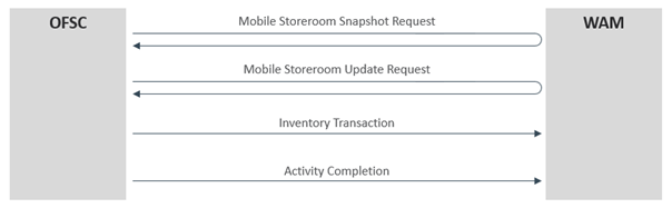

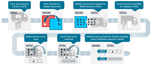

The following diagram represents integration flows for mobile inventories movement:
Truck Materials Lifecycle Examples
This section describes various truck materials lifecycle examples.
Snapshot at the start of the shift
Items used in the field
Oracle Utilities Work and Asset Management updated with item use
 Truck Storeroom Admin Sync

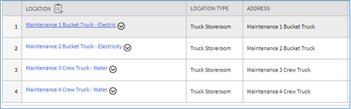

The following figure shows the truck storerooms in Oracle Utilities Work and Asset Cloud Service.
