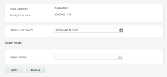

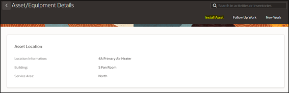

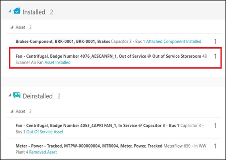

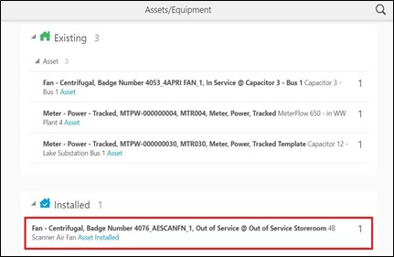

Installing Assets
To install an asset:
1. Start the activity.
2. To install an asset, click the location.
3. Click Install Asset.
4. Enter the Badge Number of the asset to be installed in this location and click Install.
The newly installed asset is shown in the Installed pool.

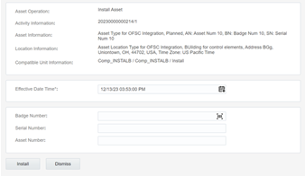

Installing Assets for Construction Work Activity
To install an asset for construction work activity:
2. Select the location where the asset should be installed and click Install Asset.
3. The Badge Number, Serial Number, and Asset Number fields should be displayed and validated based on the value of the corresponding assetNoControl, badgeNoControl, and serialNoControl elements.
• W1NP (Not Present): This field should not be included on the page.
• W1DO (Display Only): This field should be present but display only.
• W1OP (Optional): This field should be present and the value should be editable. When the entered details are validated, if the value is blank, no error should occur.
• W1RQ (Required): This field should be present and the value should be editable. When the entered details are validated, if the value is blank, an error should occur.
The new asset installed is shown in the Installed pool.

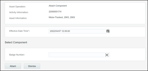

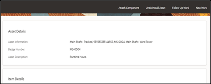

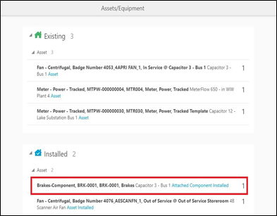

Attaching Components
To attach a component:
2. To attach a component, click the asset.
3. Click Attach Component.
4. Enter the Badge Number of the component to be attached and click Attach.
The attached component is shown in the Installed Pool.

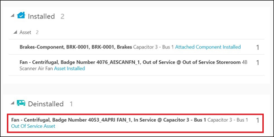

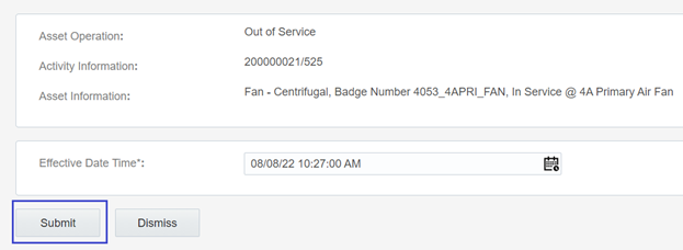

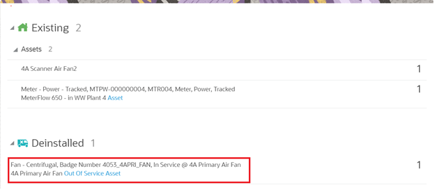

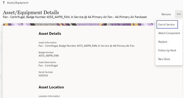

Moving Assets Out of Service
To move an asset out of service:
2. To move an asset out of service, click the asset.
3. Click Out of Service.
4. Enter the Effective Date/Time and click Submit.
The asset moves to ‘out of service’ status in the Deinstalled pool.

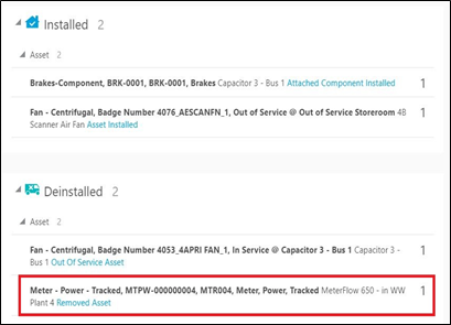

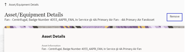

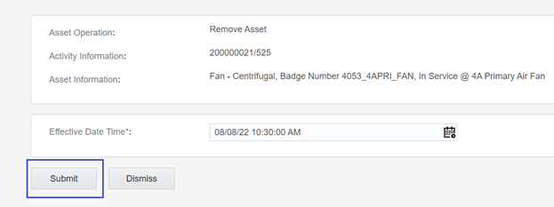

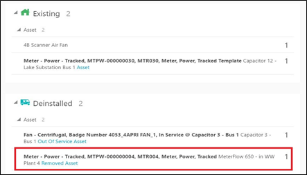

Removing Assets or Components
To remove an asset/component:
2. Click the asset or component to be removed.
3. Click Remove.
The asset or component is removed and moved to the
Deinstalled pool.

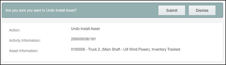

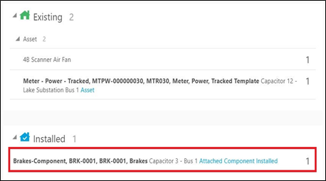

Undoing Installations
To undo the installation:
1. To undo an installation, click the newly installed asset in the Installed pool.
2. Click Undo Install Asset.
3. Click Submit.
The asset or component installation is undone and it disappears from the Installed pool.

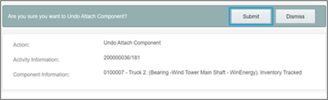

Undoing Newly Attached Components
To undo a newly attached component:
1. To undo attach, click the newly attached component in the Installed pool.
2. Click Undo Attach Component.
3. Click Submit.
The attach operation is undone and the component disappears from the Installed pool.

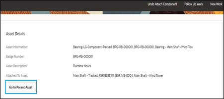

Navigating to Parent Assets
To navigate to the parent asset:
1. Click the newly attached component in the Installed pool.
2. Click Go to Parent Asset and proceed to the parent asset to which the component is attached.

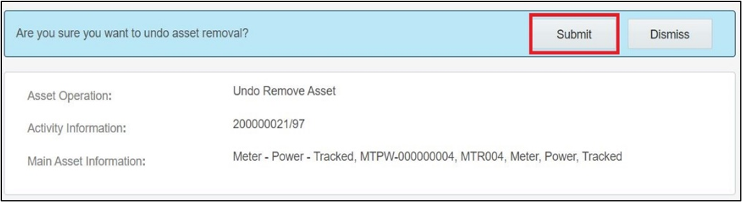

Undoing Asset Removals
To undo an asset removal:
1. Select the removed asset.
2. Click Undo Remove.
3. Click Submit.
The removal is undone and asset disappears from the Deinstalled pool.

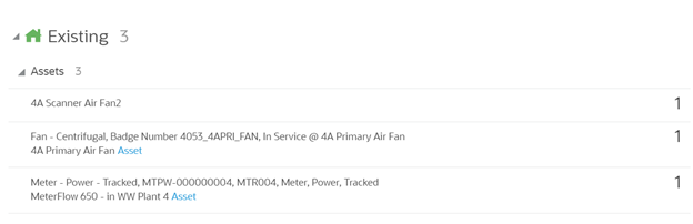

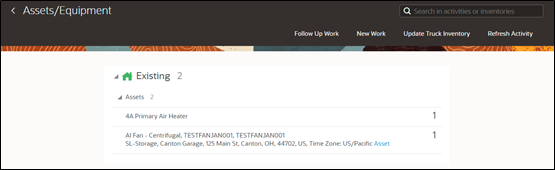

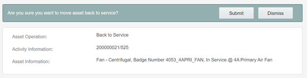

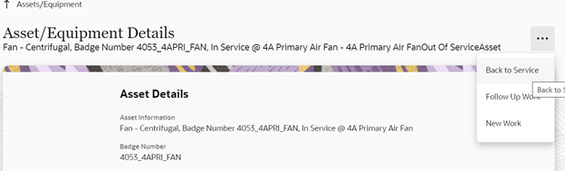

Moving Assets Back to Service
To move an asset back to service:
1. Click Asset in Out of Service.
2. Click Back to Service.
3. Click Submit.
The asset moves to the Existing pool.

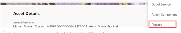

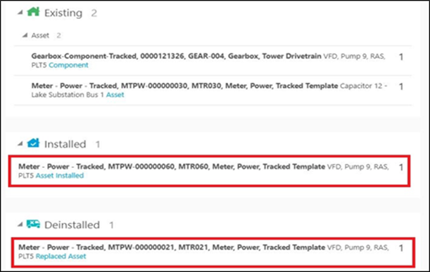

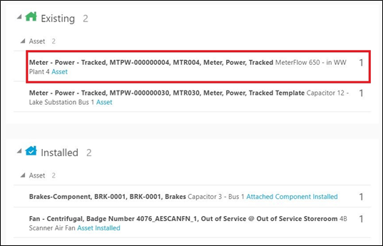

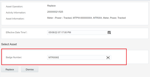

Replacing Assets
To replace an asset:

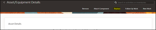

1. Select the asset that needs to be replaced.
2. Click
Replace.
3. Enter the badge number of the asset to be replaced with and click Replace.
The new asset moves to the Installed pool and the replaced asset moves to the Deinstalled pool.

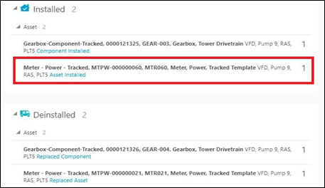

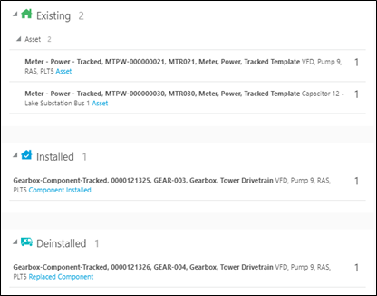

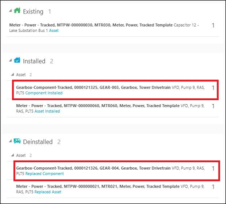

Replacing Components
To replace a component:
1. Select the component to be replaced.
2. Click Replace.
3. Enter the badge number of the replacing component and click
Replace.
The replaced component moves to the Deinstalled pool and the newly attached component moves to the Installed pool.

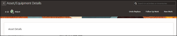

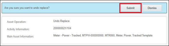

Undoing Asset Replacements
To undo replace an asset:
1. Click Installed Asset/Component.
2. Click Undo Replace.
3. Click Submit.
The replaced asset moves back to Existing pool.
4. Repeat the above steps to undo replace for a component.

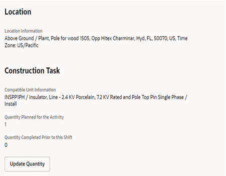

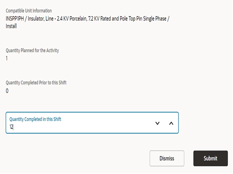

Update Quantity in Construction Work Activity
Field worker can update any extra quantity of equipment that is required apart from the planned quantity and quantity completed is divided into two fields Quantity Completed prior to this shift (sum of previous segments quantity for multiday activities and 0 for normal activity) and Quantity completed in this shift.
