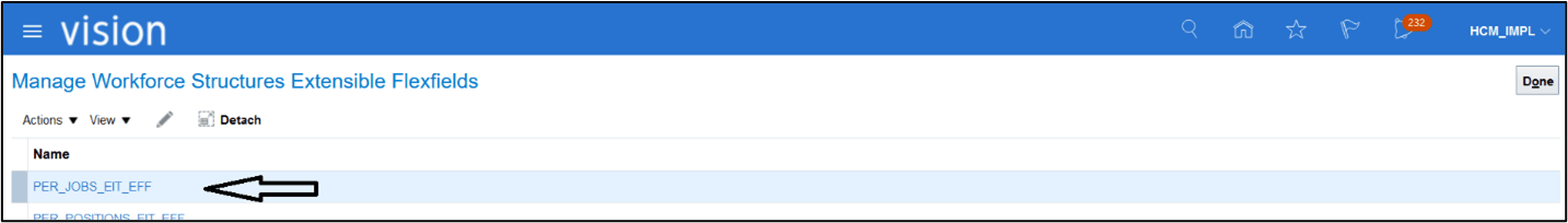

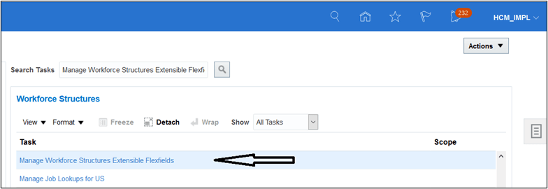

1. Navigate to Setup and Maintenance > Search.

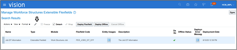

2. Click Manage Workforce Structures Extensible Flexfields.Search Tasks page where Manage Workforce Structures Extensible Flexfields result is being pointed to.
3. Click PER_JOBS_EIT_EFF.Manage Workforce Structures Extensible Flexfields page where PER_JOBS_EINT_EFF option is being selected.
4. Click the pencil icon to edit.PER_JOBS_EINT_EFF view on the Manage Workforce Structures Extensible Flexfields page. The pencil icon to edit is the fourth element from left to right under Search Results.
5. On the Manage Workforce Structures Extensible Flexfields edit view, click Manage Contexts.Manage Workforce Structures Extensible Flexfields edit view. The Manage Context button is the fourth and last element from right to left on the upper right corner of the page.
6. Click the add button (+).Manage Contexts page. The add button is the fourth element from left to right on the first row under Search Results section.

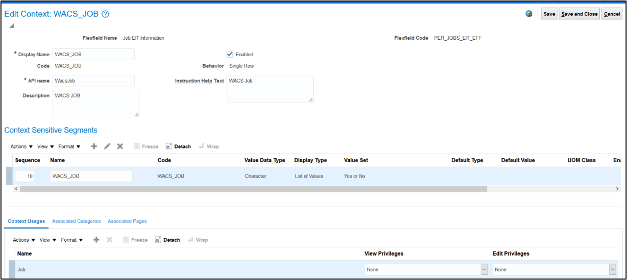

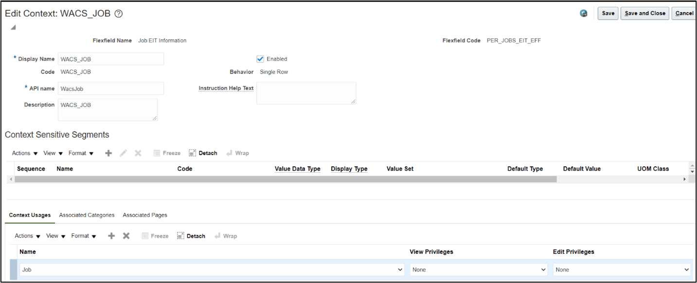

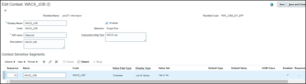

7. Add Context Usage and Add Context Sensitive Segments.
Flexfield Name: Job EIT Information
Flexfield Code: PER_JOBS_EIT_EFF
Display Name: WACS_JOB
Code: WACS_JOB
API name: WacsJob
Description: WACS JOB
Enabled: YES
Instruction Help Text: WACS JobEdit Context page showing the Context Sensitive Segments section and the Context Usage tab.
8. Click Save.Edit Context page showing the Context Sensitive Segments section and the Context Usage tab. The Save button is the third element from right to left on the upper right corner of the page.

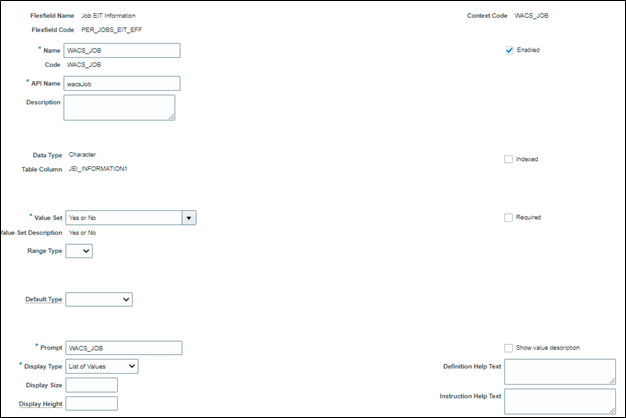

9. Navigate to Context Sensitive Segments and click the add button (+) to add a segment. Fill the data as shown below.
Code: WACS_JOB
API Name: wacsJob
Data Type: Character
Value Set: Yes or No
Prompt: WACS_JOB
Display Type: List of Values
BI Enabled: YesContext Sensitive Segments add view with the text fields to be populated in accordance with the above instruction.
10. Click Save and Close. Edit Context page. The Save and Close button is located on the upper right corner.

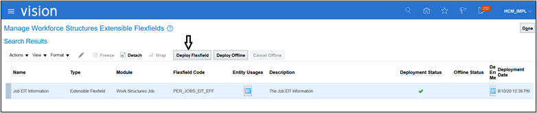

14. Deploy Flexfield as shown below and make sure that the deployment status is highlighted in green.Manage Workforce Structures Extensible Flexfields page. The Deploy Flexfield button is the eight element from left to right on the row immediatly under the Search Results heading.

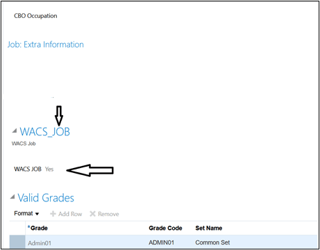

To attach an EFF to a job in ERP:
1. Query any job that needs to be attached. Filter WACS JOB and attach EFF.

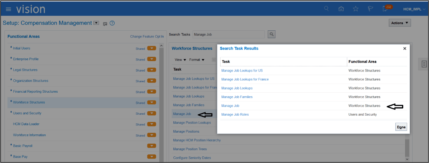

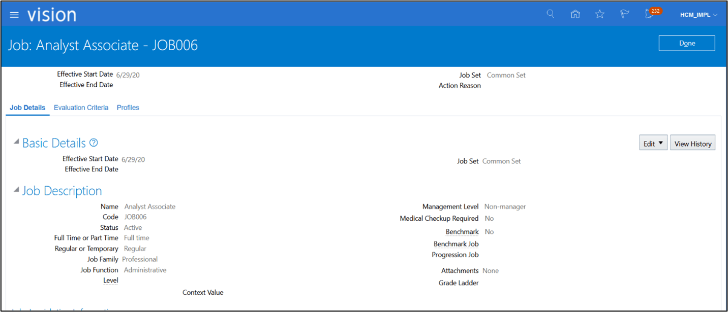

2. Navigate to Setup and Maintenance > Search > Manage Jobs.Search Task Results window that pops up after selecting Manage Jobs. This window displays the different job tasks and their functional areas.
3. Query the Required JOBS.Manage Jobs page showing the Search and Search Results sections. The pencil icon to edit is the fourth element from left to right of the row that is immediatly under the Search Results section.
4. Click the job name and edit it.Job edit view. The Edit button is the second element from right to left within the Basic Details section that is shown when the Job Deitals tab is selected.
5. Click WACS Job and select Yes from the LOV. WACS_JOB section under Job: Extra Information.
6. Click Done.

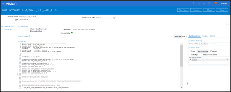

To use the Fast Formula file from the package available for Job extract:

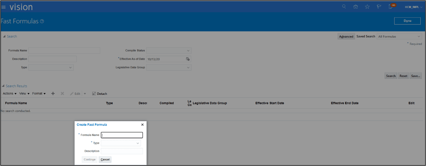

1. Navigate to Setup and Maintenance > Search > Fast Formulas.
2. Enter Formula Name, Type and Description from the package (refer to the accelerator package on Market Place). Click Continue.Fast Formula page showing the Create Fast Formula pop-up window where the mentioned fields are to be populated.
3. Take the text file (HCM_WACS_JOB_RATE_FF.txt) from the accelerator package and paste its code to Fast Formulas.
Formula Name: HCM_WACS_JOB_RATE_FF
Type: Extract Rule
Effective Start Date: 1/1/51
Description: HCM: WACS JOB Rate Calculation
4. Save it and click Compile.Fast Formulas page. The Compile button is the third element from right to left on the upper right corner.
5. Make sure the Compile Status shows a green icon with a check-mark.

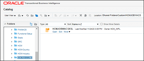

Use the “.xdo.calatalog” file from package to a specified folder: Shared > Custom > HCMJOBWACS
Migrating Reports in Oracle Cloud Instance
The migration process involves un-archiving the report and data model.
To migrate reports in Oracle Cloud Instance:
1. Navigate to Tools > Report and Analytics.
2. Browse to the folder where the report and data model is placed.

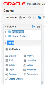

3. Create a “HCMJOBWACS” folder in Shared Folder > Custom Folder (the name cannot change).Detail of the Transactional Business Intelligence catalog showing the Folders navigation pane to the left. My Folders folder is being selected.
4. Use the files in the package with an extension of “xdo.catalog”.
5. Un-archive the report and data model.Detail of the Transactional Business Intelligence catalog showing the Folders navigation pane to the left and the Tasks pane under it. The Unarchive option appears on the right column of the My Folders section under Tasks.
6. Un-archive files in the new instance.
a. Navigate to the folder where the report should be uploaded.
b. Click Unarchive in the Tasks pane.
c. The system prompts to browse and upload the file from your desktop. Make sure to select the “.xdo.catalog” file for the report.Detail of the Transactional Business Intelligence catalog showing the Folders navigation pane to the left. The HCM_JOBWACS folder is being selected.

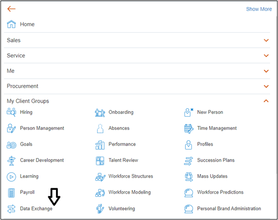

1. Navigate to Tools > Report and Analytics > Data Exchange > HCM Extract.
2. Click Upload and Browse.
3. Upload the extract file “HCM_JOB_WACS”. Home page showing the My Client Groups section where Data Exchange option is to be found.

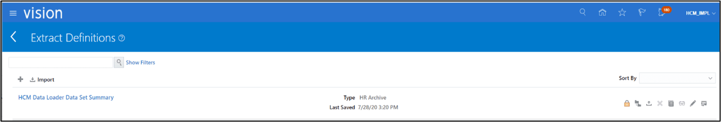

HCM Extracts list where Extract Definitions option is to be found.
Extract Definitions page where the extract file is to be uploaded.

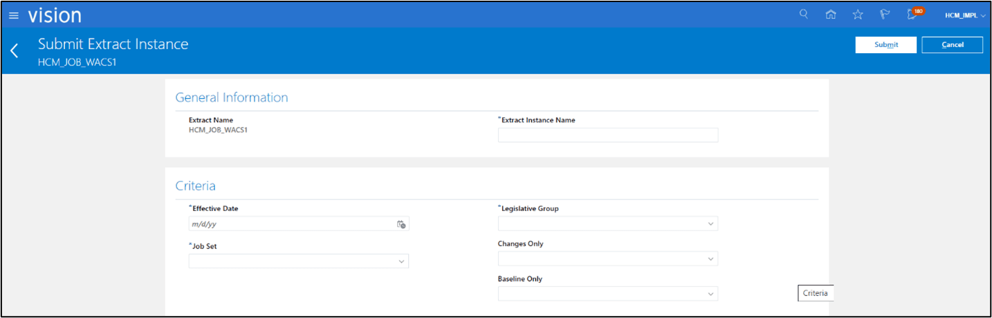

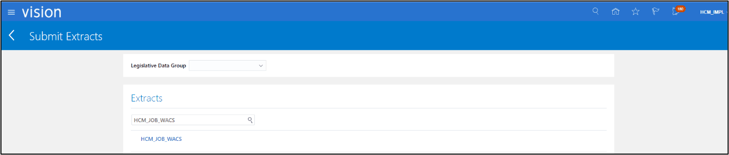

11. On the Submit Extracts page, search for the job extract.Submit Extracts page. The job extract search field is located immeadiatly under the Extracts heading.
12. Click the Extract Name and verify the Legislative Group and Job Set values.Submit Extract Instance page showing the General Information and the Criteria sections. The Job Set and the Legislative Group mandatory fields are under the Criteria section.
