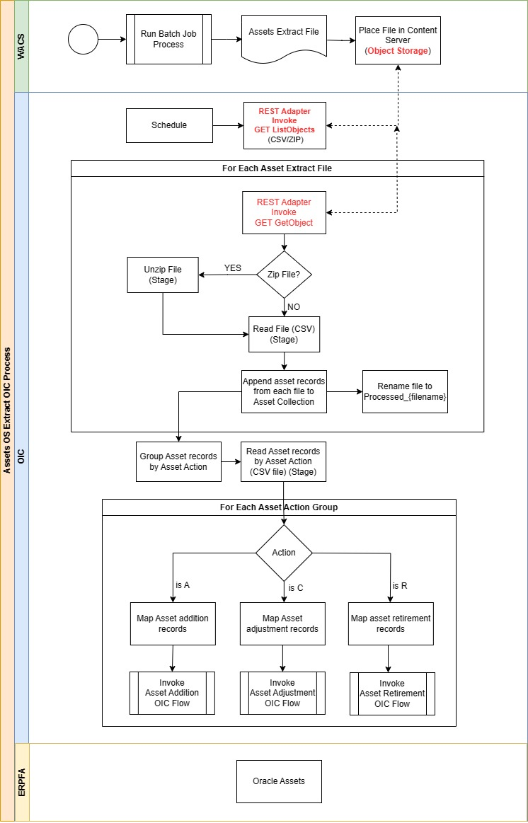

OU WACS ERPFA Assets OS Extract Process (Oracle Utilities Work and Asset Cloud Service Initiated)
This scheduled integration process polls all the Asset Extract files from Oracle Utilities Work and Asset Cloud Service Object Storage (OS) and routes the asset records to the respective addition, adjustment, and retirement integration process based on the action. This process serves as the main/master flow that initiates the Oracle Utilities Work and Asset Cloud Service integration to Oracle Assets when Oracle Utilities Work and Asset Management/Oracle Utilities Work and Asset Cloud Service is on cloud.
The following diagram shows a graphical representation of the OU WACS ERPFA Assets OS Extract integration process:
Shows a graphical representation of the OU WACS ERPFA Assets OS Extract integration process.
Processing Details
This is an asynchronous scheduled integration process deployed on Oracle Integration Cloud and does the following activities:
1. This process is triggered by a schedule.
a. Define the integration schedule for this process and make sure the W1-ERPFA job schedule in Oracle Utilities Work and Asset Cloud Service is always run first, so that the file is available to be processed by the integration.
b. A couple of the default values used in this integration are defined in the OUTL-BRT-WACS_ERPFA_CONFIGPROPS Oracle Integration Cloud lookup. Make sure to define the properties needed for this integration.
2. Invoke the Object Storage ListObjects REST API to get the list of files in a particular bucket where the Asset Extract files are stored. The bucket name is obtained from the os.bucketname property value. Only files that start with the string entered in the extract.filename.prefix property value are listed.
Note: The value extract.filename.prefix should match with the prefix of the fileName parameter value of the batch job W1-ERPFA in Oracle Utilities Work and Asset Cloud Service.
3. If no files are found, throw a fault and invoke the OU WACS ERPFA Common Error Handler Process (Oracle Integration Cloud Initiated) integration flow.
4. Repeat the following steps for each file to process:
a. Invoke the Object Storage: GET Object REST API to get the actual file to process.
b. Check if the file is zipped. If yes, unzip the file and extract the CSV file.
c. Read the CSV file and collect all file level records.
d. Once all records are added to the collection, invoke the RenameObject REST API Object Storage to rename the file.
• If any file processing errors out, then rename the file that was just processed in Object Storage by adding the prefix “Error” to the filename. The prefix can be configured at “extract.prefixtag.filenotuploaded” property in the OUTL-BRT-WACS_ERPFA_CONFIGPROPS lookup.
• Else, rename the file by adding the prefix “Sent” or “Uploaded” to the filename. The prefix can be configured at “extract.prefixtag.fileuploaded” property in the OUTL-BRT-WACS_ERPFA_CONFIGPROPS lookup.
5. Group all asset records by Asset Action.
6. For each Asset Action group, repeat the following process:
• If the Asset Action group is A, invoke the OU WACS ERPFA Asset Addition Process (Oracle Utilities Work and Asset Cloud Service Initiated) integration flow and pass addition records.
• If the Asset Action group is C, invoke the OU WACS ERPFA Asset Adjustment Process (Oracle Utilities Work and Asset Cloud Service initiated) integration flow and pass adjustment records.
• If the Asset Action group is R, invoke the OU WACS ERPFA Asset Retirement Process (Oracle Utilities Work and Asset Cloud Service initiated) integration flow and pass retirement records.
7. Each scope of the integration flow has fault handler to capture the errors if any and appends the error data to error record collection.
8. If the error record collection has any data, invoke the OU WACS ERPFA Common Error Handler Process (Oracle Integration Cloud Initiated) integration flow to send an optional email notification.
Refer to the Error Handling section in Configuring Lookups, Error Handling, and Email Notifications for information on error scenarios and retry options.

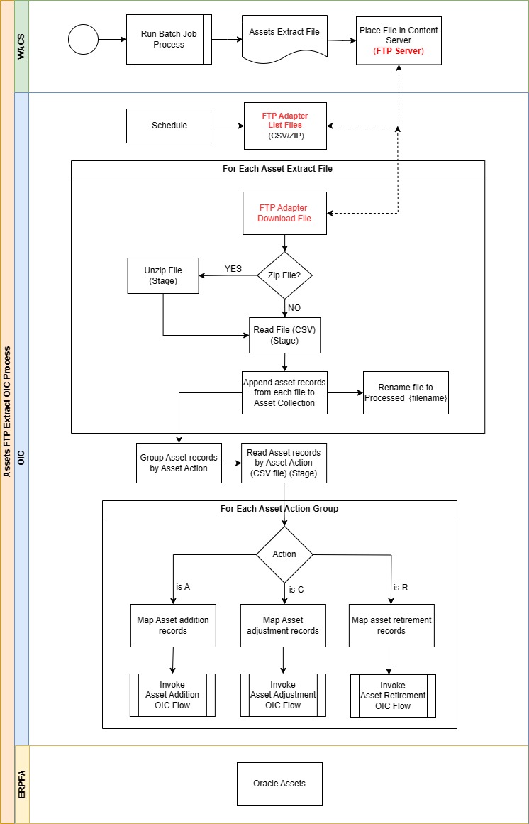

OU WACS ERPFA Assets FTP Extract Process (Oracle Utilities Work and Asset Cloud Service initiated)
This scheduled integration process polls all the Asset Extract files from the Oracle Utilities Work and Asset Cloud Service FTP server and routes the asset records to the respective addition, adjustment, and retirement integration process based on the action. This process serves as the main/master flow that initiates the integration.
The following diagram shows a graphical representation of the OU WACS ERPFA Assets FTP Extract integration process:
Shows a graphical representation of the Vendor/Vendor Location Synchronization integration process.
Processing Details
The integration process is a scheduled orchestrator deployed on Oracle Integration Cloud and performs the following activities:
2. It invokes the List Files operation to get the list of files from FTP server where the Asset Extract files are stored. The FTP location is obtained from the extract.ftp.input.directory property value. Only files that start with the string entered in the property value extract.filename.prefix are selected.
Note: The value extract.filename.prefix should match the beginning of the parameter filename in the W1-ERPFA job in Oracle Utilities Work and Asset Cloud Service.
3. If no files are found, throw a fault, and invoke the OU WACS ERPFA Common Error Handler Process (Oracle Integration Cloud Initiated) integration flow.
a. Download the asset extract file.
c. Read the CSV file and and collect all file level records.
• Else, rename the file by adding the prefix "Sent" or "Uploaded" to the filename. The prefix can be configured at "extract.prefixtag.fileuploaded" property in the OUTL-BRT-WACS_ERPFA_CONFIGPROPS lookup.
a. Invoke the respective child integration process based on the asset action group.
• If the asset action group is A, invoke the OU WACS ERPFA Asset Addition Process (Oracle Utilities Work and Asset Cloud Service Initiated) integration flow and pass addition records.
• If the asset action group is C, invoke the OU WACS ERPFA Asset Adjustment Process (Oracle Utilities Work and Asset Cloud Service initiated)integration flow and pass adjustment records.
• If the asset action group is R, invoke the OU WACS ERPFA Asset Retirement Process (Oracle Utilities Work and Asset Cloud Service initiated) integration flow and pass retirement records.

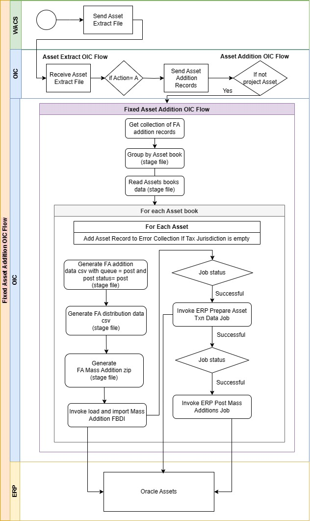

OU WACS ERPFA Fixed Asset Addition Process (Oracle Utilities Work and Asset Cloud Service initiated)
The integration process gets only the fixed asset addition records from the OU WACS ERPFA Asset Addition Process (Oracle Utilities Work and Asset Cloud Service Initiated) integration flow.
The following diagram shows a graphical representation of the OU WACS ERPFA Fixed Asset Addition integration process:A graphical representation of the OU WACS ERPFA Fixed Asset Addition integration process.
Processing Details
This integration is an application driven orchestrator deployed on Oracle Integration Cloud. It performs the following steps:
The process is invoked when asset extract file sent by Oracle Utilities Work and Asset Cloud Service has any fixed asset addition records:
1. The process receives a collection of fixed asset addition records.
2. Group the asset records based on the asset book (owning access group).
3. Repeat the process for each asset book:
a. Repeat the process for each asset:
a. If Asset Tax Jurisdiction is null, add the asset record to error record collection.
b. Generate the FA Mass Additions CSV file.
c. Generate the FA Mass Addition Distributions CSV file.
d. Generate the FA Mass Addition ZIP file.
e. Invoke Post Mass Additions FBDI with post status NEW and queue name NEW. This executes the following schedule processes in Oracle Fusion Cloud ERP:
a. Load the interface file for import.
b. Load the file to interface.
c. Transfer the file.
d. Prepare the Assets Transaction Data.
f. Wait for the Load Interface file to import job execution and retrieve the status
g. If the job status is success, invoke the Prepare Assets Transaction Data scheduled process with ERP cloud adapter query service option.
h. Else, display an error with the error response received from FBDI call with the list of jobs executed with the respective job status.
i. Wait for the Prepare Assets Transaction Data job execution and retrieve the status.
j. If the job status is success, invoke the PostMassAdditions scheduled process with ERP Integration SOAP Service.
k. Else, display an error with the error response received from FBDI call with the list of jobs executed with the respective job status.
l. If the PostMassAdditions job status is successful, send email notification with the Job Id. Else, throw FBDI fault.
4. Each scope of the integration flow has fault handler to capture the errors if any and appends the error data to error record collection.
5. Check for the error record count. If there are any error records, invoke the OU WACS ERPFA Common Error Handler Process (Oracle Integration Cloud Initiated) integration flow to send an optional email notification.
Refer to Configuring Lookups, Error Handling, and Email Notifications for error handling information on error scenarios and retry options.

1. The process receives a collection of project asset addition records.
2. Repeat the process for each project asset addition record.
a. Generate the asset CSV file.
b. Generate the asset assignment CSV file.
3. Generate the import assets and assignments FBDI properties file.
4. Generate the import assets and assignments FBDI ZIP file.
5. Invoke the ERP Import Assets and Assignments Process FBDI file.
6. Send an email with the executed job details.
8. If there are any errors and the error record count is greater than zero, invoke the OU WACS ERPFA Common Error Handler Process (Oracle Integration Cloud Initiated) flow to send an optional email notification with the error details.

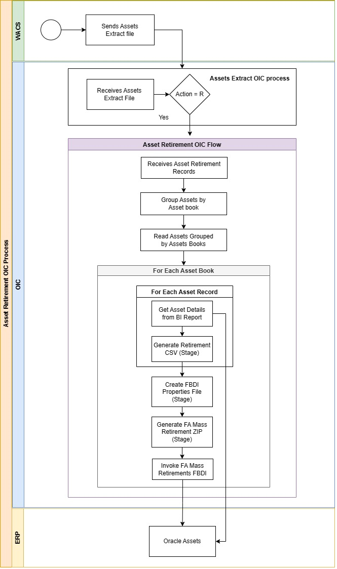

This application driven integration process gets a collection of asset retirement records from master extract flow.
The following diagram shows a graphical representation of the OU WACS ERPFA Asset Retirement integration process.Shows a graphical representation of the Returns Synchronization integration process.
Processing Details
This is an application driven orchestration process deployed on Oracle Integration Cloud. The process is initiated when the asset extract file from Oracle Utilities Work and Asset Cloud Service has any asset retirement record.
The flow is executed as follows:
1. The process gets a collection of asset retirement records.
2. Group the asset data by asset book.
3. For each asset book group, repeat the following process:
a. For each asset record of this asset book group:
a. If the asset badge number is not more than 15 characters:
a. Invoke BI report to get the current cost of the asset from ERP.
b. Generate the retirement CSV file.
c. Else, display fault and add asset record it to the error collection. Skip this asset record.
b. If there are no errors:
a. Generate the FA mass retirement properties file.
b. Generate mass retirement ZIP file with mass retirement CSV and properties files.
c. Invoke ERP FA Mass Retirement FBDI.
d. Send the email notification with job details.
5. If the error record collection has any data, invoke the OU WACS ERPFA Common Error Handler Process (Oracle Integration Cloud Initiated) flow to send an optional email notification.

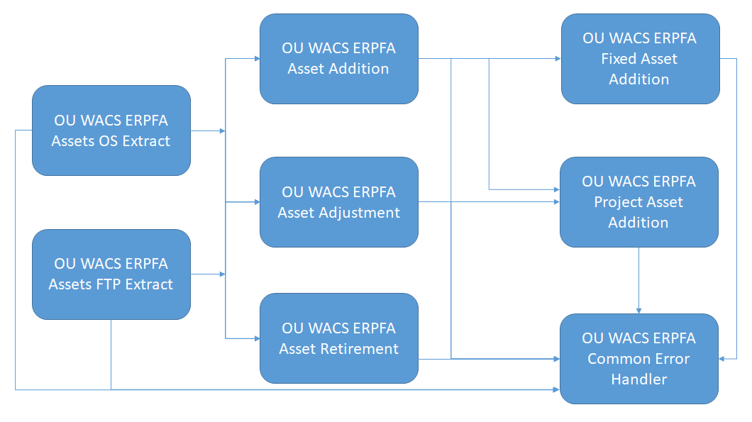

This application driven integration gets a collection of error records from the other integration processes the integration.
The following diagram shows a graphical representation of the OU WACS ERPFA Common Error Handler integration process.Shows a graphical representation of the Invoice Validated Synchronization integration process.
Processing Details
This integration process is an application driven orchestrator deployed on Oracle Integration Cloud. It is initiated when the other integration process throws an error. It is executed as follows:
1. The process gets a collection of error records.
2. For each error record, repeat the following steps:
a. If the error record has any attachment, enable attachment flag.
3. If the notification.error.flag in the OUTL-BRT-WACS_ERPFA_CONFIGPROPS Oracle Integration Cloud lookup is set to 'true'.
a. If the notification.type.email property in the OUTL-BRT-WACS_ERPFA_CONFIGPROPS Oracle Integration Cloud lookup is set to 'email':
a. Invoke the 'GenerateTableData' library function to generate the error data in a tabular format.
b. If the attachment count is zero, send an email notification with the error data.
c. Else, send an email notification with the attachment.
