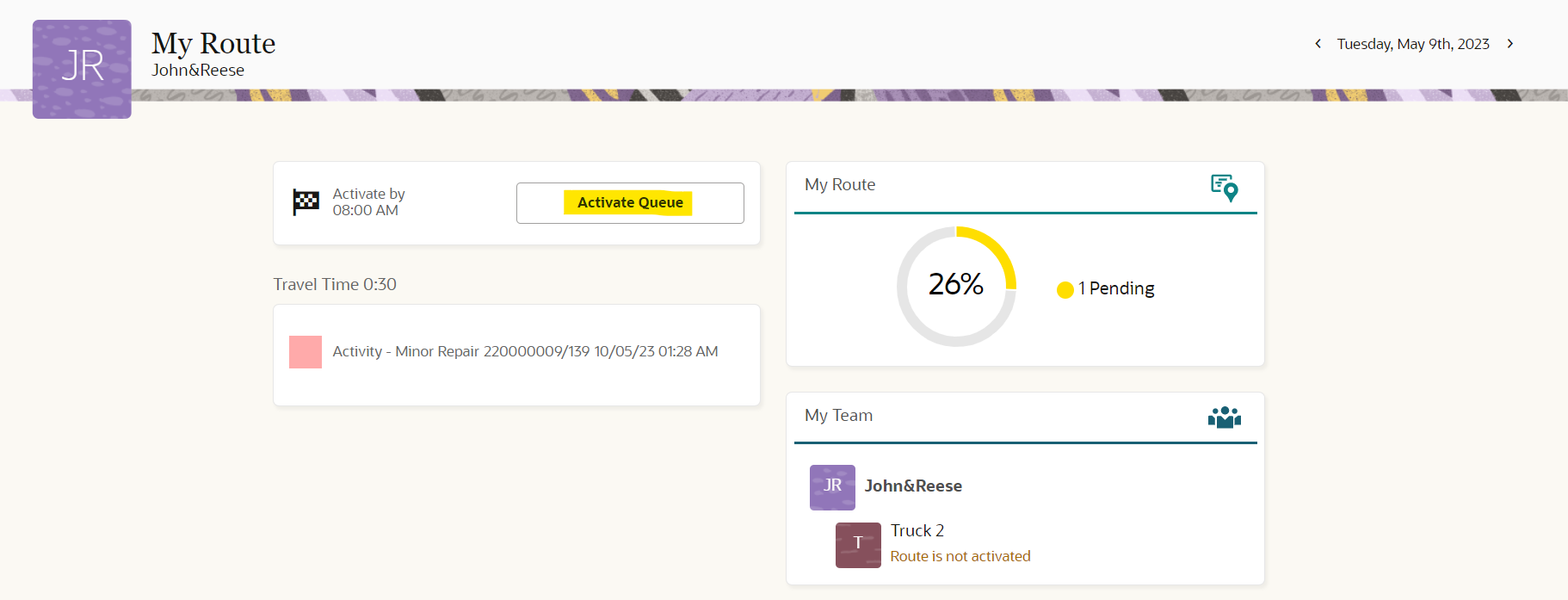

Storeroom Sync on Route Activation
On route activation of a crew or an individual, if there are any trucks associated with that crew or an individual the initial storeroom inventory is synchronized.

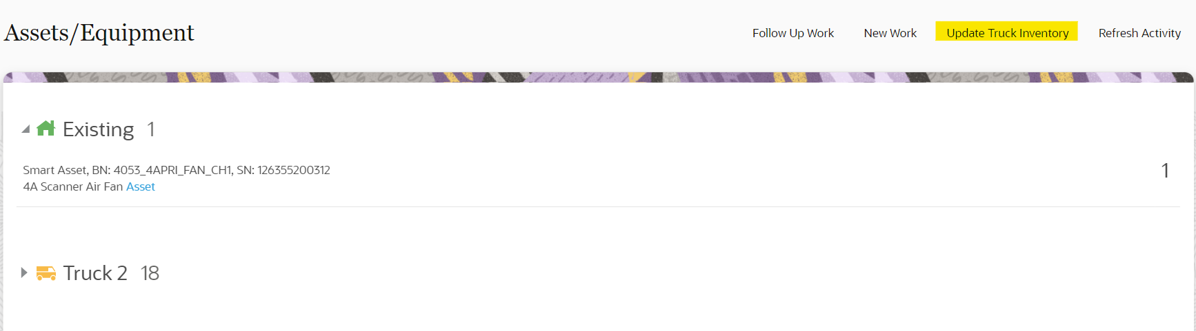

Use the Update Truck Inventory option available on the crew’s Assets/Equipment screen to update the inventory when transfer in or transfer out happens from the truck. Adding new truck inventory does not come under this scenario. In Oracle Field Service we have lastSyncDateTime field which keeps track of the date when last time inventory sync happened. All the inventory transfer in or transfer out happened on or after this date from the truck gets synced up when “update truck inventory” is triggered. If no transfers happened, there will be no updates to the truck information.

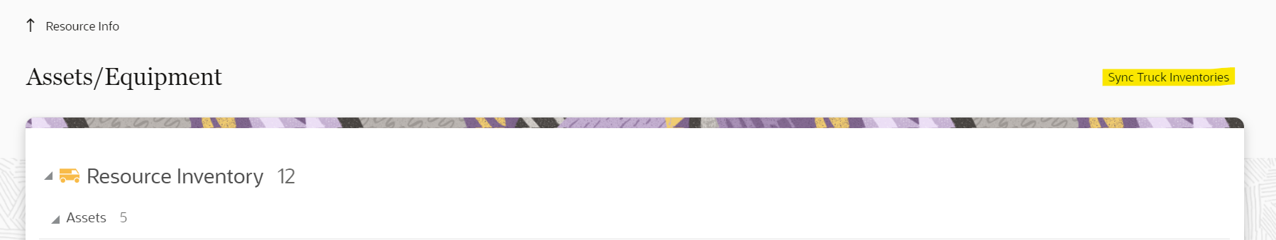

On the Oracle Field Service admin screen, use Sync Truck Inventories on the Resource Info tab to update the truck inventory (new or transferred). Note that this data is not updated in the Oracle Field Service mobile screen.
Note: Before using the Update Truck Inventory or Sync Truck Inventories option, the truck’s inventory in Oracle Field Service should be synchronized with Oracle Utilities Work and Asset Cloud Service. This can be achieved by triggering the Oracle Utilities WACS OFSC Schedule Storeroom Sync flow in Oracle Integration Cloud.
