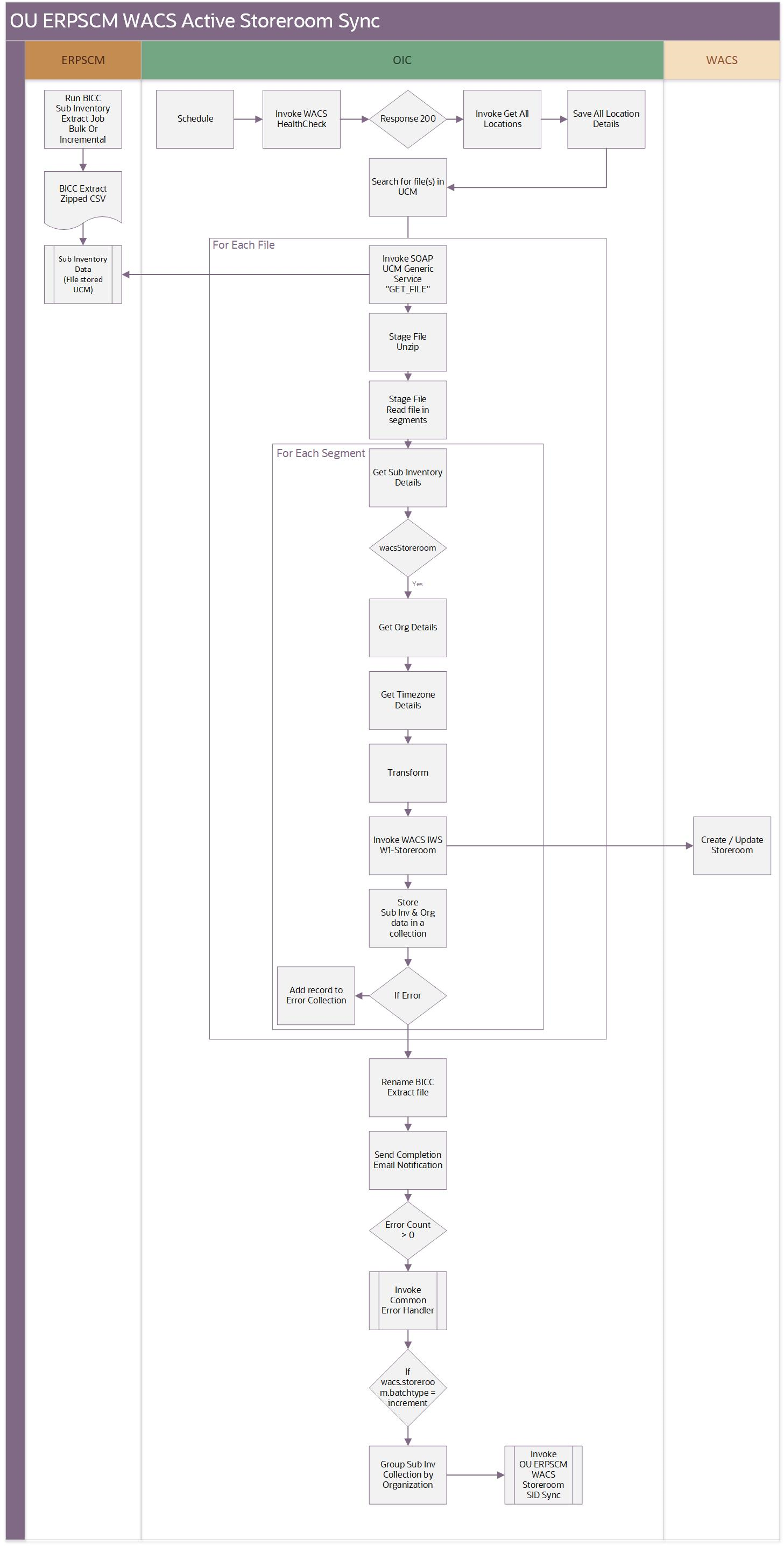

OU ERPSCM WACS Active Storeroom Sync
This integration synchronizes the active sub inventories in Oracle Supply Chain Management as storeroom in Oracle Utilities Work and Asset Cloud Service.
The following diagram shows a graphical representation of the OU ERPSCM WACS Active Storeroom Sync integration process:
Processing Details
This is an asynchronous scheduled integration process deployed on Oracle Integration Cloud and performs the following activities:
1. This process is triggered on a schedule basis with a schedule parameter fileName prefix.
Note: Ensure the BICC ERPSCM_ActiveSubinvExtBICC_WACS job is scheduled in Oracle Supply Chain Management before this integration process is scheduled.
2. Invoke the WACS IWS F1-HealthCheck SOAP service to check the Oracle Utilities Work and Asset Cloud Service connectivity before proceeding with the flow execution.
3. Invoke the UCM Generic SOAP service to search the file(s) with the matching file name prefix.
4. For each sub inventory extract zip file found:
a. If count of number of files found is ‘0’:
a. Send an email notification.
Note: Sending email notification is optional; this can be configured in the configuration properties lookup by setting the notification.email.process.nofile.flag to ‘true’.
b. Set the error flag to ‘false’.
c. Invoke the UCM Generic SOAP service to get the sub inventories extract zip file from UCM given the DocId obtained from the search above.
d. Unzip the file using stage operation.
e. Invoke the “ReadFileinSegments” stage file action. This action reads the file in segments of 200 records. After all the 200 records are processed, the next segment of 200 records is read.
f. For each subinventory record in the file, do the following:
a. Transform the payload from Oracle Supply Chain Management to the Oracle Utilities Work and Asset Cloud Service payload. Map the location details by fetching them using the REST API Get all locations.
a. Use the get all locations REST API given in the references.
b. Using the locationId received in the extract in the query parameters, fetch the other location details, such as address 1,address 2,address 3,address 4, country, state.
c. Use the lookup for mapping country and state.
b. Invoke the WACS REST service - W1-Storeroom to pass the sub inventory information to Oracle Utilities Work and Asset Cloud Service.
c. In case of any errors, append the record to the error collection.
d. Set the error flag to ‘true’.
e. Append Sub inv and Org data to a collection.
g. If the error flag is ‘true’, invoke the UCM Generic SOAP service to update the file to “Error-” filename passing the required parameters.
h. Else, invoke the UCM Generic SOAP service to update the file to “PROCESSED-” filename passing these required parameters.
5. On successful processing of all the records in the file, an email is sent with the completion message.
Note: Sending an email notification is optional; this can be configured in the configuration properties lookup by setting the notification.email.process.complete.flag to ‘true’.
a. Also check if the number of records processed is > 0.
b. If yes, do not send the success email.
6. If the error records collection > 0:
7. Invoke the OU ERPSCM WACS Storeroom SID Sync child flow and pass the sub inv - Subinv collection grouped by organization.

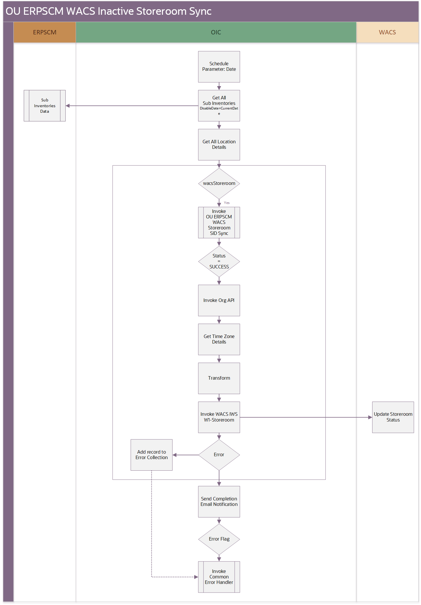

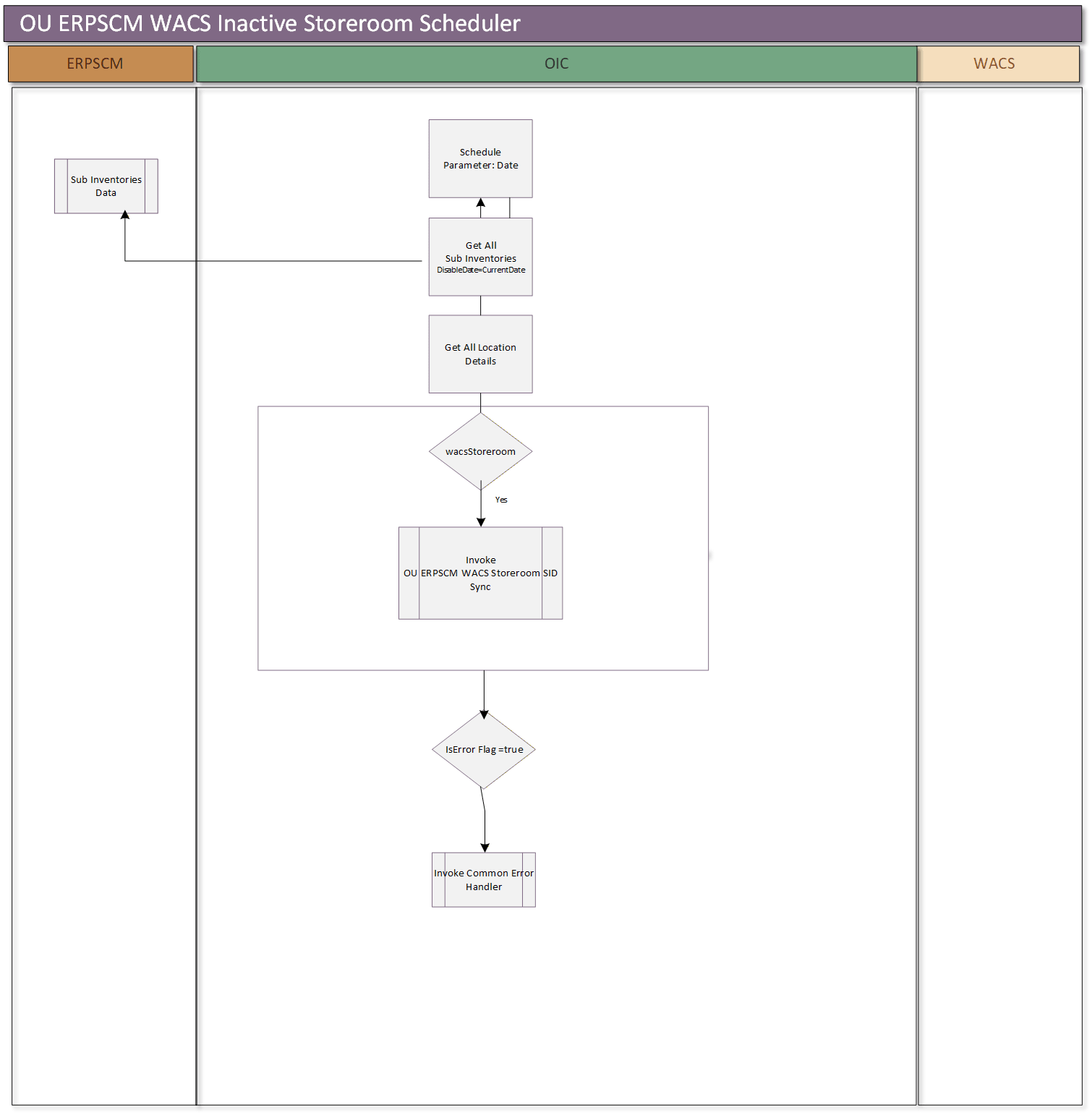

OU ERPSCM WACS Inactive Storeroom Scheduler
This integration flow synchronizes the disabled sub-inventories status back to Oracle Utilities Work and Asset Cloud Service from Oracle Supply Chain Management. It mainly fetches the sub-inventory details that were deactivated after the given date.
The following diagram shows a graphical representation of the OU ERPSCM WACS Inactive Storeroom Scheduler integration process:
Processing Details
1. This process is triggered on a schedule basis.
Note: It is recommended that you schedule this integration on a daily basis, at the end of the day.
2. Fetch all the sub-inventories from Oracle Supply Chain Management.
“/ fscmRestApi/resources/11.13.18.05/subinventories” REST API with Disable Date = CURRENT DATE.
3. For each sub-inventory:
a. Invoke OU ERPSCM WACS Storeroom SID Sync and map all the fields.
b. If there is an error, add the record to the error collection and set the error flag.
4. Send a successful completion email with list of all sub-inventories that were deactivated.
5. If the error flag is set to “true”, send an error email.
6. Send the collection to SID deactivation, invoke the OU ERPSCM WACS Storeroom SID Sync child integration.
Technical Details
The following table describes the integration processes and the respective artifacts used in this integration process:
Artifacts
Value
Integration Process Name
Project Name
OU WACS ERPSCM

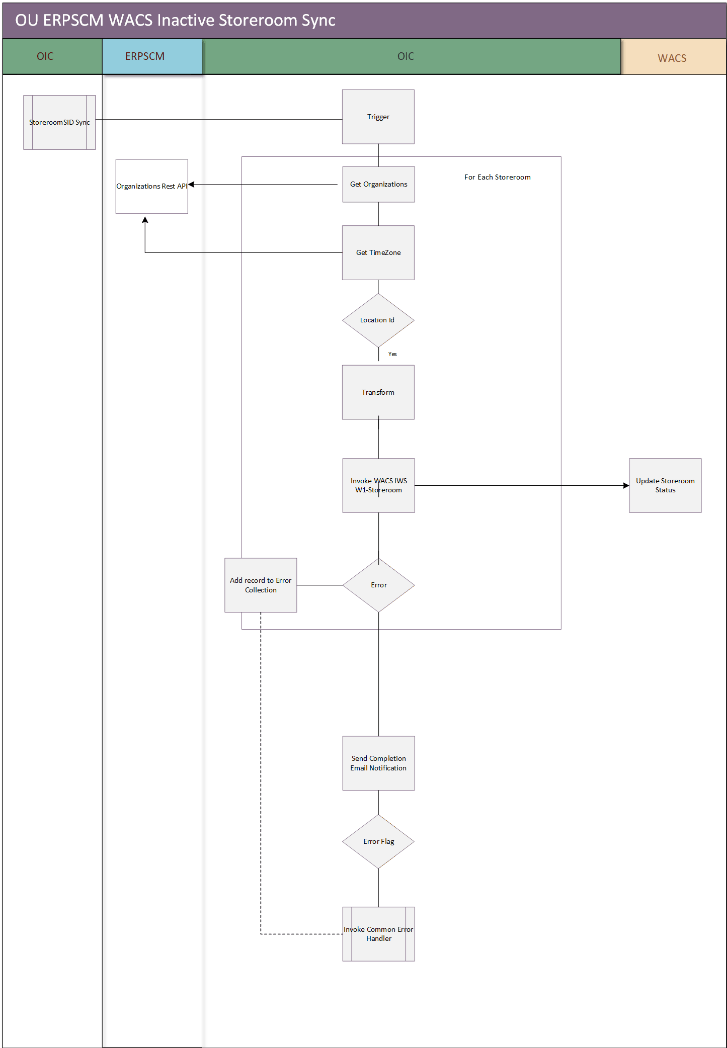

OU ERPSCM WACS Inactive Storeroom Sync
This integration synchronizes the disabled sub-inventories status back to Oracle Utilities Work and Asset Cloud Service from Oracle Supply Chain Management. This flow is mainly invoked from OU ERPSCM WACS Storeroom SID Sync with all sub-inventory details that should be deactivated.
The following diagram shows a graphical representation of the OU ERPSCM WACS Inactive Storeroom Sync integration process:
Processing Details
This is an asynchronous integration process deployed on Oracle Integration Cloud and performs the following activities:
1. This process is triggered from OU ERPSCM WACS Storeroom SID Sync.
2. For each sub inventory:
a. If the status from Storeroom SID sync is success, then:
a. Invoke the ERP Organizations REST API service and fetch the Organization details.
b. Invoke the ERP Organizations REST API service and fetch the TimeZone details.
c. In case of any error, add the record to the error collection and set the “error” flag.
b. If the Location ID is not empty:
a. Invoke the WACS Manage Storeroom REST API to deactivate the storeroom.
3. Send a successful completion email with list of all sub-inventories that were deactivated.
4. If error flag is ‘true’, send an error email as well.

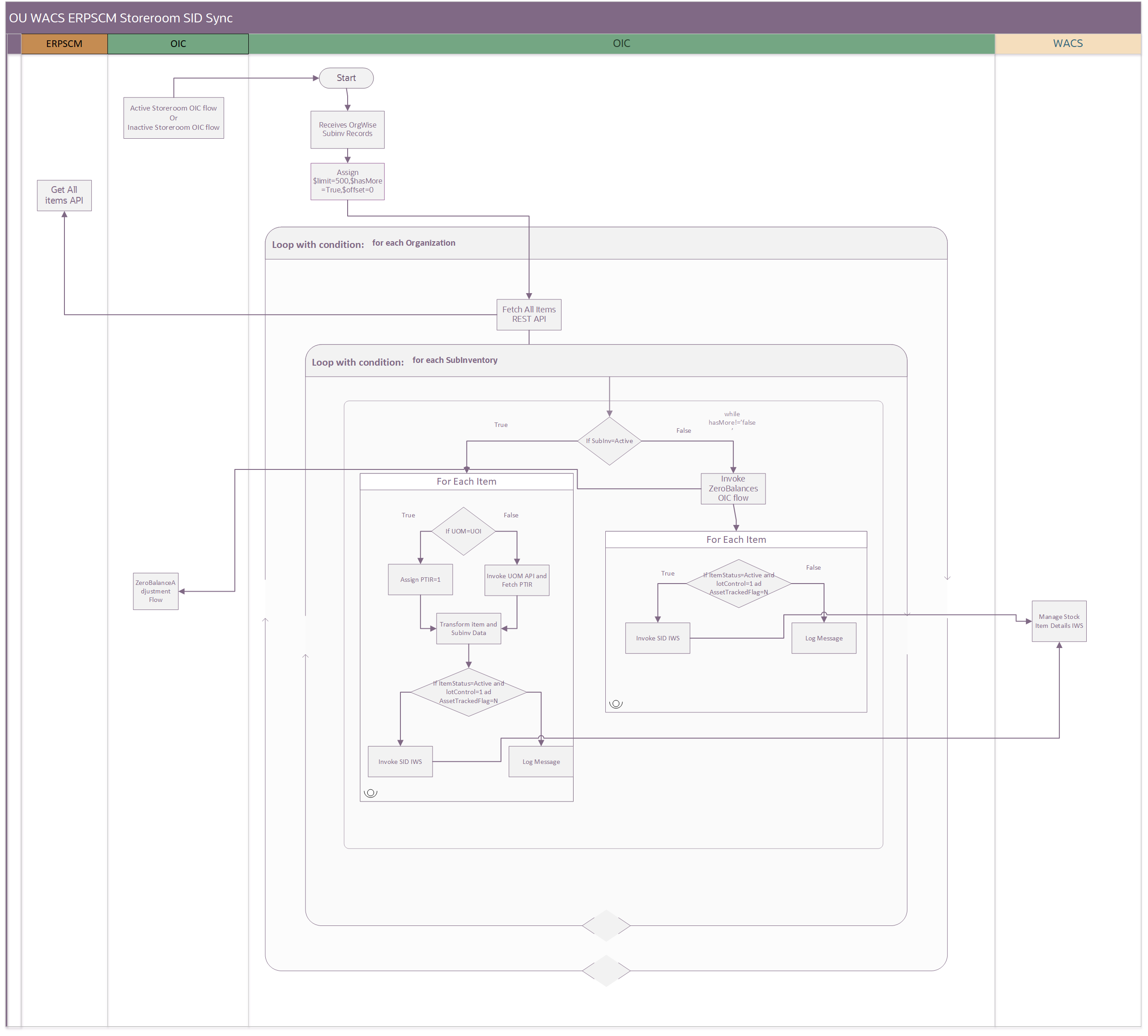

This integration creates/disables the SIDs of the respective storerooms, whenever a new storeroom is created or updated in Oracle Supply Chain Management. This flow will be called either by the Active Storeroom Sync or Inactive Storeroom Sync integration flow. It is the common flow for both to create/update the SIDs.
The following diagram shows a graphical representation of the OU ERPSCM WACS Storeroom SID Sync integration process:
Processing Details
This is an asynchronous application driven integration process deployed on Oracle Integration Cloud and performs the following activities:
1. This process receives OrgId and sub inventory collection from parent flows grouped by OrgId.
2. For each organization, gets all items using the “/fscmRestApi/resources/11.13.18.05/itemsV2” REST API.
3. For each sub inventory:
• If Subinv status is ACTIVE:
a. Invoke ItemBIPReport to retrieve all items related to Oracle Utilities Work and Asset Cloud Service category for particular organization.
b. For each item, derive the “Purchase To Issue Ratio” value.
c. If asset tracked flag is N, lot_control=1 and inventory items status is Active.
d. Transform item and sub inventory data to Oracle Utilities Work and Asset Cloud Service stock item details format.
e. Map leadTime as proessingdays+postprocessingdays+preprocssingdays.
f. Invoke WACS IWS W1-StockItemDetails.

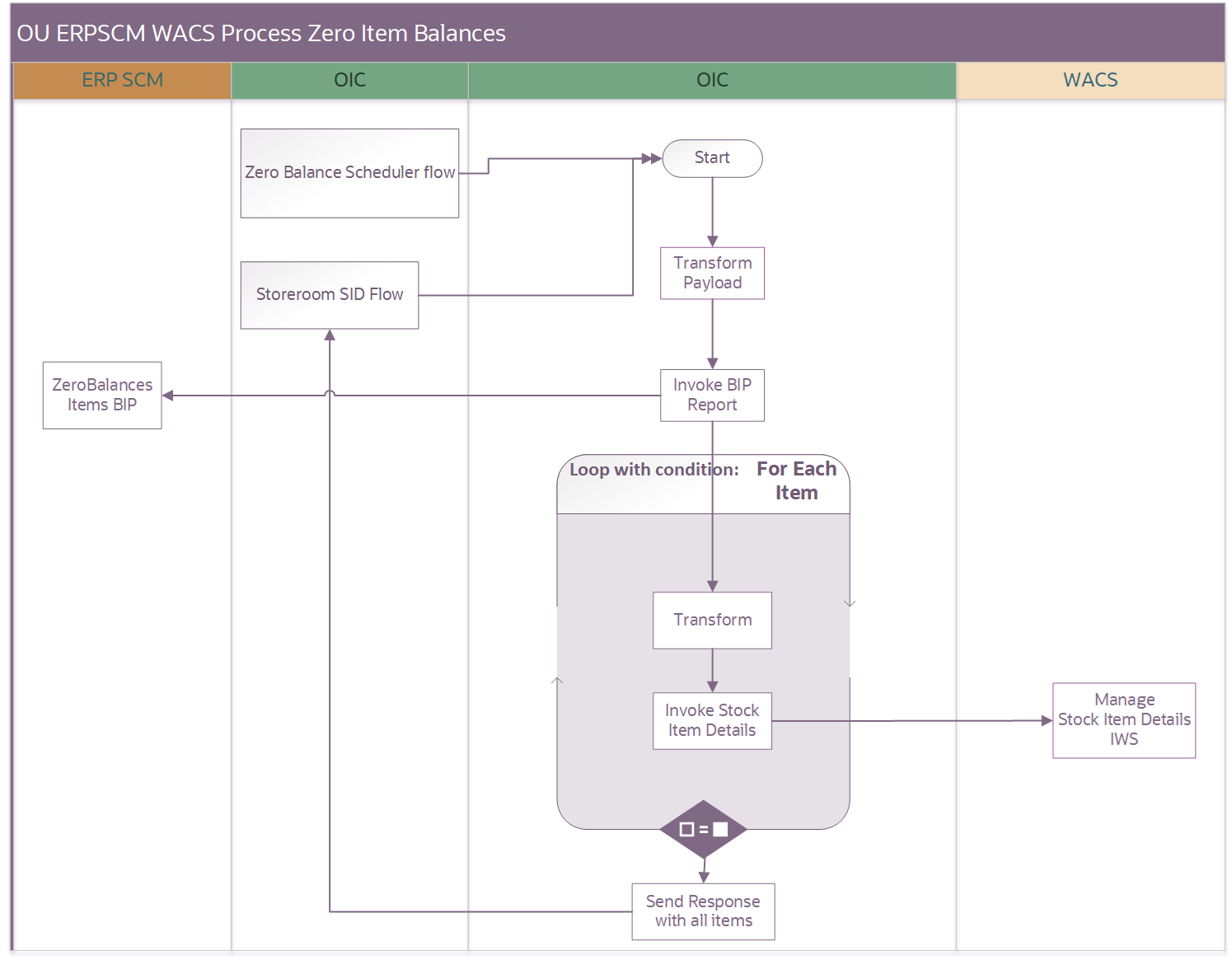

• If the Subinv status is INACTIVE:
• Invoke the OU ERPSCM WACS Process Zero Item Balances integration.
• For each item received from Zero Balance Integration:
• If the asset tracked flag is N, lot_control=1 and inventory items status is Active.
• Transform the item and sub inventory data into the Oracle Utilities Work and Asset Cloud Service stock item details format.
• Invoke WACS IWS W1-StockItemDetails.

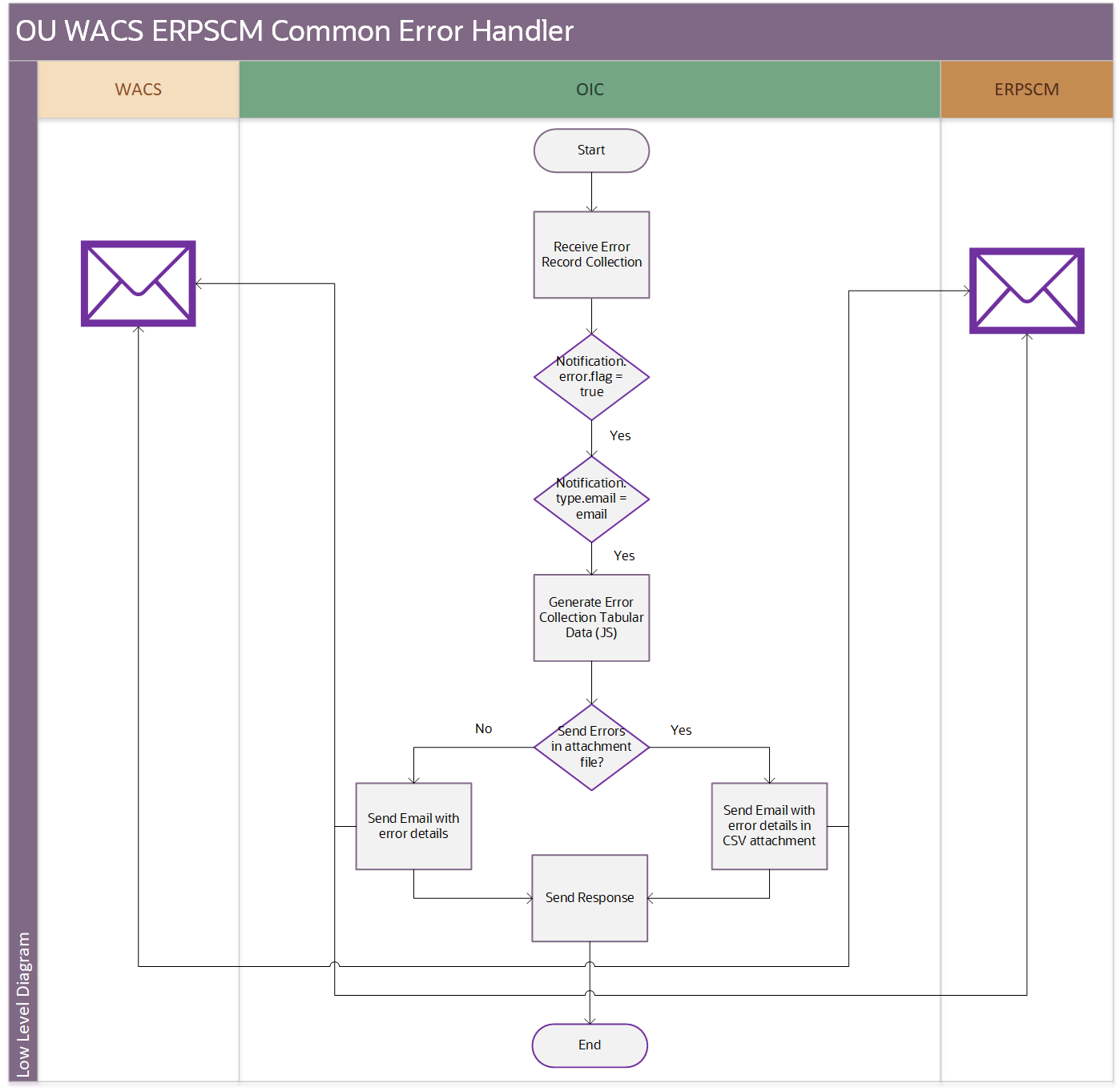

• If Oracle Utilities Work and Asset Cloud Service returns a fault, add the Item unique ID/value in error and error details to the error collection. Then, continue with the next Item record.
4. If all the records are processed suucessfully, the OU ERPSCM WACS Inactive Storeroom Sync is invoked to deactivate the subinventory.
5. Check for any Oracle Utilities Work and Asset Cloud Service errors encountered.
6. In case of any errors, send an optional error mail notification based on the “notification.error.flag” configuration property value defined in the OUTL-BRT-WACS_ERPSCM_ConfigProps lookup.

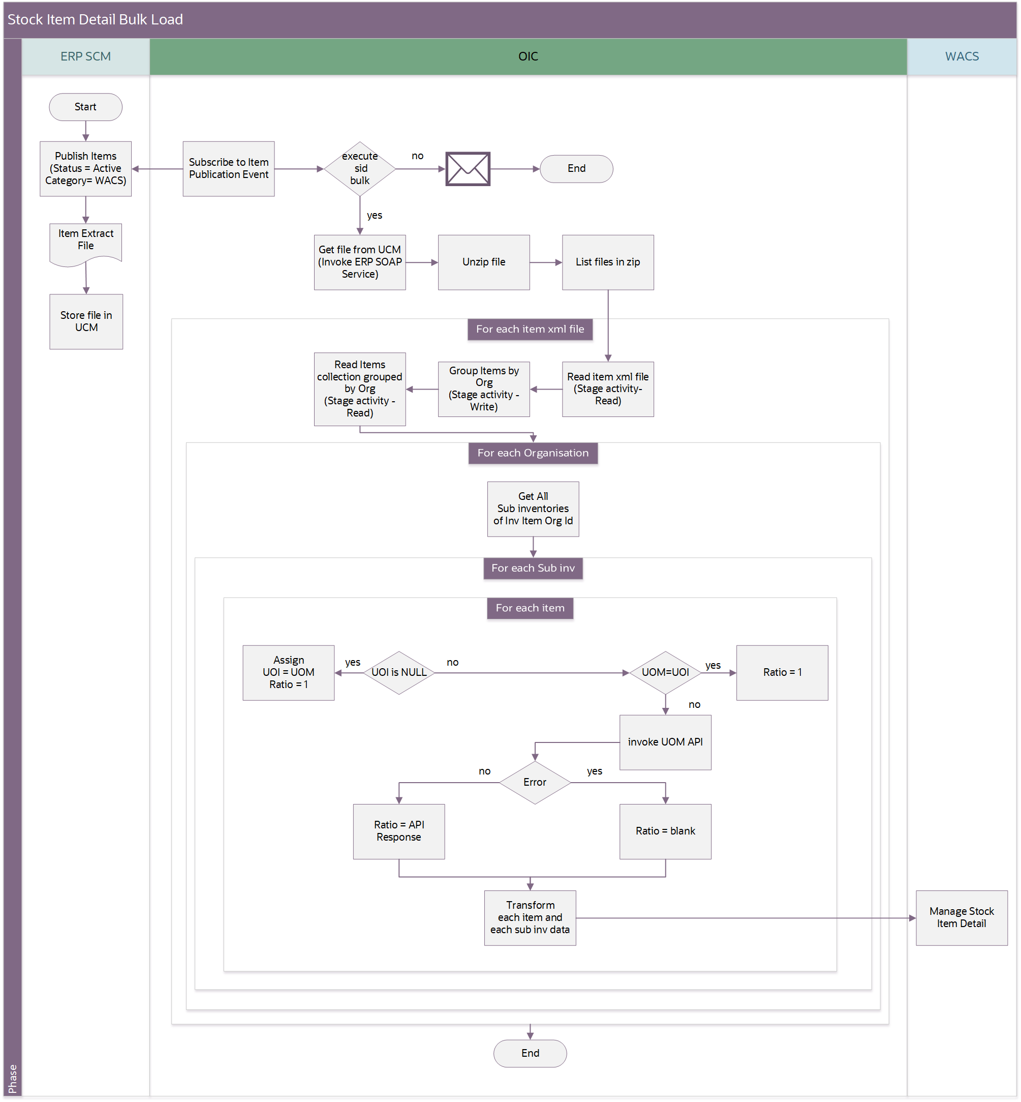

OU ERPSCM WACS Stock Item Detail Bulk Load
This integration process synchronizes the inventory items extracted in bulk from Oracle Fusion ERP Cloud to Stock Item Details in Oracle Utilities Work and Asset Cloud Service storerooms. The process is usually run after all items from Oracle Supply Chain Management are synchronized to stock items in Oracle Utilities Work and Asset Cloud Service.
Note that the Item Initial Synchronization process in the Oracle ERP Product Hub Cloud Integration to Oracle Utilities Work and Asset Cloud Service for Stock Item integration solution is a pre-requisite for SID Bulk Load.
For information about this process, refer to the Oracle ERP Product Hub Cloud Integration to Oracle Utilities Work and Asset Cloud Service for Stock Item documentation on Oracle Help Center at: https://docs.oracle.com/en/industries/energy-water/integrations-index.html
The following diagram shows a graphical representation of the OU ERPSCM WACS Stock Item Detail Bulk Load integration process:
Processing Details
This is an asynchronous (one-way) integration process deployed on Oracle Integration Cloud.
The process is triggered by a business event raised within Oracle Fusion ERP Cloud when an Item File is published. This Oracle Integration Cloud process handles the following:
1. Subscribe to an Item Publication Event. Oracle Supply Chain Management publishes an event with a payload containing the Doc ID when an item file is published in the Oracle Fusion ERP Cloud UCM server.
2. Check for “execute.sid.bulk” flag from the OUTL-BRT-WACS_ERPSCM_ConfigProps lookup.
Note: Make sure that the Oracle Utilities ERPPIM WACS Item Initial Sync flow in the OU WACS ERPPIM Project is executed and successful, which will create Stock items in Oracle Utilities Work and Asset Cloud Service. For stock item PIM flow to process the items records, make sure “execute.stockitem.bulk” flag is enabled. After the items are created successfully, disable the “execute.stockitem.bulk” flag to avoid redundant item creation calls in Oracle Utilities Work and Asset Cloud Service.
• After the PIM flow is executed, enable the “execute.sid.bulk” flag. The SID bulk flow processes the SID records, only when this flag is enabled.
3. If the “execute.sid.bulk” flag is “no”:
a. Notify the user to synchronize bulk SIDs to Oracle Utilities Work and Asset Cloud Service. Set the “execute.sid.bulk” flag to “yes” in the configuration properties lookup.
b. Stop the flow.
4. If the flag is set to “yes”:
a. Invoke the Oracle Utilities Work and Asset Management health check IWS, if successful.
a. Invoke the UCM Generic SOAP service to get the Item file from UCM given the doc ID provided by the Item Publication Event.
b. Unzip the file.
c. List the files (.xml).
d. For each file:
a. Read the file using the stage file activity.
b. Generate the file with item records grouped by organization (org Id)
e. Read item collection grouped by Organization.
f. For each Organization:
a. Get all active storage type sub inventories. Invoke the sub inventories ERP REST API /fscmRestApi/resources/11.13.18.05/subinventories
b. If no sub-inventories are returned:
• Send an email and throw the following fault:
“The Org:<org id> or <org code> doesn't have Sub inventory, hence SID for this item:<item id > or <item code> cannot be created.”
c. While hasMore=”true”
• In each sub-inventory, for each item record in the file, do the following:
• If wacsStoreroom = 'Yes' and SubinventoryTypeMeaning = 'Storage' and DisableDate = '' or DisableDate >= fn:substring-before(fn:string(fn:current-date()), 'Z'))
• For each item record:
• If AssetTrackedFlag = 'false' and LotControlValue = 'No lot control' and OrganizationId = ns49:Organization/attribute::id:
• Derive the PTIR value.
• Transform the item and sub inventory data to the Oracle Utilities Work and Asset Cloud Service stock item detail format.
• Map ‘leadTime’ as proessingdays+postprocessingdays+preprocssingdays.
• If Oracle Utilities Work and Asset Cloud Service returns a fault:
• Add the item unique ID/value in the error and error details to the Oracle Utilities Work and Asset Cloud Service error collection.
• Then, continue with the next item record.
• Reset Offset to process other organization items.
• After all records are processed, check for any Oracle Utilities Work and Asset Cloud Service errors encountered.
• In case of any errors, invoke the OU WACS ERPSCM Common Error Handler flow.
• This flow sends optional process complete mail notification based on the “notification.email.process.complete.flag” config property value in the OUTL-BRT-WACS_ERPSCM_ConfigProps lookup.
Technical Details
Artifacts
Value
Project Name
OU WACS ERPSCM

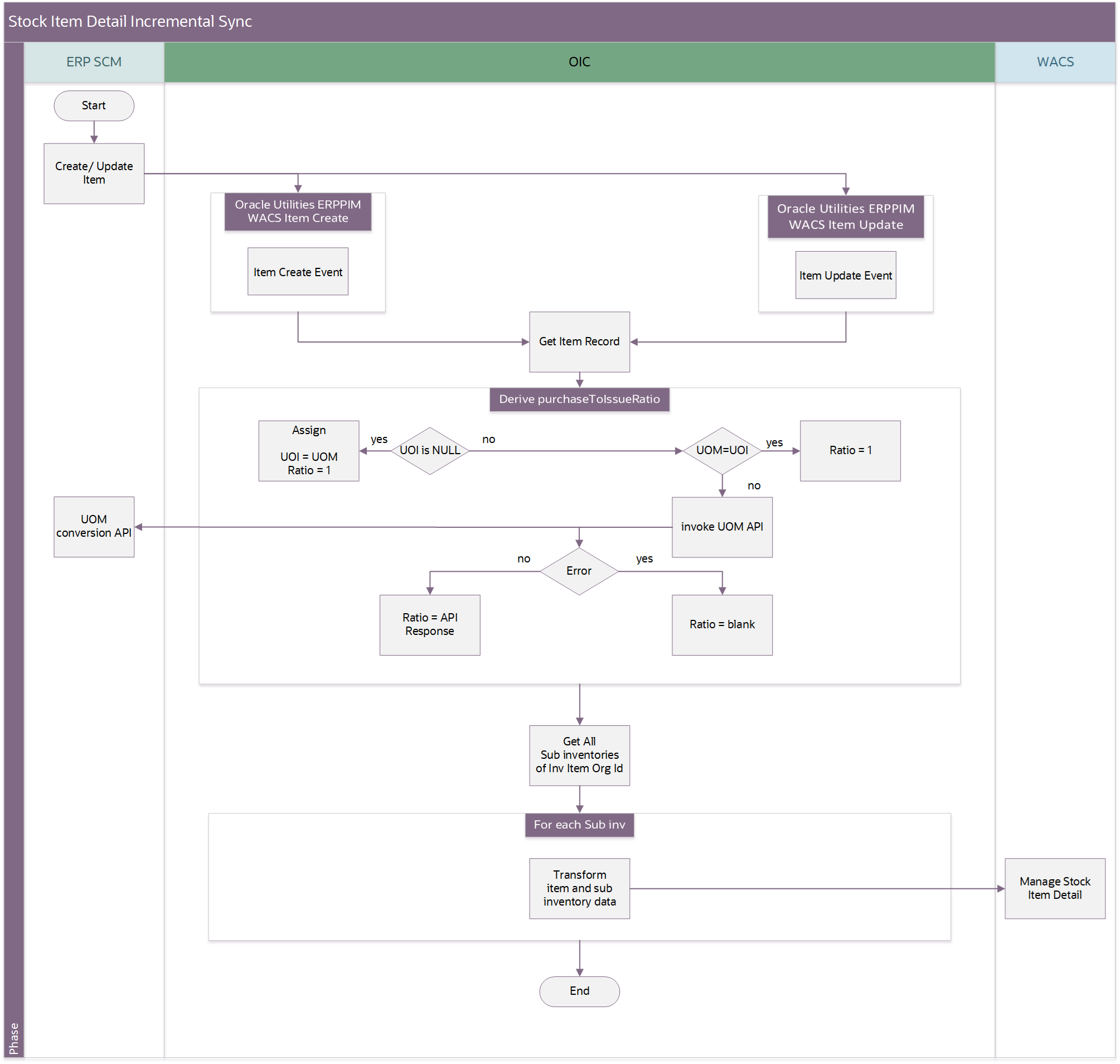

OU ERPSCM WACS Stock Item Detail Incremental Sync
This integration process synchronizes the inventory item created/updated in Oracle Fusion ERP Cloud to Stock Item Details in Oracle Utilities Work and Asset Cloud Service storerooms. It is invoked whenever an item is created or updated in Oracle Fusion ERP Cloud.
The following diagram shows a graphical representation of the OU ERPSCM WACS Stock Item Detail Incremental Sync integration process:
Processing Details
1. Get the item data from Oracle Utilities ERPPIM WACS Item Create/Oracle Utilities ERPPIM WACS Item Update flows in the OU WACS ERPPIM project.
2. Create the global variables for UOM, UOI, PTIR (purchase to issue ratio) and Org Id.
3. Assign UOM, UOI, and OrgId with the respective values.
4. Derive the PTIR value.
a. If UOI is ‘Null’:
a. Assign UOI = UOM
b. Assign '1' to PTIR
b. If UOM = UOI:
a. Assign ‘1’ to PTIR.
b. Else, invoke the “UnitOfMeasureConversions” Oracle Fusion ERP Cloud REST service:
c. If the API returns an error, assign blank value to PTIR.
d. Else, assign API response > ConversionFactor to PTIR.
5. Using OrgId as the input parameter, get all sub inventories. Invoke the “/fscmRestApi/resources/11.13.18.05/subinventories” Oracle Fusion ERP Cloud REST API.
6. For each active and storage type sub inventory:
a. Transform the item and sub inventory data to the Oracle Utilities Work and Asset Cloud Service stock item detail format.
b. Map ‘leadTime’ as proessingdays+postprocessingdays+preprocssingdays.
c. Invoke the “W1-StockItemDetail” Oracle Utilities Work and Asset Cloud Service Inbound Web Service, operation name: manageStockItemDetail.
d. If Oracle Utilities Work and Asset Cloud Service returns a fault, add the Item unique ID/value in error and error details to the Oracle Utilities Work and Asset Cloud Service error collection.
e. Then, continue with the next sub inventory record.
7. If error count > 0:
a. Send the error collection to common error handler.
b. Transform the “ERROR” response to SI create/update flow accordingly.
8. Else (when all SIDs are processed successfully), transform the “SUCCESS” response to SI create/update flow accordingly.
9. This flow sends an optional process complete mail notification, based on the “notification.email.process.complete.flag” configuration property value.
Technical Details
Artifacts
Value
Project Name
OU WACS ERPSCM
REST Adapter
OU REST Trigger for WACS-ERPSCM
Oracle Utilities Adapter (REST)
OU REST WACS for WACS-ERPSCM
REST Adapter
OU REST ERP for WACS-ERPSCM
Oracle ERP Cloud Adapter
OU ERPSCM Cloud for WACS-ERPSCM

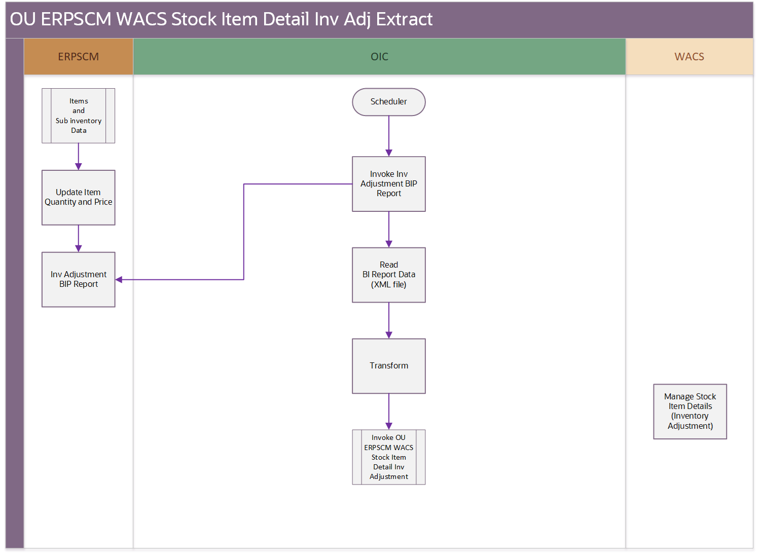

OU ERPSCM WACS Stock Item Detail Inv Adj Extract
This integration process gets the item quantity and unit price for all the sub inventories from Oracle Supply Chain Management and sends it to child to process the same.
The following diagram shows a graphical representation of the OU ERPSCM WACS Stock Item Detail Inv Adj Extract integration process:
Processing Details
1. The Oracle Integration Cloud flow is a scheduler driven integration with the schedule parameter as “last run date time”.
Note: Make sure the “LastRunDateTime” scheduled parameter is passed in the “" YYYY-MM-DDTHH:mm:ss.SSS[offset]” format while configuring the scheduler or running the OU ERPSCM WACS Stock Item Detail Inv Adj Extract integration.
Example: 2024-11-26T10:16:35.000+00:00 ; 01-31-2000 01:01:01 +0000
2. Invokes the ExternalReportWebservice BI report to get the item details from Oracle Fusion ERP Cloud.
3. Reads the BI report data using the stage file activity.
4. Transforms the item records.
5. Invokes the child OU ERPSCM WACS Stock Item Detail Inv Adjustment Oracle Integration Cloud flow.
6. If the child flow response is successful:
• Update the schedule parameter.
7. Else:
• Invoke the OU WACS ERPSCM Common Error Handler and throw fault.

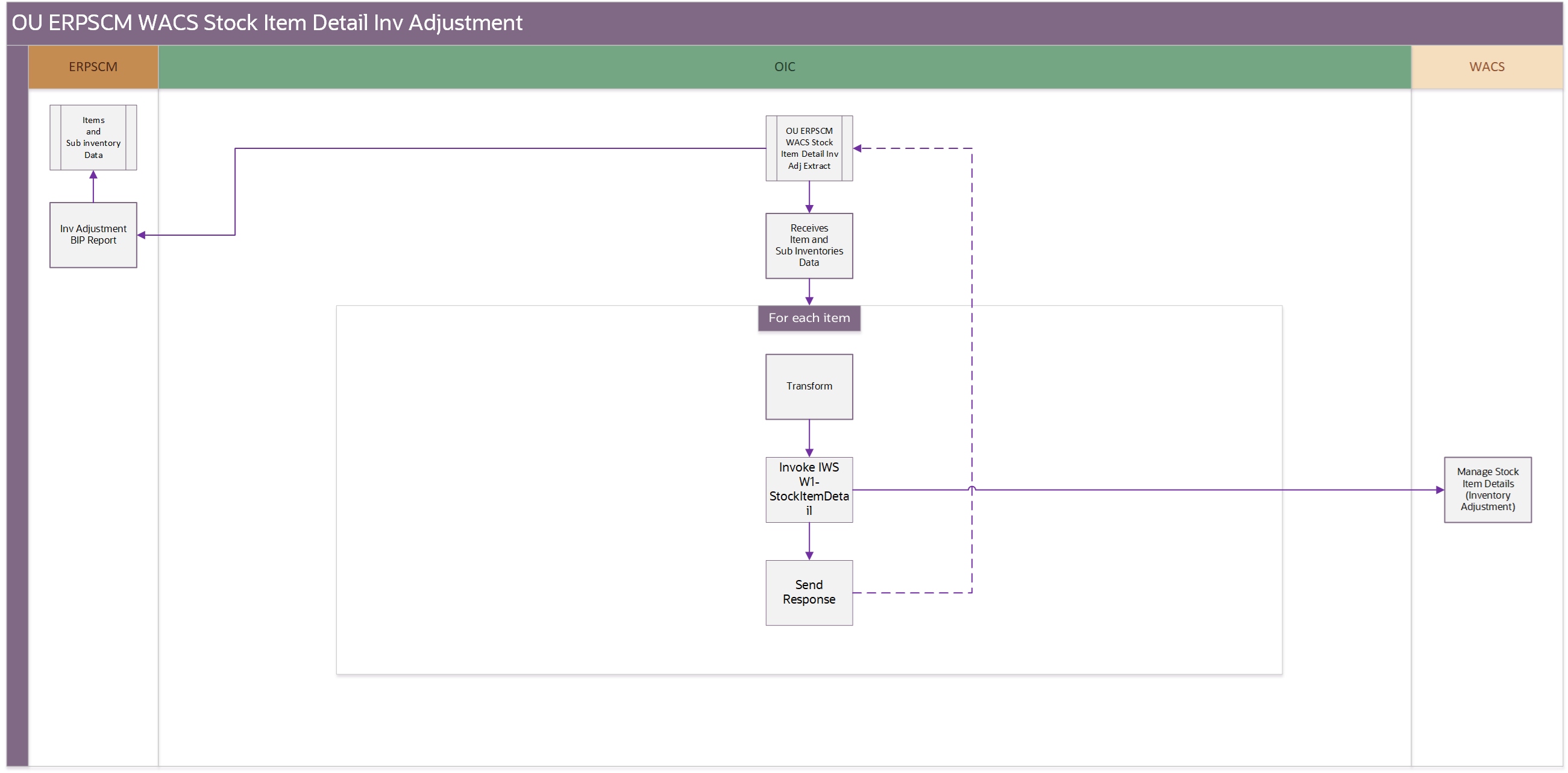

This integration process gets the item records from Oracle Fusion ERP Cloud, from the parent OU ERPSCM WACS Stock Item Detail Inv Adj Extract, and updates the stock item details in Oracle Utilities Work and Asset Cloud Service with Oracle Fusion ERP Cloud item quantity and price it to Oracle Utilities Work and Asset Cloud Service.
The following diagram shows a graphical representation of the OU ERPSCM WACS Stock Item Detail Inv Adjustment integration process:
Processing Details
This Oracle Integration Cloud flow is an application driven integration. It performs the following activities:
1. Gets item data from the extract flow.
2. For each record:
a. Transforms the data.
b. Invokes WAM REST IWS W1-StockItemDetail, operation name:
/inventoryAdjustment
c. If there is no error, increase the processed/success record count
d. In case of an error, add it to the error collection.
3. Send the completion email with error and success count.
4. If error count > 0, invoke the OU WACS ERPSCM Common Error Handler flow to send an optional email notification.

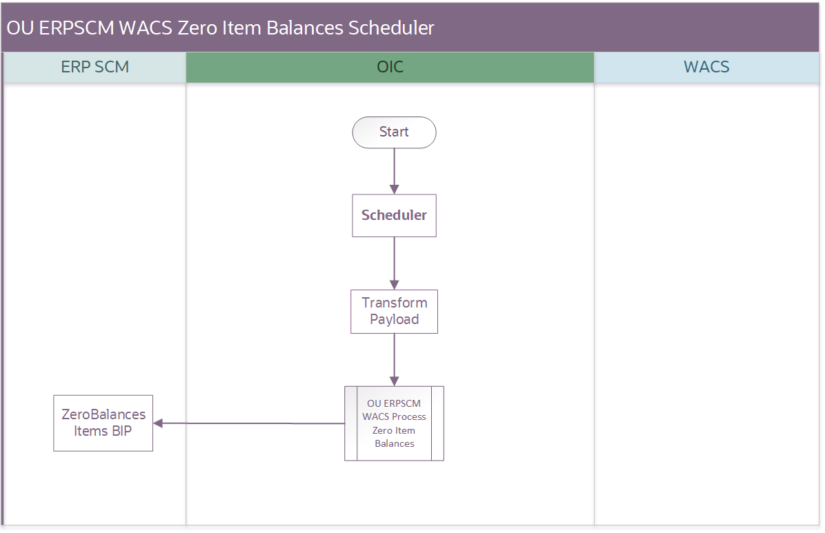

OU ERPSCM WACS Zero Item Balances Scheduler
This integration invokes the Process Zero Balances Item Adjustment flow.
The following diagram shows a graphical representation of the OU ERPSCM WACS Zero Item Balances Scheduler process:Shows a graphical representation of the OU ERPSCM WACS Zero Item Balances Scheduler process.
Processing Details
• This is a scheduler based integration.
• The integration invokes the OU ERPSCM WACS Process Zero Item Balances integration flow.
This integration extracts Zero Balance items from Oracle ERP and update the stock item details in Oracle Utilities Work and Asset Cloud Service.
The following diagram shows a graphical representation of the OU ERPSCM WACS Process Zero Item Balances process:Shows a graphical representation of the OU ERPSCM WACS Process Zero Item Balances process.
Processing Details
• The integration processes zero balances item details from Oracle Supply Chain Management to Oracle Utilities Work and Asset Management.
• This is an application driven integration.
• This Oracle Integration Cloud integration process performs the following:
a. The integration triggers when the OU ERPSCM WACS Zero Item Balances Scheduler is run, and also when the OU ERPSCM WACS Storeroom SID Sync is invoked from OU ERPSCM WACS Inactive Storeroom Sync.
b. Invokes the zero balances BIP report that retrieves all the items which are of “WACS” item category and with quantity zero.
c. Repeats the following steps for each item:
a. Transforms the payload to Oracle Utilities Work and Asset Management format.
b. Invokes the Manage Stock Item Details Oracle Utilities Work and Asset Management IWS.
d. Return the response with all items when it invoked from OU ERPSCM WACS Storeroom SID Sync.
e. In case of any errors:
f. In the end, sends a process completion email notification with the success and error details.
g. In Global Fault Handler:
a. The OU WACS ERPSCM Common Error Handler flow will send an optional email notification based on the notification.error.flag property configured in the OUTL-BRT-WACS_ERPSCM_ConfigProps lookup.

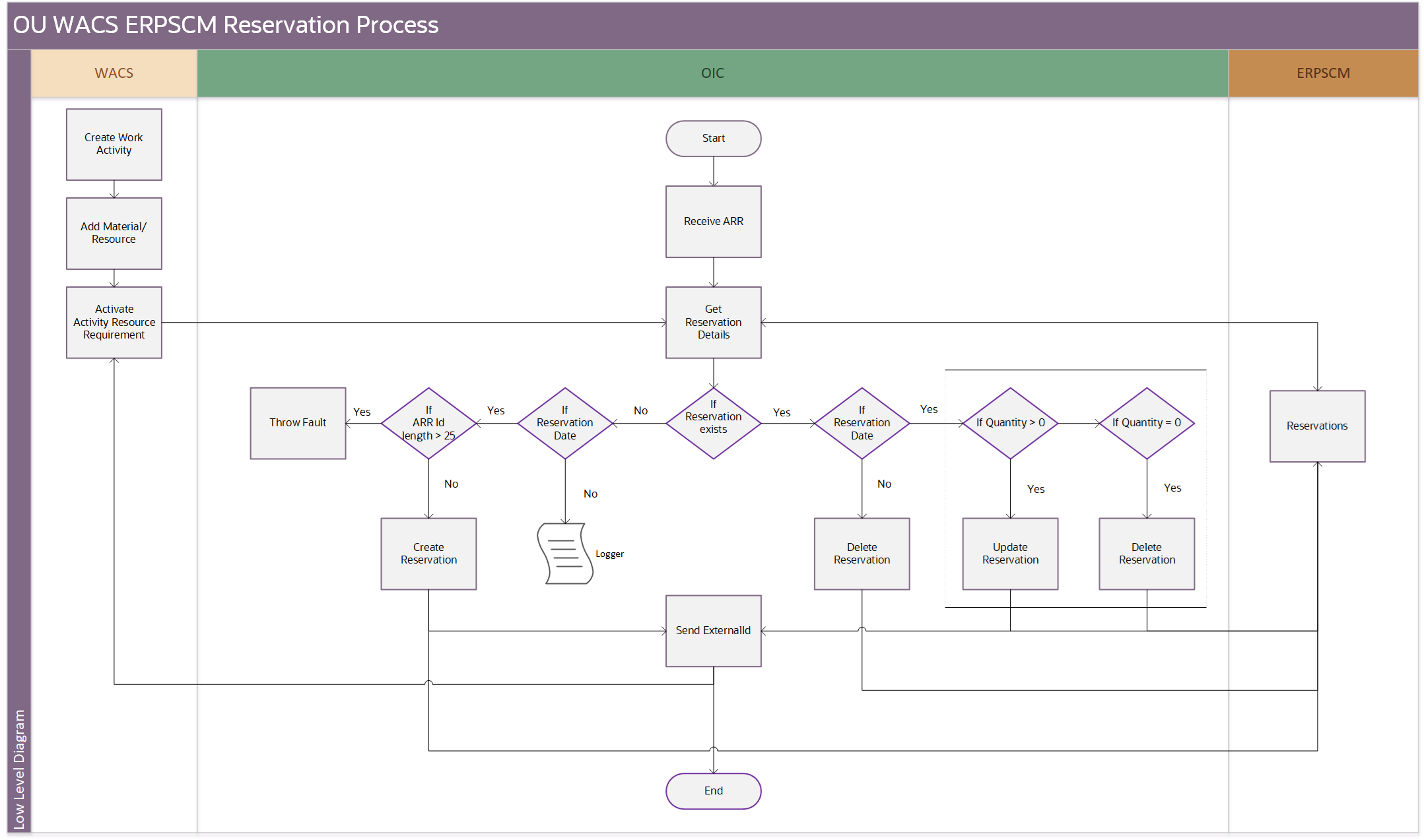

OU WACS ERPSCM Reservation Process
This integration sends activity resource requirements from Oracle Utilities Work and Asset Cloud Service to Oracle Supply Chain Management.
The following diagram shows a graphical representation of the OU WACS ERPSCM Reservation Process process:Shows a graphical representation of the OU WACS ERPSCM Reservation process.
Processing Details
• The integration process is application driven orchestration.
• The integration will be triggered when the Oracle Utilities Work and Asset Management/ Oracle Utilities Work and Asset Cloud Service activity planner creates an ARR.
a. The integration receives the ARR details from Oracle Utilities Work and Asset Cloud Service.
b. Invokes the Get Reservation ERP rest service with DemandSourceName, and InventoryItemId parameters.
c. If Reservation exists in ERP:
• Check for the reservation date.
• If the reservation date exists, check for the quantity.
• If the onDemandQuantity >0:
• Transforms the Oracle Utilities Work and Asset Management/ Oracle Utilities Work and Asset Cloud Service ARR data into the ERP Reservation format.
• Invokes the “Update Reservation” ERP rest service with ReservationId as the parameter.
• Transforms the response from ERP.
• Sends the response to Oracle Utilities Work and Asset Management/ Oracle Utilities Work and Asset Cloud Service.
• If the quantity = 0:
• Transforms ReservationId received from the GET Reservation API response.
• Invokes the “Delete Reservation” ERP rest service.
• Else, do not do anything.
• If there is no reservation date:
• Transforms the ReservationId received from the GET Reservation API response.
• If the deletion is successful, sends Reservation ID to Oracle Utilities Work and Asset Management/Oracle Utilities Work and Asset Cloud Service.
d. Else, if the reservation does not exist in ERP:
• If the reservation date exists:
• If the activityResourceRequirementId length is more than 25, throw fault.
• Else:
• Transforms the Oracle Utilities Work and Asset Management/ Oracle Utilities Work and Asset Cloud Service ARR data into the ERP reservation schema format.
• Invokes the “Create Reservation” ERP rest service.
• Send the Reservation ID to Oracle Utilities Work and Asset Management/Oracle Utilities Work and Asset Cloud Service.
• Else, if the reservation date is not present, the “No reservation date” message is printed in the log.
e. In case of success, the reservation ID is mapped to Oracle Utilities Work and Asset Management/Oracle Utilities Work and Asset Cloud Service.
f. In case of any errors:
• Fault is thrown.
• Invokes the OU WACS ERPSCM Common Error Handler flow in Global Fault Handler.
• OU WACS ERPSCM Common Error Handler flow sends an optional email notification based on the notification.error.flag property configured in the OUTL-BRT-WACS_ERPSCM_ConfigProps lookup.

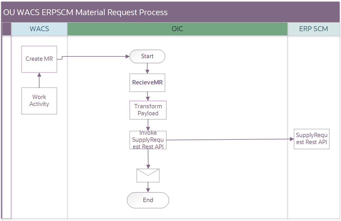

OU WACS ERPSCM Material Request Process
This integration synchronizes material request from Oracle Utilities Work and Asset Cloud Service to Oracle Supply Chain Management as a supply request.
The following diagram shows a graphical representation of the OU WACS ERPSCM Material Request process:Shows a graphical representation of the OU WACS ERPSCM Material Request process.
Processing Details
This Oracle Integration Cloud flow performs the following:
• It will be triggered from Oracle Utilities Work and Asset Cloud Service material request outbound.
• Transforms the Oracle Utilities Work and Asset Cloud Service request to the Oracle Supply Chain Management supply request format.
• Invokes the Supply Request REST API to create a supply request in Oracle Supply Chain Management.
• Sends the process completion email notification with all material line details, if the configuration property is enabled.
• If error records collection > 0, invoke the OU WACS ERPSCM Common Error Handler to send an error email notification.
Note: Sending the email notification is optional; this can be configured in the configuration properties lookup by setting the notification.email.error.flag to ‘true’.

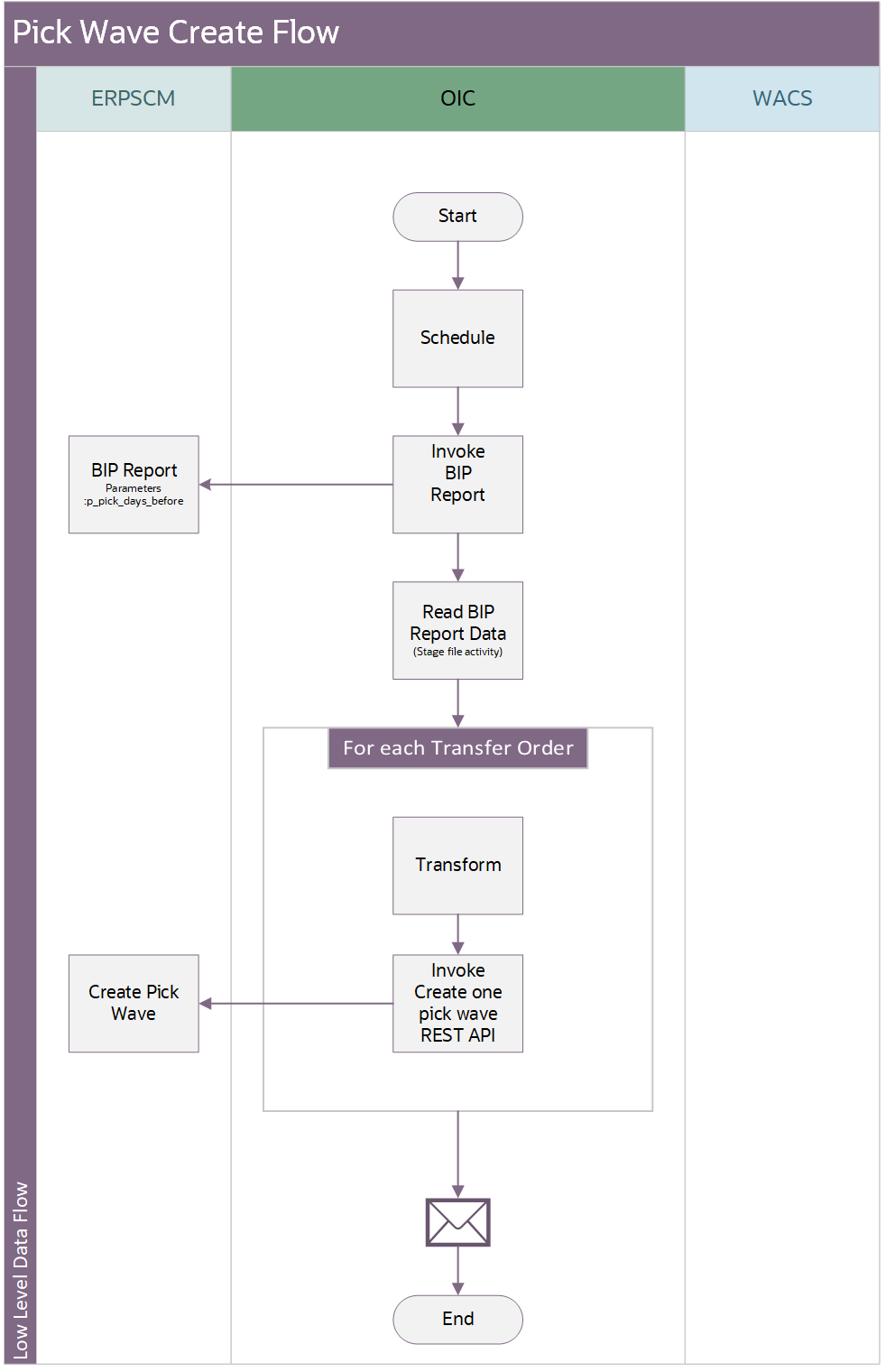

OU ERPSCM WACS Pick Wave Process
This integration creates Pick Wave transactions for all eligible transfer orders.
The following diagram shows a graphical representation of the OU ERPSCM WACS Pick Wave process:Shows a graphical representation of the OU WACS ERPSCM Material Request process.
Processing Details
• It is a scheduler driven integration.
• Invokes the BIP report service to get the eligible transfer order details from Oracle Supply Chain Management.
• Read the BI report data that is an XML file (using stage file activity).
• For each transfer order:
• Invokes the Get All Transfer Orders REST API.
• For each transfer order line:
• If wacsArrId in child transferOrderLineDFFs is not null:
• Invokes Get All Reservations REST API.
• If count !=0:
• If Reservation Qty > Requested Qty, update reservation.
• Else, delete reservation.
• Transform the record.
• Invoke the Create One Pick Wave REST API.
• In case of any errors:
• Append the fault details to the error collection.
• If error collection is not empty:
• Send the completion email with transfer order, pick wave number (PickingBatchName), and return message.

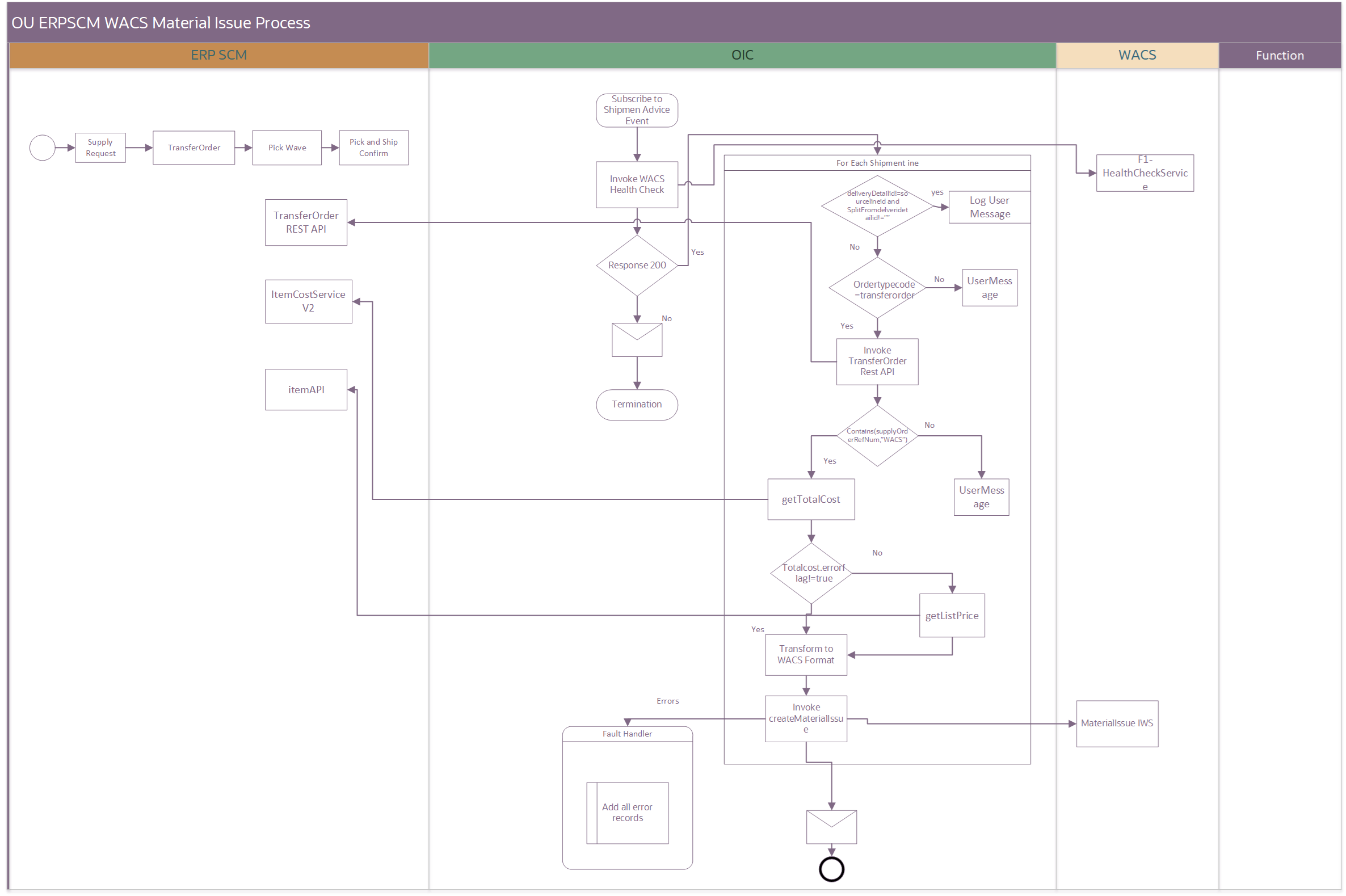

OU ERPSCM WACS Material Issue Process
This integration creates a materials issue in Oracle Utilities Work and Asset Cloud Service for the confirmed shipment lines from Oracle Supply Chain Management.
The following diagram shows a graphical representation of the OU ERPSCM WACS Material Issue process:
Processing Details
• This is an event-based orchestration flow.
• Subscribes the “Shipment Advice Event”.
• For each shipment line, repeats the following steps:
• If Check DeliveryDetailId != SourceLineId and SplitFromDeliveryDetailId != '':
• Then, log the “This is Back Order Line, hence not processing further.” message.
• Else:
• If Check Order Type Code=Transfer_Order:
• Then, get the transfer order details by invoking the REST API. Extract the transfer order details using stage activity for the corresponding item.
• If the Supply Order Reference Number contains “WACS”:
• Retrieve the Item Cost by invoking the Cost REST API with ItemNumber, OrganizationCode, and SubinventoryCode.
• If the response from Cost API is success, map the cost of item and transform into the WACS Material Issue Rest API input data format.
• Else, get the List Price from the Item REST API.
• Map the list price of item and transform into the WACS Material Issue Rest API input data format.
• Invoke the Material Issue REST API.
• Else, log the “Transfer Order Not generated from WACS.” message.
• Else, log the “It is not Transfer Order.” message.
• If the error records created send an email with the collected error information, send a completion email notification.
Note that the Shipment Advice Event should be enabled in Oracle Supply Chain Management.

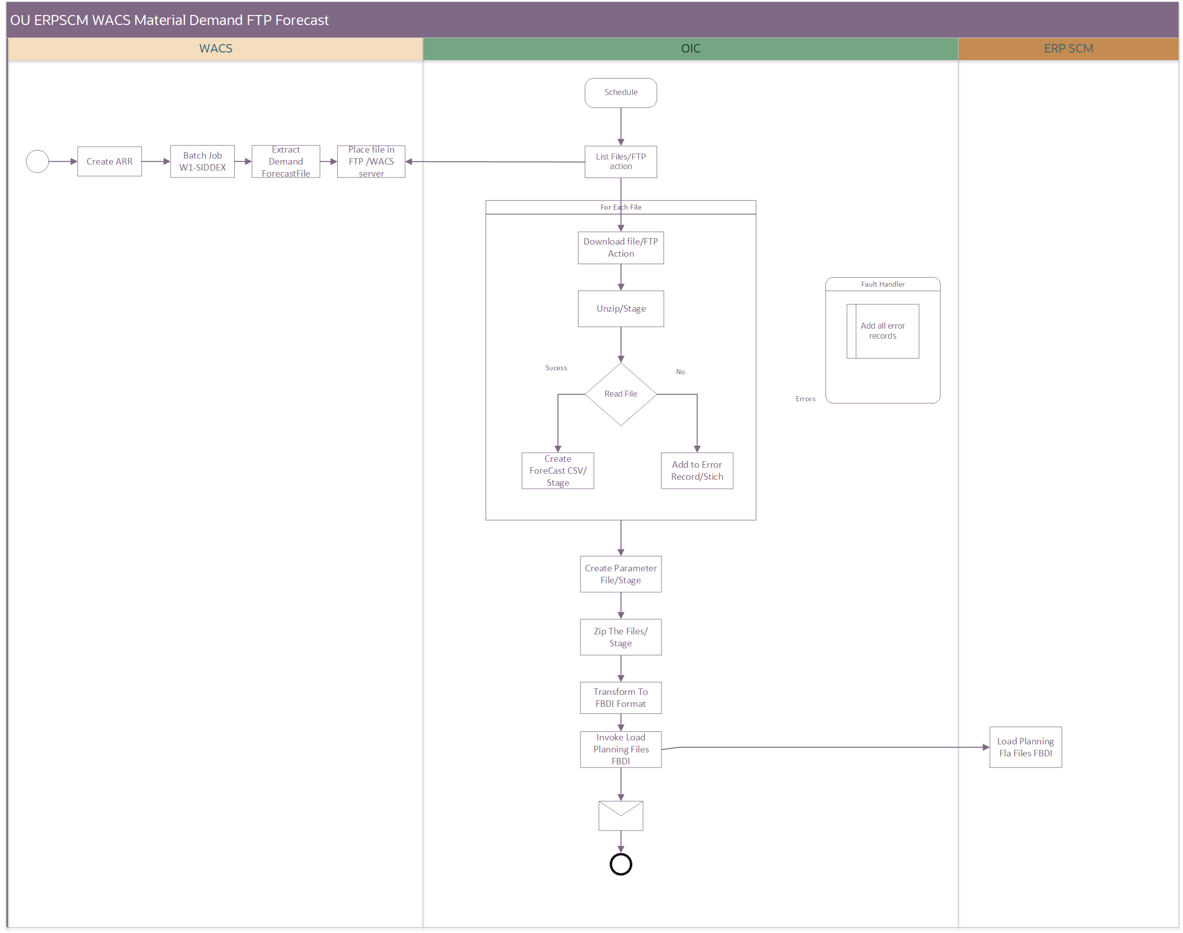

OU WACS ERPSCM Material Demand FTP Forecast
This integration reads the Oracle Utilities Work and Asset Cloud Service batch file from FTP for Material Demand, transform it to the target schema, and upload it as external forecast in Oracle Supply Chain Management Planning through external forecast FBDI.
The following diagram shows a graphical representation of the OU WACS ERPSCM Material Demand FTP Forecast:
Processing Details
• This is a scheduled orchestration flow.
• Lists all files with the “ERPFORECAST” prefix by invoking the List Files operation of the FTP Adapter Connection.
Note: Make sure the file name pattern is in the “ERPFORECAST_{BC}_{BN}_{TN}.csv.zip” or “ERPFORECAST_{BC}_{BN}_{TN}.csv” format.
• Extract the latest batch number by using time stamp.
• For each file, repeats the following steps:
• If the file name contains latest batch number, then it will pick the latest batch files to process and mark the other older files names with the ‘Excluded-’ prefix.
• Download the file by invoking the Download operation of the FTP Adapter connection.
• Read the file. Create the ERPFORECAST CSV file and rename it to “ExternalForecast.csv”.
• Append all the file records to the csv file.
• Create the “ScpErpIntegrationServiceParams.csv” parameter file.
• Combine the parameter and csv files and zip them.
• Transform and assign the zip file reference into the “Load Planning Data from Flat Files” FBDI format.
• Invoke the “Load Planning Data from Flat Files” FBDI in Oracle ERP Cloud Adapter.
• If there are multiple files in the same batch and a file fails to process, then:
• The error notification is sent to the user.
• The name of the file that failed to process is prefixed with “Error-”.
• Other files in the same batch are maked as “NotProcessed-”.
Technical Details

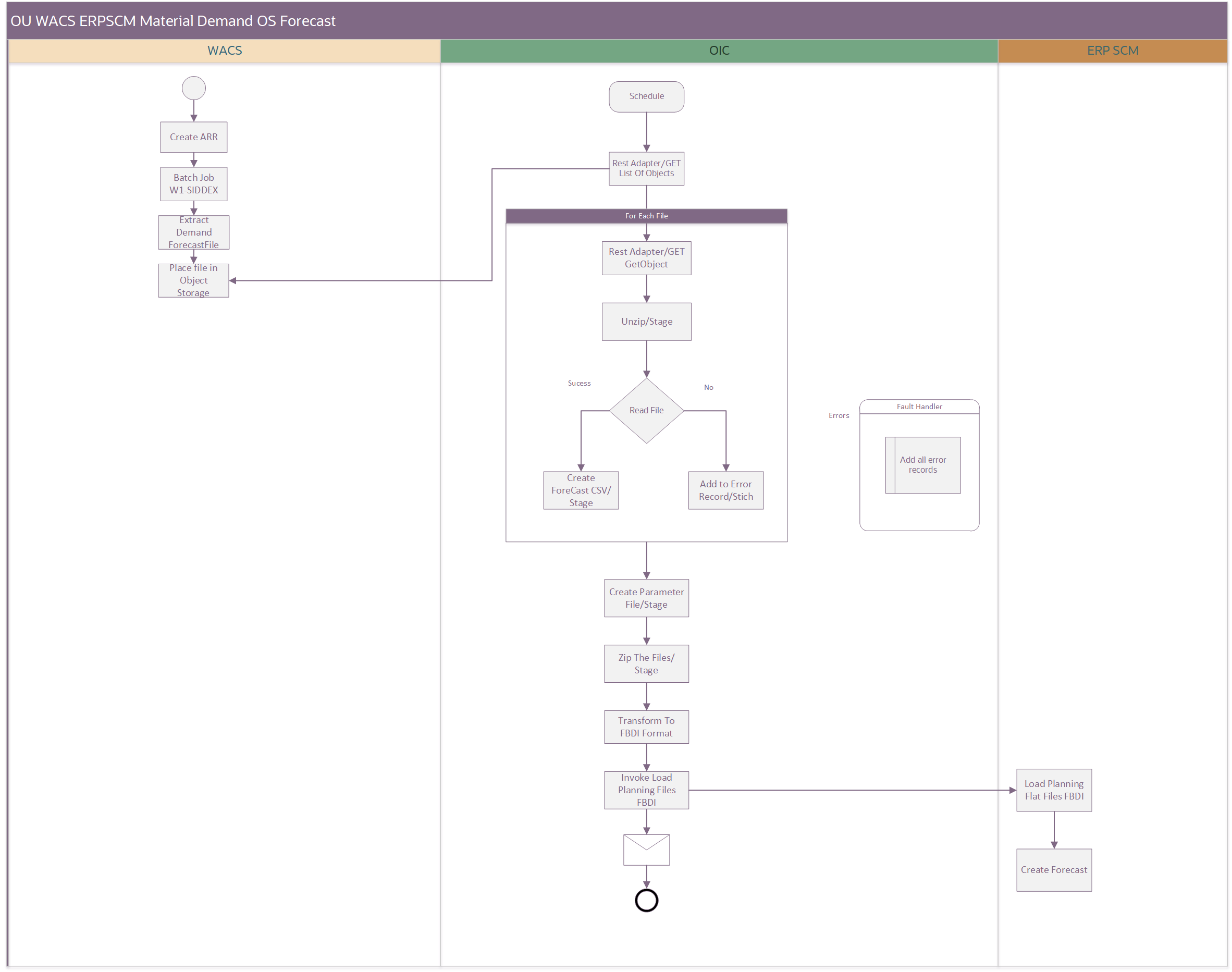

OU WACS ERPSCM Material Demand OS Forecast
The integration reads the Oracle Utilities Work and Asset Cloud Service batch file from Object Storage for Material Demand, transform it to the target schema, and upload it as external forecast in Oracle Supply Chain Management Planning through external forecast FBDI.
The following diagram shows a graphical representation of the OU WACS ERPSCM Material Demand OS Forecast:
Processing Details
• Lists all files with the “ERPFORECAST” prefix by invoking the Get List Of Objects operation of the REST Adapter Connection.
• Extracts the latest batch number by using time stamp.
• If the file name contains latest batch number, then it will pick the latest batch files to process and mark the other older files names with the “Excluded-” prefix.
• Download the file by invoking the Get Object operation of the REST Adapter connection.
This application driven integration gets a collection of error records from the other integration processes the integration.
The following diagram shows a graphical representation of the OU WACS ERPSCM Common Error Handler process:
Processing Details
This integration process is an application driven orchestrator deployed on Oracle Integration Cloud. It is initiated when the other integration process throws an error. It is executed as follows:
1. The process gets a collection of error records.
2. Initialize the variables.
3. If the notification flag is set to ‘true’:
• If the notification type is set to 'email':
• Send errors as attachment.
• Write the error records header to a CSV file using the stage file activity.
• Write the error records to a CSV file using the stage file activity, with 'Append' option selected.
4. Send email notification with the CSV file reference.
5. Else, invoke the getHTMLdata JS extension function to display the error details in a tabular format.
6. Send an email notification.
