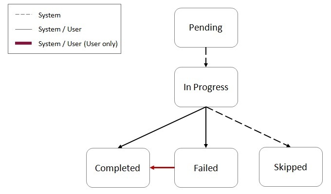

Infrastructure Process Step Lifecycle
A process steps is created in Pending status and is transitioned to In Progress by the process logic when its turn to execute arrives.
When a step is In Progress, the following transitions are possible:
Transition the step into Completed status upon successful completion of the step’s work or by selecting the Complete action.
Transition the step into Failed status when an error was detected during the step’s work or by selecting the Fail action.
Steps may include logic that will transition the step into Skipped status if that logic determines that the step should not be executed.
When the step is In Progress, selecting the Job Status action will display information about the job running status (if it is a batch job type of step).
When a step is in Failed status it is still possible to manually transition the step into Completed status.
