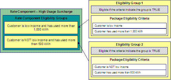

Before we provide examples of eligibility criteria, we need to explain two concepts: Criteria Groups and Eligibility Criteria. A rate component's criteria groups control whether rate application executes a rate component. At a high level, it works like this:
  • A criteria group has one or more eligibility criteria. A group's criteria control whether the group is considered TRUE or FALSE.
  • When you create a group, you define what should happen if the group is TRUE or FALSE. You have the following choices:
    • The rate component should be applied
    • The rate component should be skipped
    • The next group should be checked
We'll use the following example to help illustrate these points. Assume a rate component is only eligible if:
  • The customer is a low income customer and has used more than 1,000 kWh
  • OR, the customer isn't a low income customer and has used more than 500 kWh
This illustrates Criteria Groups and Eligibility Criteria. A rate component's criteria groups control whether rate application runs a rate component. A criteria group has one or more eligibility criteria. A group's criteria control whether the group is considered TRUE or FALSE. When you create a group, you define if the rate component should be applied, if the rate component should be skipped, or if the next group should be checked when the group is TRUE or FALSE.
This rate component requires two eligibility groups because it has two distinct conditions:
  • IF (Customer is low income AND the customer has used more than 1,000 kWh)
  • IF (Customer is NOT low income AND the customer has used more than 500 kWh)
If either condition is true, then the rate component is eligible.
