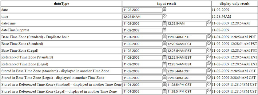

<html>
<body oraSchemaDataTypes="true">
<table border="1" cellpadding="1" cellspacing="1">
<tr><th>dataType</th><th>input result</th><th> display-only result</th></tr>
<tr>
<td>date</td>
<td><input oraField="schemaDate" oraType="date;"/></td>
<td><span oraField="schemaDate" oraType="date;"></span></td>
</tr>
<tr>
<td>time</td>
<td><input oraField="schemaTime" oraType="time;"/></td>
<td><span oraField="schemaTime" oraType="time;"></span></td>
</tr>
<tr>
<td>dateTime</td>
<td><input oraField="schemaDateTime" oraType="dateTime;"/></td>
<td><span oraField="schemaDateTime" oraType="dateTime;"></span></td>
</tr>
<tr>
<td>dateTimeSuppress</td>
<td><input oraField="schemaDateTimeSup" oraType="dateTime; time:suppress"/></td>
<td><span oraField="schemaDateTimeSup" oraType="dateTime; time:suppress"></span></td>
</tr>
<tr>
<td>Base Time Zone (Standard)</td>
<td><input oraField="schemaDateTimeStd" oraType="dateTime; stdTime:true;"/></td>
<td><span oraField="schemaDateTimeStd" oraType="dateTime; stdTime:true;"></span></td>
</tr>
<tr>
<td>Base Time Zone (Legal)</td>
<td><input oraField="schemaDateTimeLgl" oraType="dateTime; legalTime:true;"/></td>
<td><span oraField="schemaDateTimeLgl" oraType="dateTime; legalTime:true;"></span></td>
</tr>
<tr>
<td>Referenced Time Zone (Standard)</td>
<td><input oraField="schemaDateTimeStdRef" oraType="dateTime; stdTimeRef:timeZone;"/></td>
<td><span oraField="schemaDateTimeStdRef" oraType="dateTime; stdTimeRef:timeZone;"></span></td>
</tr>
<tr>
<td>Referenced Time Zone (Legal)</td>
<td><input oraField="schemaDateTimeLglRef" oraType="dateTime; legalTimeRef:timeZone;"/></td>
<td><span oraField="schemaDateTimeLglRef" oraType="dateTime; legalTimeRef:timeZone;"></span></td>
</tr>
<tr>
<td>Stored in Base Time Zone (Standard) - displayed in another Time Zone</td>
<td><input oraField="schemaDateTimeStdDisp" oraType="dateTime; stdTime:true; displayRef:timeZoneDisp;"/></td>
<td><span oraField="schemaDateTimeStdDisp" oraType="dateTime; stdTime:true; displayRef:timeZoneDisp;"></span></td>
</tr>
<tr>
<td>Stored in Base Time Zone (Legal) - displayed in another Time Zone</td>
<td><input oraField="schemaDateTimeLglDisp" oraType="dateTime; legalTime:true; displayRef:timeZoneDisp"/></td>
<td><span oraField="schemaDateTimeLglDisp" oraType="dateTime; legalTime:true; displayRef:timeZoneDisp"></span></td>
</tr>
<tr>
<td>Stored in a Referenced Time Zone (Standard) - displayed in another Time Zone</td>
<td><input oraField="schemaDateTimeStdRefDisp" oraType="dateTime; stdTimeRef:timeZone; displayRef:timeZoneDisp"/></td>
<td><span oraField="schemaDateTimeStdRefDisp" oraType="dateTime; stdTimeRef:timeZone; displayRef:timeZoneDisp"></span></td>
</tr>
<tr>
<td>Stored in a Referenced Time Zone (Legal) - displayed in another Time Zone</td>
<td><input oraField="schemaDateTimeLglRefDisp" oraType="dateTime; legalTimeRef:timeZone; displayRef:timeZoneDisp"/></td>
<td><span oraField="schemaDateTimeLglRefDisp" oraType="dateTime; legalTimeRef:timeZone; displayRef:timeZoneDisp"></span></td>
</tr>
</table>
</body>
<xml>
<root>
<timeZone>US-EASTERN</timeZone>
<timeZoneDisp>US-CENTRAL</timeZoneDisp>
<schemaDate>2007-11-02</schemaDate>
<schemaTime>23.45.00</schemaTime>
<schemaDateTime>2007-11-02-23.45.00</schemaDateTime>
<schemaDateTimeSup>2007-11-02-23.45.00</schemaDateTimeSup>
<schemaDateTimeStd>2007-11-02-23.45.00</schemaDateTimeStd>
<schemaDateTimeStdRef>2007-11-02-23.45.00</schemaDateTimeStdRef>
<schemaDateTimeLgl>2007-11-02-23.45.00</schemaDateTimeLgl>
<schemaDateTimeLglRef>2007-11-02-23.45.00</schemaDateTimeLglRef>
<schemaDateTimeStdDisp>2007-11-02-23.45.00</schemaDateTimeStdDisp>
<schemaDateTimeStdRefDisp>2007-11-02-23.45.00</schemaDateTimeStdRefDisp>
<schemaDateTimeLglDisp>2007-11-02-23.45.00</schemaDateTimeLglDisp>
<schemaDateTimeLglRefDisp>2007-11-02-23.45.00</schemaDateTimeLglRefDisp>
</root>
</xml>
</html>
HTML 的轉譯結果。
當元素與時區相關聯時,會顯示對應的時區名稱與值。這在參考為「基準時區 (標準) - 重複小時」的範例中特別有用。時間 1:28 不明確 (不含時區標籤)。法律上,由於日光節約時間 (DST) 會在 2:00 AM 結束,所以 2009 年 11 月 1 日 1:28 AM 會出現兩次。時區名稱指出是指定時區的第一個小時還是第二個小時。
