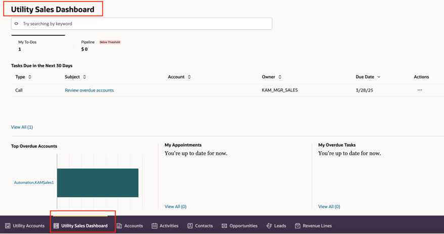

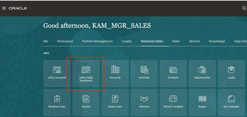

You can use VB Studio to rename the Sales Dashboard screen and menu options in Redwood Sales to "Utility Sales Dashboard". Use these instructions after you have configured the Redwood Sales interface to display utility data on this screen. After making this change, users who should have access to utility data when viewing this screen will see the updated name. This use case is specific to CX for Utilities Sales.
Figure 14-10 Utility Sales Dashboard Screen
Figure 14-11 Utility Sales Dashboard Menu Option
