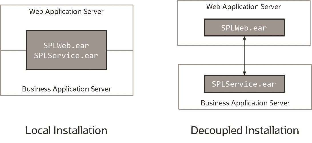

It is possible for the business application server’s logic to be separated from the Web Application Server component. Essentially, Oracle Utilities Digital Asset Management has been split into TWO distinct EAR files:
• SPLWeb.ear (SPLWEBAPP - Name of Web Application Server Application) – This contains the Web application server component for the product.
• SPLService.ear (SPLSERVICEAPP - Name of Business Application Server Application) – This contains the business application server component for the product.
There are two modes of installation:
• Local Installation (also applicable to
expanded installations for Development environments) - The Web application server and Business Application are on the same instance of the JEE Web application server. This is the
default behavior of the product for backward compatibility. If this is the mode installed then for configuration the process is a combination of the
Web Application Server Configuration and
Business Application Server Configuration configuration and deployment process.
Note: Local installations are recommended for all environments.
Note: For customers using Oracle ExaLogic, Oracle highly recommend that local installations be used for performance reasons.

As previously mentioned, the Business Application Server component can be deployed within a separate instance of the JEE Web Application Server software. This effectively allows the business application server to be on separate hardware for architectures where this is a requirement. Typically this separation is implemented for a number of reasons:
• The site has an architectural principle for separating the web and the business application servers.
• The site prefers to optimize the individual servers for the individual tiers rather than having to compromise when two or more tiers are on the same platform.

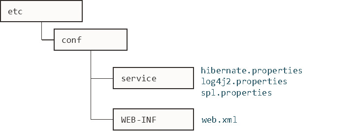

Each JEE web application within the JEE web application server has its own configuration files. These files are typically embedded within the WAR/EAR files deployed with the product following the JEE specification (refer the discussion of allowing the externalization of configuration settings for alternative methods). In terms of configuration, Oracle Utilities Digital Asset Management structure within the WAR/EAR file looks like the following:

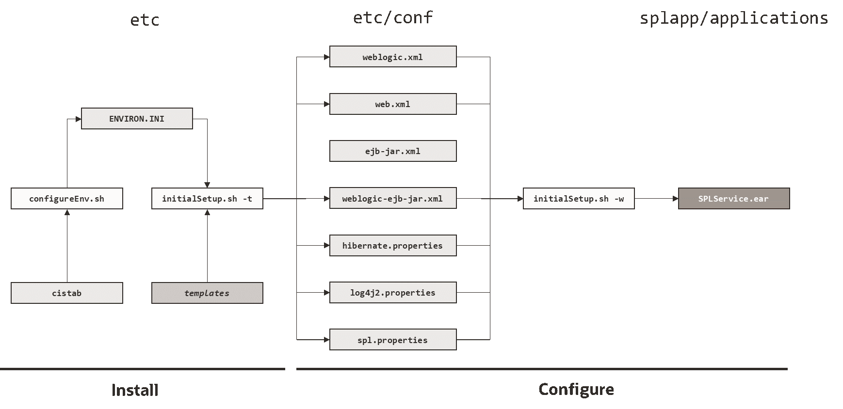

Business Application Server Configuration Process
To configure the business application server during the installation process and post-installation then the following process should be used:
• The configureEnv – Set up Environment Settings utility is used during installation time and can be used post implementation to set parameters in the ENVIRON.INI. If any parameters are derived or set from the ENVIRON.INI (see the Source column in the relevant section) then the ENVIRON.INI utility should be used to maintain them.
Note: The ENVIRON.INI utility should be used to make ANY changes to the ENVIRON.INI. Manual changes to this configuration file are not recommended.
• After the ENVIRON.INI has been set or altered, the settings must be reflected in the relevant configuration files used by the business application server by running the initialSetup (see for details):

• The utility uses the templates from the templates directory to create substituted copies of these files in a standard location:
The locations of the configuration files can be summarized in the following figure:
• At this point you may perform manual changes to the above files to parameters not implemented in the ENVIRON.INI.
Note: Any manual changes are overwritten after running the initialSetup utility unless the change is reflected in the appropriate template (see initialSetup – Maintain Configuration Settings for more information). Backups should be made of any changes and then manually reapplied to reinstate all manual changes.
• To reflect configuration changes into the product Business EJB Applications the initialSetup utility, with the –w option, must be executed (see initialSetup – Maintain Configuration Settings). This will build the necessary spl-servicebean-<version>.jar (where <version> is the version of the product used) and the SPLService.ear EAR file (or name set by SPLSERVICEAPP - Name of Business Application Server Application) to be deployed into the Oracle Weblogic Domain. This step is optional if configuration overrides are in use (refer the discussion of allowing the externalization of configuration settings for alternative methods).
• Depending on the architecture used, the initialSetup will generate one or more EAR files.
At this point the product business applications are ready for deployment into the Oracle Weblogic Domain.

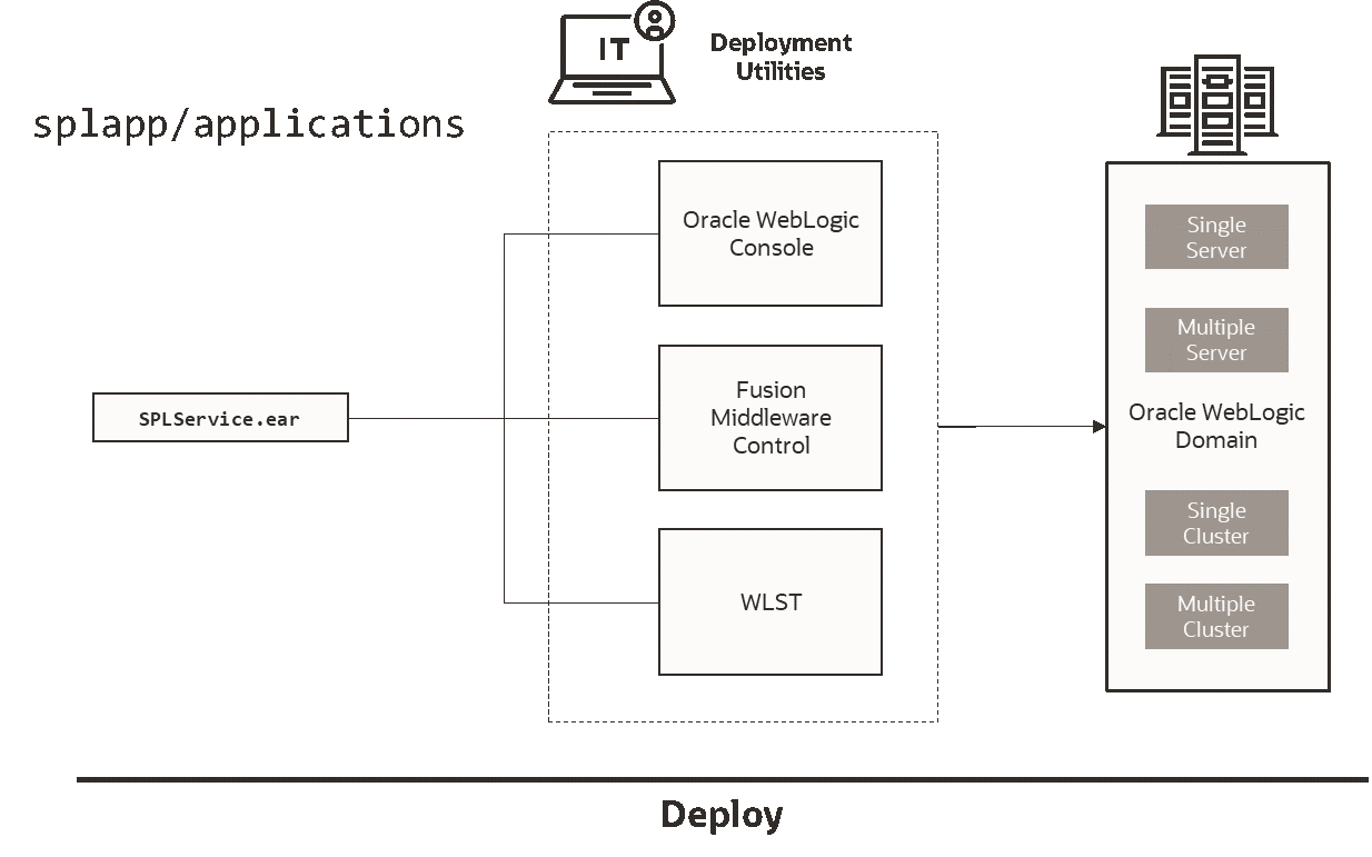

Business Application Server Deployment Process
After the configuration of the business application server is complete (as outlined in Business Application Server Configuration Process), the final step to implement Oracle Utilities Digital Asset Management technically is to deploy the product within the JEE Web application server.
There are three methods of deploying the product within the JEE web application server:
• Use the deployment utilities provided on the console of the JEE web application server. The WAR/EAR files that are available under $SPLEBASE/splapp/applications can be manually deployed using the console. Refer to the Installation Guide for specific platform instructions, and to the Administration Guide for the JEE web application server.
• Use the deployment utilities provided on the command line of the JEE Web application server. The WAR/EAR files that are available under $SPLEBASE/splapp/applications can be manually deployed using the JEE Web application server vendor supplied deployment command line utilities. Refer to the Installation Guide for specific platform instructions and the administration guide for the JEE Web application server.
• Several specific utilities for JEE Web Application are provided with the product to deploy the EJB Application to the JEE Web application server. These call the same utilities provided in the previous option but are provided with the product.
This section will outline the latter option.
Several specific utilities from Oracle WebLogic are provided with the product to deploy the Web Application to the domain.
• Use the WebLogic console, Fusion Middleware Control or WLST to deploy/redeploy the EAR files.
