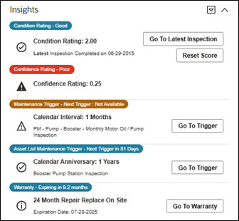

Insights Zone
The Insights zone displays visual insights for Condition Rating, Confidence Rating, Maintenance Trigger, Asset List Maintenance Trigger, and Warranty. Each insight includes a badge, and all except Condition Rating show a list of common actions.
Example of an Insights Zone.

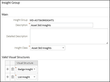

Insight Group
An insight group is required to display the Insights for this zone.
Create a new insight group for the Asset 360 Insights:
  • Insight Class: Asset 360 Insights
  • Valid Visual Structures:
    • Badge Insight
    • List Insight
Example of an Insight Group

Condition Rating Insight
Example of a Condition Rating Insight
The Condition Rating insight includes two types; a badge and a list. It displays the Condition Rating Score, a description (as defined in the bucket configuration), and the asset's last inspection.
Example of Condition Rating Insight Type
The following actions are also available in the Condition Rating insight:

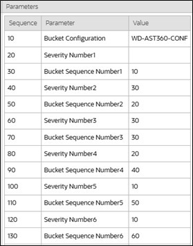

Algorithm Parameters
Once the Condition Rating bucket configuration is set up, edit the Asset 360 Condition (W1ASTCOND) algorithm to add the new algorithm parameter values:
  • Bucket Configuration: The bucket configuration you created above
  • Severity Number 1-10: The Override Severity Value for it's corresponding Bucket Sequence Number. Leave blank to use the default visual setting.
  • Bucket Sequence Number 1-10: Sequence numbers defined in the Bucket Value Ranges
For example, to display a red badge (override value = 30) for a Poor (bucket value sequence number) Condition Rating:
  • Severity Number: 30
  • Bucket Sequence Number: 50
Example of Bucket Severity Values
