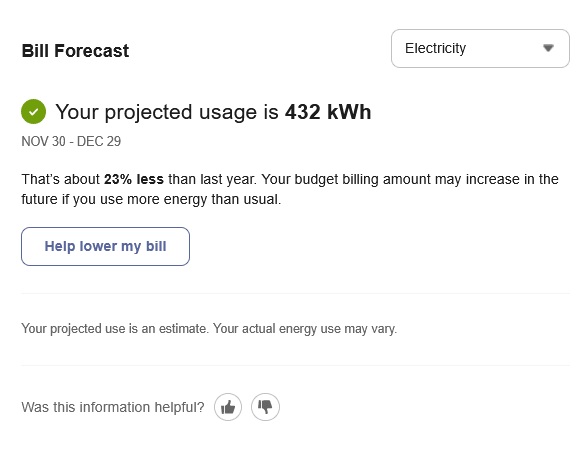

Budget Billing Experience
Budget billing is a type of billing in which the customer pays a set amount of money each bill period for their energy use. This amount may be adjusted each year depending on factors such as inflation and the customer's overall energy use patterns.
For budget billing customers, the Bill Forecast includes an additional message encouraging them to lower their usage since their future budget billing amount may increase if they use more than usual.
This image is an example of the bill forecast showing a message about how the budget billing amount may increase the customer uses more energy than usual.

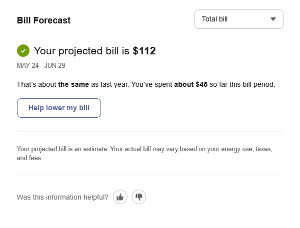

Combined Fuel Bill Forecast
The Bill Forecast for dual fuel customers can show a forecast for combined gas and electric costs. In this case, the forecast displays a drop-down menu which includes a bill forecast of a customer's total gas and electricity costs. This is meant to match how dual fuel customers often think of their utility bill as one entity, as opposed to separate gas and electricity charges.
Screenshot of a combined fuel bill forecast.

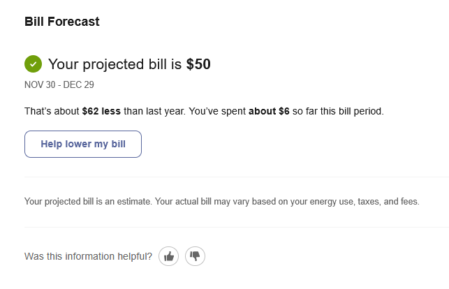

Low Cost Forecast
The customer has a cost baseline and an estimated bill period date range, and is using less than their baseline.
Screenshot of bill forecast projecting that the customer will use less than their baseline comparison cost.

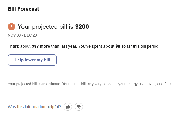

High Cost Forecast
Customer has a baseline cost and estimated bill period date range, and is using more than 30% above their baseline.
Screenshot of bill forecast projecting that the customer will use more than 30 percent of their baseline comparison cost.

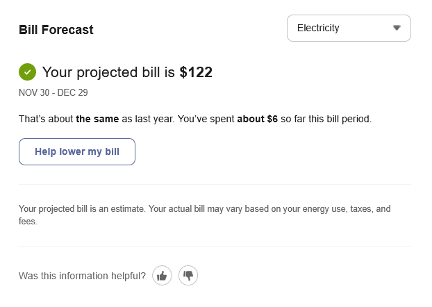

Similar Cost Forecast
Customer has a baseline cost and estimated bill period date range, and is using 0 - 30% above their baseline. This means that the customer is projected to use about the same as their baseline cost.
Screenshot of a forecast for a customer who has a baseline cost and an estimated bill period date range. The customer is using about the same as their baseline.

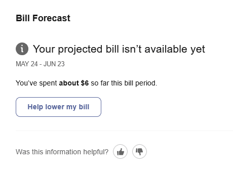

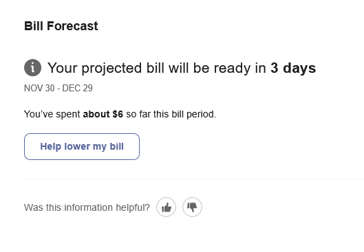

Days Until Forecast Ready and Cost to Date
Customer sees a message that their cost forecast will be available soon and is shown their cost-to-date in the meantime. A forecast is not shown in this case because seven days in the bill period have not yet passed. This is done to avoid a forecast based on too little data.
Screenshot of a bill forecast saying a projection will be ready soon. A cost-to-date is displayed in the meantime.

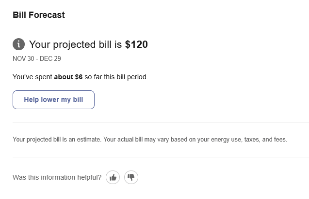

Cost Forecast Displayed as a Range
Utilities can display a numeric range rather than a single value for the forecast. For example, if a customer's projected bill is $100, and the cost range is configured to be 15%, then the forecast message would state something like, "Your project bill is $100-$115".
A range can only be displayed for cost forecasts. A range cannot be enabled for usage forecasts.

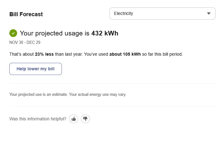

Usage Forecast
If rates are not modeled for the customer, then an energy use forecast is shown instead. The variations of the energy use forecast are identical to those of the cost forecast variations, except the forecast is shown in a kilowatt-hour (kWh) value. To provide context, the comparison message includes the percentage that this value represents.
Screenshot of a usage forecast. The projected usage is expressed in kilowatt-hours as opposed to a monetary amount.

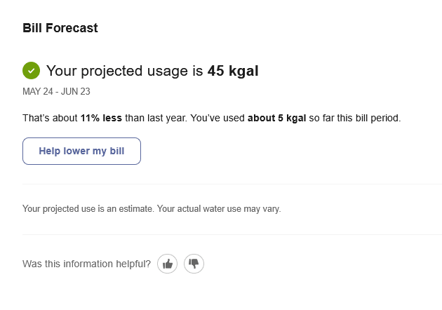

Water and Wastewater Experience
This experience is only available when the Bill Forecast is integrated as part of Digital Self Service - Transactions.
In this experience, customers can see a forecast of their water and wastewater service. The options to view water and wastewater are included for selection in a drop-down menu. If rates are not modeled, customers are presented with a usage forecast, as shown in the example image below.
Image of a projected bill showing the number of gallons of water the customer used between April and May
