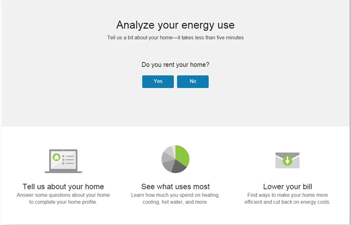

Pre-Survey
For customers who have not yet started the survey, the Home Energy Analysis displays information about the survey and provides the first question to begin the analysis. This messaging can include information on the estimated time it would take to complete the survey, as well as the benefits of completing the analysis. Customers who select to take the survey are directed to the full survey.
This experience is provided as part of the
widget-survey
widget. It must be placed alongside the
post-survey experience (widget-disaggregation
) to
provide a single, authenticated location for customers to interact
with the Home Energy Analysis. This pre-survey content is fully
hidden for customers after they complete the survey.
To support this behavior, the widget must define an
opower-instance
attribute as part of the embedded tag.
The full embedded tag definition is as follows:
<opower-widget-survey opower-instance="widget-survey-splash"></opower-widget-survey>
If a customer starts but does not complete the survey, progress information and a link to complete the survey is displayed. This experience is provided through the embeddable widget and redirects customers to the survey, which must also be embedded on a separate page.

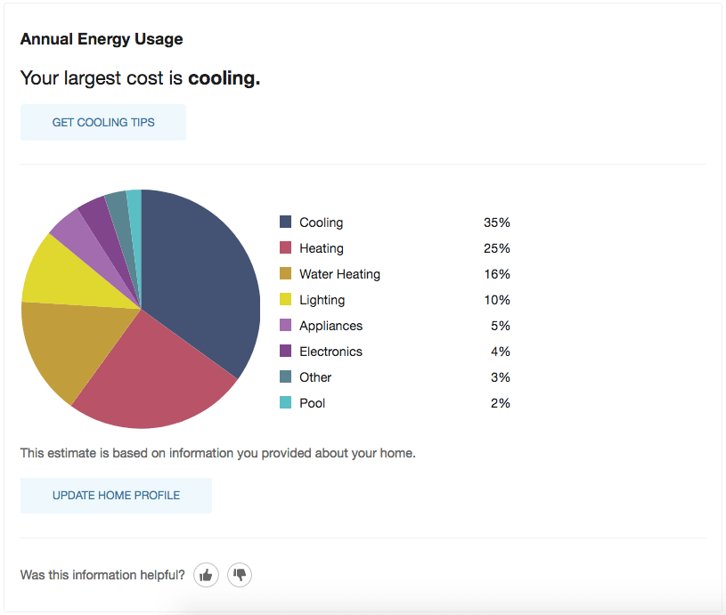

Disaggregation
After the customer answers the last question and finishes the survey, the Home Energy Analysis displays their energy use breakdown based on their responses. Customers can select each individual energy use category to see what percentage of their home’s energy use it comprises, category-specific tips, and a list of what contributes to energy use for the category.
alongside the pre-survey experience to provide a single location
for customers to interact with the Home Energy Analysis. This
content is fully hidden for customers until they complete the
survey. To support this behavior, the widget must define an
opower-instance
<opower-widget-disaggregation opower-instance="widget-disaggregation"></opower-widget-disaggregation>
Embed this widget in proximity to billing information to provide further context and insights into a customer's energy costs.
