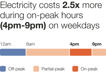

Demand Charge
This image is an example of the Mini Time of Use Reminder module for a customer with demand charge rate in addition to the Time of Use plan.
Mini Time of Use with demand charge
If the customer has demand charging, then the user experience varies as follows.
Header: The header informs the customers when the demand charge occurs.
Weekday High Cost Period Start Time: The time the peak period will start. For example, 4pm.
  • Weekday High Cost Period End Time: The time the peak period will end. For example, 9pm.
  • Cost Period Bar: The cost period bar provides a visual representation of the high cost period.
Cost Period Colors: The cost period provide the customer with a visual cue to draw their attention to the most crucial times to save every during peak events.
  • High Cost Period Color: The high cost period is indicated by a warning-color to provide a visual cue to the customer to take heed of this time period. This is the period when demand charging occurs. In the example image, the "on-peak" period is indicated by a dark orange warning color.
  • Medium Cost Period Color: The low cost period is indicated by a medium color. In the example image, the "partial-peak" period is indicated by a light orange color.
  • Low Cost Period Color: The lowest cost period is indicated by a cool color. In the example image, the "off-peak" period is indicated by a cool blue color.
Cost Period Legend: The cost period legend defines which colors represent cost periods in the cost period bar.
