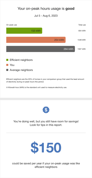

The Peak Focused Normative Comparison module educates customers about how their energy use compares to their neighbors. It compares the customer (“You”) to “Efficient Neighbors” and “Average Neighbors,” and provides the customer with an comparison state (such as fair, good, or great) to help them measure how their electricity use is compared to these neighbors. The results are displayed in a horizontal bar graph. Total electricity usage values are also displayed so the customer can have a better understanding of what their peak use is compared to their total use.

The image below is an example of the peak-focused normative comparison.
img/eherv3-peakfocus-pfnc-good-nosmile-300x582.png
