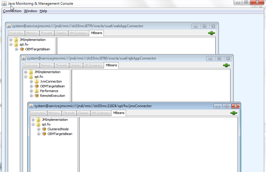

JMX should be configured on the target environment. To test this, use jconsole and connect to the JMX servers using the JMX URLs. You can search the WebLogic log for the Web and EJB JMX URLs. Examples:
service:jmx:rmi:///jndi/rmi://{host}:{ejbJmxPort}/oracle/ouaf/ejbAppConnector service:jmx:rmi:///jndi/rmi://{host}:{webJmxPort}/oracle/ouaf/webAppConnectorThe threadpoolworker logs would have the batch JMX URLs. For example,
service:jmx:rmi:///jndi/rmi://{host}:{batchJmxPort}/oracle/ouaf/batchConnectorIn FW 2.2, this would be

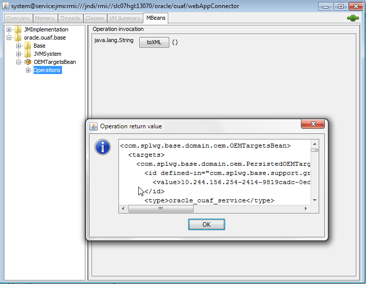

service:jmx:rmi:///jndi/rmi://{host}:{batchJmxPort}/spl/fw/jmxConnectorMake sure you can connect to the URLs and that the OEMTargetsBean is present, as illustrated in the following image:
Note: Here, the host should be fully qualified domain name.
Expand the OEMTargetsBean, click Operations, then click the toXML button. A window should popup and return the XML of the targets that will be discovered. Do this for each JMX connection.

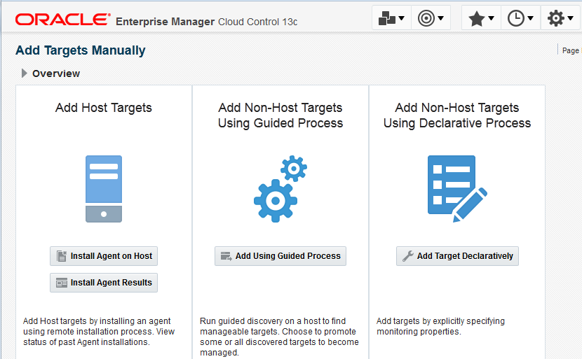

Discover the WebLogic domain and Fusion middleware using guided discovery. On the grid console, go to . Select the following options on the page:
Click Add Using Guided Process, enter the entries for the WebLogic admin server, then continue until the WebLogic domain/Fusion middleware is discovered.

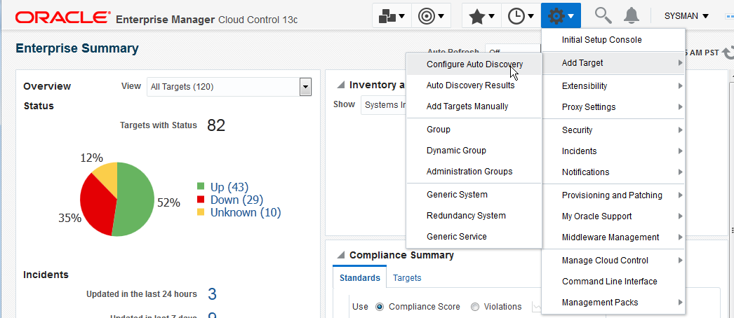

- Log in to Enterprise Manager.
- Choose .
Figure 1. Selecting Auto Discovery

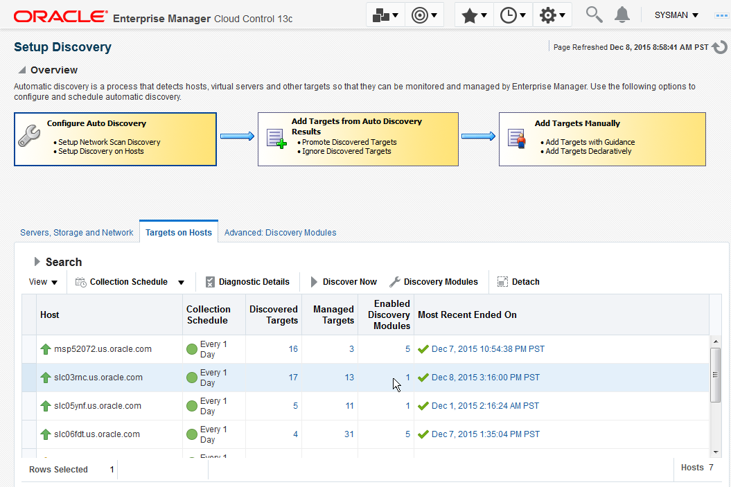

- On the Setup Discovery page, click the host where discovery is to be run, then click the Discovery Modules button.
Figure 2. Setup Discovery

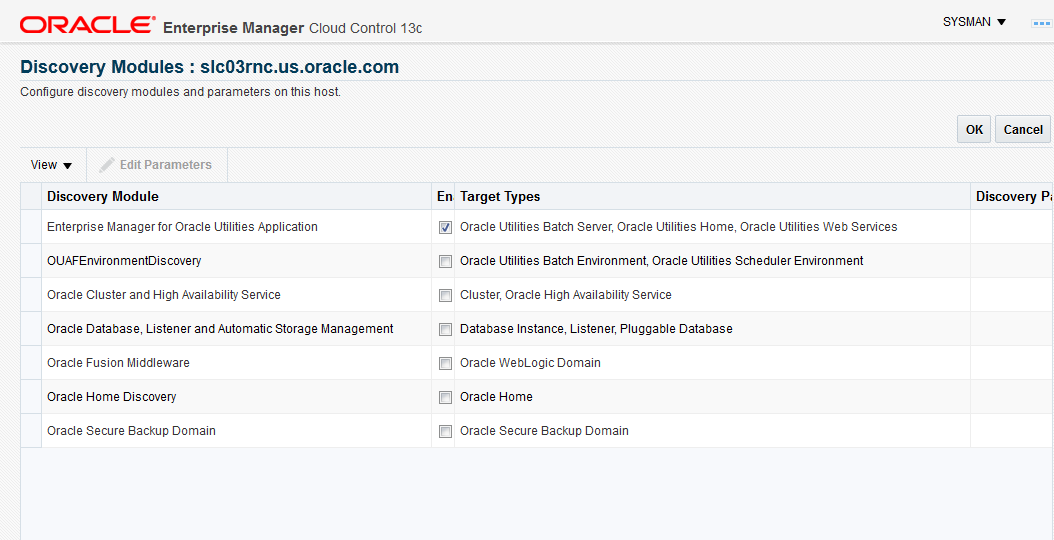

Ensure that the Enterprise Manager for Oracle Utilities module is on the
Discovery Module list.
Figure 3. Verifying the module

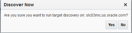

- Once back on the Setup Discovery page, select the host again to enable the buttons at the top. When the desired host is selected, click the Discover Now button.
Figure 4. Running the discovery
The Target Discovery (Agent Based) window opens.
- Click OK in the Discover Now dialog to confirm that you want to run the discovery.

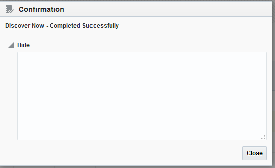

- A confirmation dialog appears on successful discovery of the host. Click Close to dismiss the confirmation dialog.
Figure 6. Host discovery confirmation dialog
