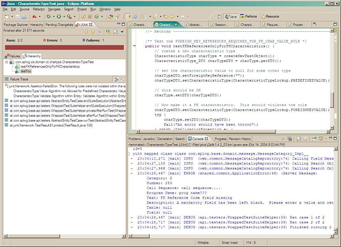

Here's the test that was added to the test class to test it:
			    /** Test foreignKeyReferencesRequiredForFkCharValueRule  */
			    public void testFKReferencesOnlyForFKCharacteristics() {
			        // create a new characteristic type
			        CharacteristicType charType = createNewTestObject();
			        CharacteristicType_DTO charTypeDTO = charType.getDTO();
			        // set the characteristic value to null for some other type
			        charTypeDTO.setForeignKeyReference("");
			        charTypeDTO.setCharacteristicType
			              (CharacteristicTypeLookup.PREDEFINEDVALUE);
			        // this should be OK
			        charType.setDTO(charTypeDTO);
			        // Now make it a FK characteristic.  This should violated the rule
			              (CharacteristicTypeLookup.FOREIGNKEYVALUE);
			        try {
			            fail("An error should have been thrown");
			        } catch (ApplicationException e) {
			            // Make sure the correct rule was violated.
			            VerifyViolatedRule
			               (CharacteristicType_CHandler.
			               foreignKeyReferencesRequiredForFkCharValueRule());
Note: Important note: Both a valid test AND an invalid test were added to the method above.
Finally, when the test is rerun, we have one validation rule less needing to be violated.
Test run in Eclipse Platform
