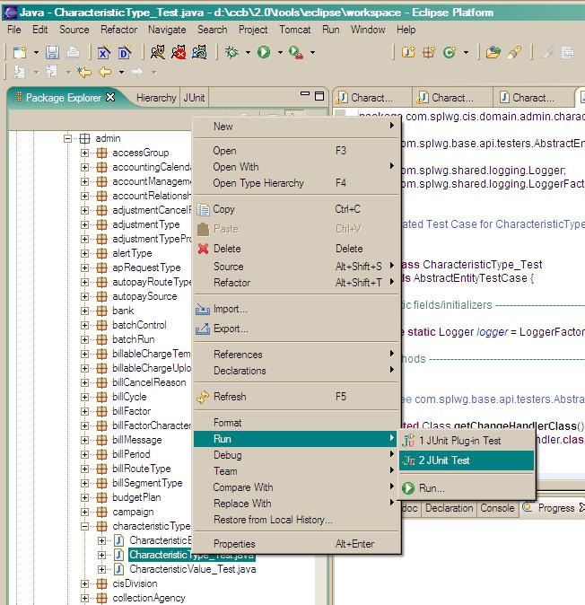

This is a JUnit test case. Let's run it. From within Eclipse, right-click on the test class from within the Package Explorer.

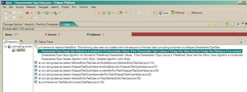

The following image shows the resulting output from JUnit:
As we see, the tests failed and told us that none of our three validation rules where validated. This is, of course true, but some explanation is necessary. When we run entity test cases, the framework looks up the change handler class being tested and collects all its rules. Then it executes all the tests in the test class (basically every method starting with test*). At the end of each test, it looks to see if the last rule violated was one of the rules we are testing. At the end of all the tests, if there are still validation rules that weren't violated, the framework complains. At a minimum, the goal from this point is to create tests that violate each of our rules at least once. Preferably, tests should be created to violate the rules for all additional conditions that we can think of that might compromise the state of the entity.

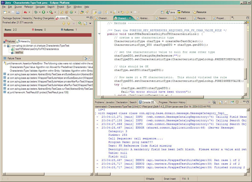

Here's the test that was added to the test class to test it:
/** Test foreignKeyReferencesRequiredForFkCharValueRule */
public void testFKReferencesOnlyForFKCharacteristics() {
// create a new characteristic type
CharacteristicType charType = createNewTestObject();
CharacteristicType_DTO charTypeDTO = charType.getDTO();
// set the characteristic value to null for some other type
charTypeDTO.setForeignKeyReference("");
charTypeDTO.setCharacteristicType
(CharacteristicTypeLookup.PREDEFINEDVALUE);
// this should be OK
charType.setDTO(charTypeDTO);
// Now make it a FK characteristic. This should violated the rule
(CharacteristicTypeLookup.FOREIGNKEYVALUE);
try {
fail("An error should have been thrown");
} catch (ApplicationException e) {
// Make sure the correct rule was violated.
VerifyViolatedRule
(CharacteristicType_CHandler.
foreignKeyReferencesRequiredForFkCharValueRule());
Finally, when the test is rerun, we have one validation rule less needing to be violated.
