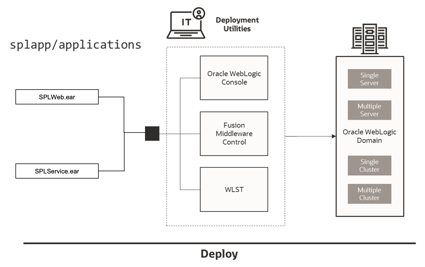

Web Application Server Deployment Process
After the configuration of the Web Application is complete (as outlined in
Web Application Server Configuration Process) the final step to implement the product technically is to deploy the product within the JEE web application server.
There are three methods of deploying the product within the JEE web application server:
1. Use the deployment utilities provided on the console of the JEE web application server. The WAR/EAR files that are available under $SPLEBASE/splapp/applications can be manually deployed using the console. Refer to the Installation Guide for specific platform instructions and the administration guide for the JEE web application server.
Note: This is the only method that can be used if virtual Web application servers are used with the product.
2. Use the deployment utilities provided on the command line of the JEE web application server. The WAR/EAR files that are available under $SPLEBASE/splapp/applications can be manually deployed using the command line utilities supplied with Oracle WebLogic. Refer to the Installation Guide for specific platform instructions and the Oracle WebLogic Administration Guide.
3. Several specific utilities from Oracle WebLogic are provided with the product to deploy the web application to the JEE web application server. These call the same utilities provided in Option 2 but are provided with the product.
Note: This section will outline only option 3.
Several utilities are provided with Oracle WebLogic to deploy the application to the domain. These utilities are summarized below:
• Use the WebLogic console, Fusion Middleware Control or WLST to deploy/redeploy the EAR files.
The Web Application should be available from the Web Application Server.
