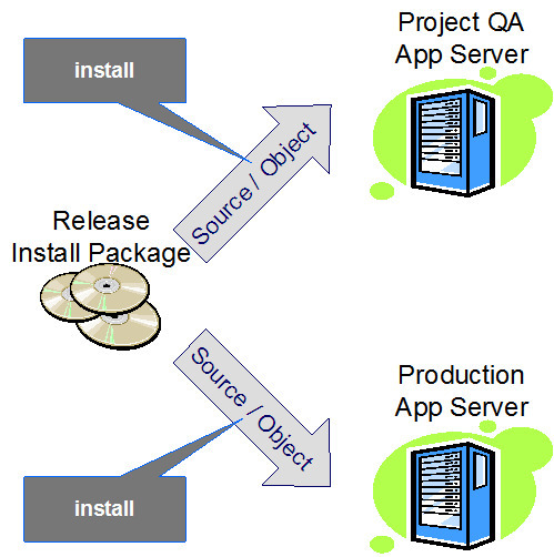

The install tool applies the CM release install files to either QA or production app servers.
