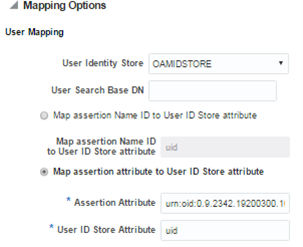

Configure the User Mapping to refer to the following:
Select the appropriate Identity Store that was configured for your Access Management solution. This is used for Single Sign On.
The userid needs to be explicitly identified via the Universal Resource Name (URN) in the SAML metadata from the IdP metadata. For example:
The above attribute must be mapped to the uid attribute in Oracle Access Manager
