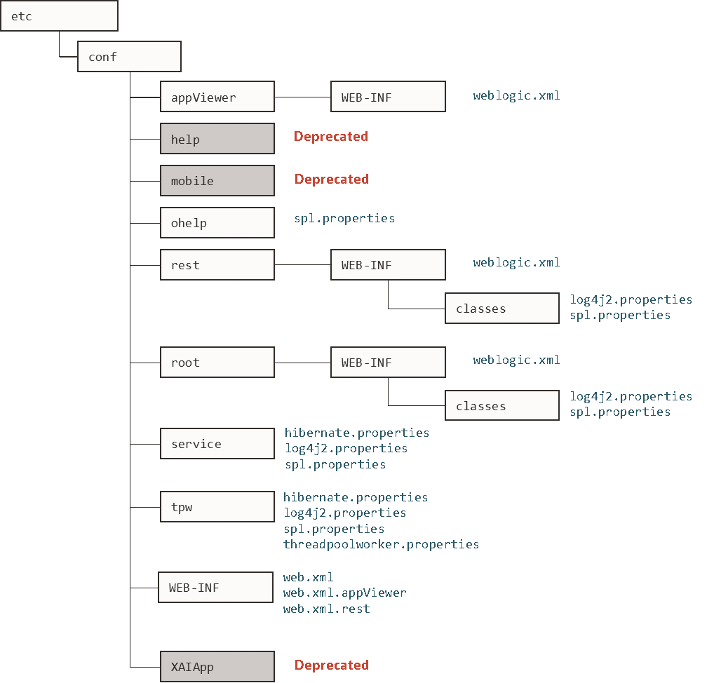

Web Application Server Configuration Files
Within each JEE Web Application within the JEE Web application server has it's own configuration files. These files are typically embedded within the WAR/EAR files deployed with the product following the JEE specification. In terms of configuration, the product structure within the WAR/EAR file looks like the following:Diagram that shows the Configuration File structure.
Web Application Server Configuration Process
To configure the Web application server during the installation process and post-installation then the following process should be used:Diagram that shows the structure of the Web Application Server Configuration Process.
• The configureEnv – Set up Environment Settings utility is used during installation time and can be used post implementation to set parameters in the ENVIRON.INI. If any parameters are derived or set from the ENVIRON.INI (see the Source column in the relevant section) then the configureEnv – Set up Environment Settings utility should be used to maintain them.
Note: The configureEnv – Set up Environment Settings utility should be used to make any changes to the ENVIRON.INI. Manual changes to this configuration file are not recommended.
• After the ENVIRON.INI has been set or altered, the settings must be reflected in the relevant configuration files used by the Web application server by running the initialSetup – Maintain Configuration Settings utility:
• The utility uses the templates from the templates directory to create substituted copies of these files in a standard location. The table below lists the configuration file, the templates used from the templates directory and the final configuration built during the initial configuration process:
Configuration File
Destination
Online Application (root)
Template: web.xml.template
$SPLEBASE/etc/conf/WEB-INF
Template: spl.properties.template
$SPLEBASE/etc/conf/root/WEB-INF/classes
Template: log4j2.properties.template
Template: weblogic.xml.template
REST Server
Template: web.xml.rest.template
Template: spl.properties.rest.template
$SPLEBASE/etc/conf/rest/WEB-INF/classes
Template: log4j2.properties.rest.template
Template: weblogic.xml.rest.template
Application Viewer (appViewer)
Template: web.xml.appViewer.template
Template: weblogic.xml.appViewer.template
$SPLEBASE/etc/conf/appViewer/WEB-INF
Help Application (help)
Template: spl.properties.ohelp.template
$SPLEBASE/etc/conf/ohelp
• At this point you may perform manual changes to the above files to parameters not implemented in the ENVIRON.INI.
Note: Any manual changes are overwritten after running the initialSetup utility unless the change is reflected in the appropriate template (see initialSetup – Maintain Configuration Settings and Implementing Custom Templates for more information). Backups should be made of any changes and then manually reapplied to reinstate all manual changes.
• To reflect configuration changes into Oracle Utilities Meter Data Management web applications the initialSetup utility with the –w option must be executed (see initialSetup – Maintain Configuration Settings). This will build the necessary WAR/EAR files to be deployed into Oracle WebLogic. This step is optional if configuration overrides are in use.
Depending on the architecture, the initialSetup will generate one or more EAR files. Refer to Business Application Server Configuration for a description of the EAR files.
At this point the product web applications are ready for deployment into the JEE Web application server.

To make configuration changes to the Web Application Server component of Oracle Utilities Meter Data Management uses the following Quick Reference Guide to identify which process should be used:
• If the change is to any setting contained in the ENVIRON.INI for the Web Application Server then you must run the following utilities in the order indicated:
1. Execute the configureEnv utility to reflect the parameter change in the ENVIRON.INI. See configureEnv – Set up Environment Settings for details.
2. Execute the initialSetup utility (with the –t option) to rebuild the configuration files using the ENVIRON.INI and provided template files. This will reset the configuration to the contents of the base template files or custom template (if used). See initialSetup – Maintain Configuration Settings for details.
3. Any configuration changes that are overridden by templates (base or custom) must be manually reapplied (if necessary).
4. Execute the initialSetup utility (with the –w option) to implement the configuration files in the product web application server files. This step is not necessary of you are using configuration overrides. See initialSetup – Maintain Configuration Settings for details.
• If the change is to any setting not contained in the ENVIRON.INI for the Web application server but is in the configuration files for the Web Application Server then you must run the following utilities in the order indicated:
1. Make any manual changes to the relevant configuration files.
2. Execute the initialSetup (with the –w option) utility to implement the configuration files in the product web application server files. This step is not necessary of you are using configuration overrides. See initialSetup – Maintain Configuration Settings for details.
• If native installation is used, it is recommended to redeploy or update the generated EAR files from the relevant command or console.
