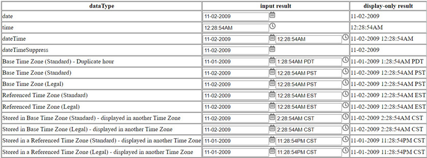

Date and Time Formatting
| Syntax | Valid Values | Description |
| oraType="date" | This function is used to display a date according to the user's display profile. For input fields, the setting formats the data when the user tabs out of the field. | |
| oraType="time" | This function is used to display a time according to the user's display profile. For input fields, the setting formats the data when the user tabs out of the field. | |
| oraType="dateTime; time:suppress" | This function is used to display a timestamp according to the user's display profile. If this function is used for an input element, it is broken into two pieces, one for date and one for time. Optionally, the time portion of the date time element can be suppressed using the attribute value 'time:suppress'. | |
| oraType="dateTime; stdTime:true;" | This function is used to render a date / time element that is
stored in standard time according to the daylight savings time
schedule of the 'base' time zone. The 'base' time zone is specified
on the Installation table and represents the database time zone. For input elements with this setting, all time entered is assumed to correspond with the daylight savings time schedule of the base time zone. If a time is entered that cannot be unambiguously translated to standard time, then the user will be required to provide a time zone label to indicate whether daylight savings time, or standard time, has been entered. | |
| oraType="dateTime; stdTimeRef: ;" | Reference an XPath after the colon. | This function is used to render a date / time element according to the daylight savings time schedule of a time zone whose XPath is referenced. Note that the time processed is assumed to have been stored in the standard time of the referenced time zone - so only daylight savings time shifting will execute - not time zone shifting. |
| oraType="dateTime; legalTime:true;" | This function is used to render a date / time element that is stored in legal time of the 'base' time zone. The 'base' time zone is specified on the Installation table and represents the database time zone. | |
| oraType="dateTime; legalTimeRef: ;" | Reference an XPath after the colon. | This function is used to render a date / time element according to the daylight savings time schedule of a time zone whose XPath is referenced. Note that the time processed is assumed to have been stored in the legal time of the referenced time zone. |
| oraType="dateTime; … ; displayRef: ;" | Reference an XPath after the colon. | This function is used to display a date/time element that is explicitly defined as stored in standard or legal time (using either stdTime | stdRef | legalTime | legalRef) from its storage time zone to the referenced time zone in legal time before display and vice versa, from the display time zone to the storage time zone on save. |
<html>
<body oraSchemaDataTypes="true">
<table border="1" cellpadding="1" cellspacing="1">
   <tr><th>dataType</th><th>input result</th><th> display-only result</th></tr>
   <tr>
      <td>date</td>
      <td><input oraField="schemaDate" oraType="date;"/></td>
      <td><span oraField="schemaDate" oraType="date;"></span></td>
   </tr>
   <tr>
      <td>time</td>
      <td><input oraField="schemaTime" oraType="time;"/></td>
      <td><span oraField="schemaTime" oraType="time;"></span></td>
   </tr>
   <tr>
      <td>dateTime</td>
      <td><input oraField="schemaDateTime" oraType="dateTime;"/></td>
      <td><span oraField="schemaDateTime" oraType="dateTime;"></span></td>
   </tr>
   <tr>
      <td>dateTimeSuppress</td>
      <td><input oraField="schemaDateTimeSup" oraType="dateTime; time:suppress"/></td>
      <td><span oraField="schemaDateTimeSup" oraType="dateTime; time:suppress"></span></td>
   </tr>
   <tr>
     <td>Base Time Zone (Standard)</td>
     <td><input oraField="schemaDateTimeStd" oraType="dateTime; stdTime:true;"/></td>
     <td><span oraField="schemaDateTimeStd" oraType="dateTime; stdTime:true;"></span></td>
   </tr>
   <tr>
     <td>Base Time Zone (Legal)</td>
     <td><input oraField="schemaDateTimeLgl" oraType="dateTime; legalTime:true;"/></td>
     <td><span oraField="schemaDateTimeLgl" oraType="dateTime; legalTime:true;"></span></td>
   </tr>
   <tr>
     <td>Referenced Time Zone (Standard)</td>
     <td><input oraField="schemaDateTimeStdRef" oraType="dateTime; stdTimeRef:timeZone;"/></td>
     <td><span oraField="schemaDateTimeStdRef" oraType="dateTime; stdTimeRef:timeZone;"></span></td>
   </tr>
   <tr>
     <td>Referenced Time Zone (Legal)</td>
     <td><input oraField="schemaDateTimeLglRef" oraType="dateTime; legalTimeRef:timeZone;"/></td>
     <td><span oraField="schemaDateTimeLglRef" oraType="dateTime; legalTimeRef:timeZone;"></span></td>
   </tr>
   <tr>
     <td>Stored in Base Time Zone (Standard) - displayed in another Time Zone</td>
     <td><input oraField="schemaDateTimeStdDisp" oraType="dateTime; stdTime:true; displayRef:timeZoneDisp;"/></td>
     <td><span oraField="schemaDateTimeStdDisp" oraType="dateTime; stdTime:true; displayRef:timeZoneDisp;"></span></td>
   </tr>
   <tr>
     <td>Stored in Base Time Zone (Legal) - displayed in another Time Zone</td>
     <td><input oraField="schemaDateTimeLglDisp" oraType="dateTime; legalTime:true; displayRef:timeZoneDisp"/></td>
     <td><span oraField="schemaDateTimeLglDisp" oraType="dateTime; legalTime:true; displayRef:timeZoneDisp"></span></td>
   </tr>
   <tr>
     <td>Stored in a Referenced Time Zone (Standard) - displayed in another Time Zone</td>
     <td><input oraField="schemaDateTimeStdRefDisp" oraType="dateTime; stdTimeRef:timeZone; displayRef:timeZoneDisp"/></td>
     <td><span oraField="schemaDateTimeStdRefDisp" oraType="dateTime; stdTimeRef:timeZone; displayRef:timeZoneDisp"></span></td>
   </tr>
   <tr>
     <td>Stored in a Referenced Time Zone (Legal) - displayed in another Time Zone</td>
     <td><input oraField="schemaDateTimeLglRefDisp" oraType="dateTime; legalTimeRef:timeZone; displayRef:timeZoneDisp"/></td>
     <td><span oraField="schemaDateTimeLglRefDisp" oraType="dateTime; legalTimeRef:timeZone; displayRef:timeZoneDisp"></span></td>
   </tr>
  </table>
</body>
<xml>
<root>
   <timeZone>US-EASTERN</timeZone>
   <timeZoneDisp>US-CENTRAL</timeZoneDisp>
   <schemaDate>2007-11-02</schemaDate>
   <schemaTime>23.45.00</schemaTime>
   <schemaDateTime>2007-11-02-23.45.00</schemaDateTime>
   <schemaDateTimeSup>2007-11-02-23.45.00</schemaDateTimeSup>
   <schemaDateTimeStd>2007-11-02-23.45.00</schemaDateTimeStd>
   <schemaDateTimeStdRef>2007-11-02-23.45.00</schemaDateTimeStdRef>
   <schemaDateTimeLgl>2007-11-02-23.45.00</schemaDateTimeLgl>
   <schemaDateTimeLglRef>2007-11-02-23.45.00</schemaDateTimeLglRef>
   <schemaDateTimeStdDisp>2007-11-02-23.45.00</schemaDateTimeStdDisp>
   <schemaDateTimeStdRefDisp>2007-11-02-23.45.00</schemaDateTimeStdRefDisp>
   <schemaDateTimeLglDisp>2007-11-02-23.45.00</schemaDateTimeLglDisp>
   <schemaDateTimeLglRefDisp>2007-11-02-23.45.00</schemaDateTimeLglRefDisp>
</root>
</xml>
</html>HTML rendered.
