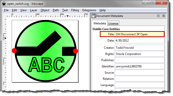

The SVG [title] element is used for hover text when the symbol is visualized in the Viewer.
In InkScape, the title is specified in the Document Metadata panel’s Title field:

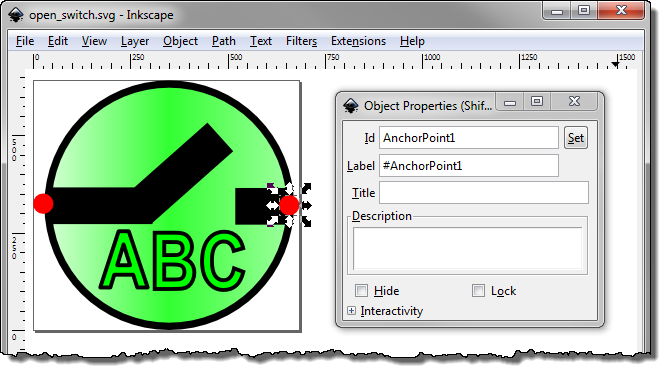

To specify Anchor Points in the .svg file, place a graphic object and use the Id attribute in the Object Properties. Give the anchor points an id value of AnchorPoint1 or AnchorPoint2:
Anchor points can be optionally hidden when drawn in the Viewer by using the Object Fill and Stroke panel and setting the Fill and Stroke Paint Opacity levels to zero. Do not set the Object Properties Hide check box since this will hide the anchor points from the Viewer, which will not know that the anchor points exist.

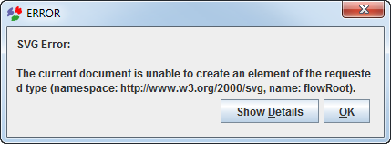

Adding Text to SVG Symbols with Inkscape
Natively, Inkscape’s text tool adds a non-standard SVG element that is not supported by the Viewer (or any standard SVG viewer). Therefore, when using Inkscape to create SVG symbols with text, you must convert the text with Inkscapes text conversion option.
The following example demonstrates the process of adding text, converting the text to a standard SVG element, and validating the file using the Apache Batik SVG Toolkit’s Squiggle viewer.
Note: The Apache Batik SVG Toolkit is available from the Apache Software Foundation.
Example: Convert Inkscape text to a standard SVG element and validate with Squiggle.
1. Open Inkscape and create a symbol.
2. Add text to the symbol using the Text tool.
3. Resize and position the text, as needed.
Note: With the non-standard text present, if you save and attempt to open the file with Squiggle, you will receive an error:
4. With the text selected, select Convert to Text from the Text menu.
5. Save the file.

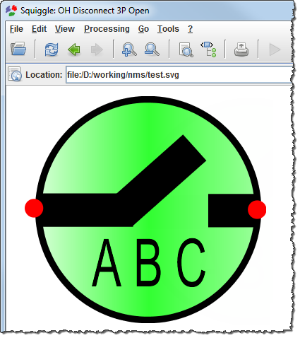

6. Open the file in Squiggle to validate the SVG is a well-formed XML document.

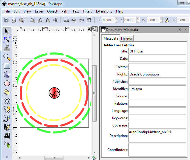

The master symbol .svg file requires the object IDs set as specified by the svg‑symbol‑generator -help information and an additional text string in the master .svg metadata description attribute with the following format:
AutoConfig:[classNumber]:[className]:[tensDigit][:[normalOpenTensDigit]]
These values are passed to the respective svg‑symbol‑generator command parameters (see “svg‑symbol‑generator Script”).
If the <normallyOpenTensDigit> is specified, autoSvgGenerator executes svg‑symbol‑generator a second time using the [normalOpenTensDigit] value rather than the -tens parameter and, optionally, the ‑normalopen parameter. This will use the inclusion of the symbols object with ObjectID = normal_open_indicator and mixed_status_indicator.
If the -normalopen parameter is not specified on the svg‑symbol‑generator, the ObjectID = normal_open_indicator and mixed_status_indicator will not be included in the resulting symbols.
For example, an overhead fuse (class name: fuse_oh/class number: 148) with a normally open tens digit of 5, would be defined as:
<dc:description>AutoConfig:148:fuse_oh:0:5</dc:description>
