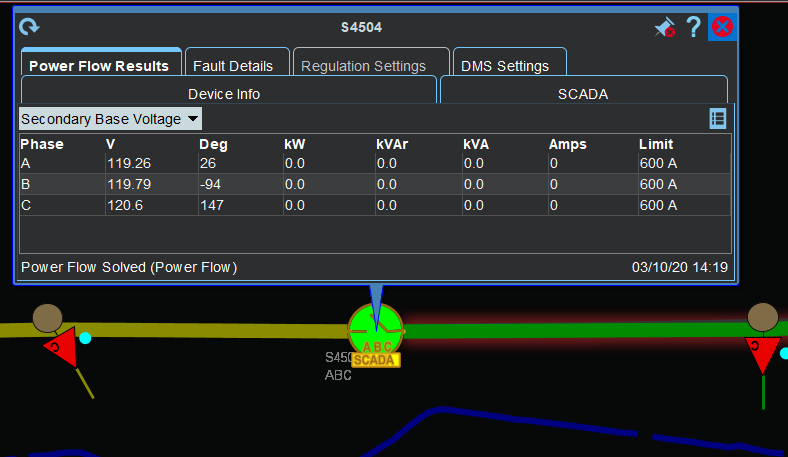

.Screen capture of SCADA device with balloon details showing the Power Flow results tab.

Understanding the Device Details Power Flow Results Data Table
The Device Details Power Flow Results tab displays power flow solutions in a tabular format. The date and time the last power flow solution was conducted for the selected device appears in the bottom right corner of the balloon dialog box.

• Table Columns
• The Phase column displays the device phase.
• The Deg column displays the voltage phase shift (angle) in degrees.
• The kV column contains calculated voltage in the units selected in the Voltage Display Type. There are multiple options available for Voltage Display Type. If you have selected a multi-phase device, options for Line Voltage, Phase Voltage, Voltage Percent, and Secondary Voltage will be available. On multi-phase devices, the Secondary Voltage and Voltage Percent will show voltage magnitude and phase angle in line to line representation. When values are represented in line to line representation both voltage magnitude and angle values will have the phases involved appended to it. If you have selected a single phase device, the Voltage Display Type for Line Voltage will be removed since a second phase does not exist to do a proper line to line voltage calculation. If you have selected a two phase Delta load, a single row showing both phases involved will be displayed.
Note: If a feeder is configured for kVA solutions, the voltage on the feeder will be constant and not reflect the true drop/rise occurring in the field.
• The kW column contains the calculated voltage in the units selected above.
• The kVAr column contains the phase reactive power flow.
• The Amps column contains the phase current.
• The Limit column contains the phase limit in either Amps, kVAr, or kVA depending on the device type:
